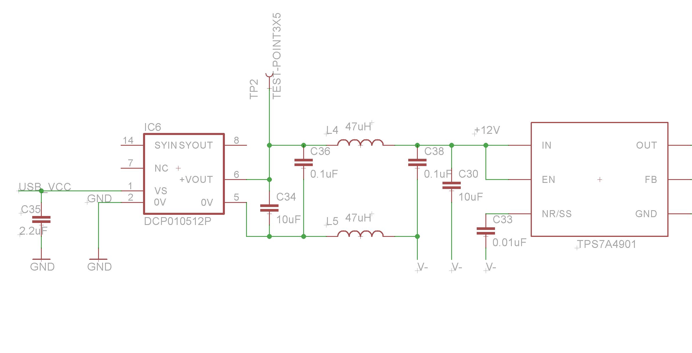

Hi John,
Do you have any experience with passive filter design?
I am planning on using TI's DCP010512BP isolated DC-DC converter to enable use of USB power (5V -> 12V) but would like to design a filter of some sort to cut down on voltage rail noise as this is a switching regulator. Granted it will be regulated with an LDO down to 10V to give a nice +-5V rail before it makes its way to the OPA1622, but a CLC filter or something similar in between would be nice.
The switcher has a switching frequency of 800khz, thus leading me to want to design an LC filter with a resonance frequency of around 80khz to keep the resonant point well out of the expected noise. Maybe a 47uH inductor with 0.1uF caps? As far as the proper impedance of the filter, I have no idea... 50 ohms?
Here's what I've got right now:
attachment.php
Not really my area of expertise, and I would echo the recommendation to post questions onto the relevant forum on e2e.ti.com. However, I will point out that without any kind of lossy element in the CLC filter, it's going to ring like a bell with any perturbation (load step). A resistor in series with the 47uH inductor will kill the Q (50 ohms would work) and still leave enough headroom for the linear regulator.

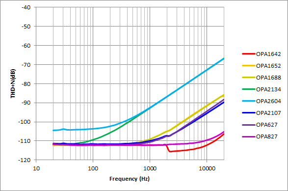

The OPA1688 also has a much more stable input impedance than older JFET input parts, which reduces its distortion in non-inverting configurations with high source impedance. Attached is a comparison of JFET/CMOS op amps configured in a gain of +1, 10kOhm source impedance, and a 5Vrms input signal. Variations in the amplifier input impedance produce the additional distortion. Unfortunately, I haven't tested the LME49880 yet, but OPA1652 and OPA1688 are about on par with the older DiFET parts from Burr-Brown (OPA627, OPA2107). And the newer JFET parts from TI (OPA827, OPA1642) show the best performance. The dip in the THD+N curve for the OPA1642 is a range-switching effect on the Audio Precision and not the actual behavior of the op amp.

The OPA1688 does great with 600R loads...
Thanks for the information! Yeah the LME49880's Iq is "not battery friendly". 🙂 In fact the (15V * 2) * 0.014mA = 420mW power dissipation just from the quiescent may be a big part of why they had to add the power pad in the first place.
My interest in driving 600R isn't even the headphones, but the pot and Rf. One project I have on the forum here uses a pot-in-the-middle design with a 1K pot and 1.5K feedback resistor for low(er) Johnson noise. 1.5K||1K = 600R. Part of the reason I did that was to take full advantage of that 600R drive capability of some of the LME parts. Good that you guys have some new OPA parts that can take the place.
Your graph made my day. 🙂 Another project I have here uses an OPA827 looped with a LME49600, +1 unity gain, non-inverting, 2.5K (maximum) effective source resistance, and 5Vrms = 7Vpeak on batteries. The buffer will add distortion, but still that curve for the OPA827 rocks. The buffer chip is to (also) allow driving low-sensitivity 16R headphone loads, something that would probably make the 1622 run away and hide. 😛 Your OPA1622 will be a great chip for driving modern high sensitivity cans/IEMs from portable gear. Which chip on the graph would you guess the OPA140/2140/4140 would be most similar to?
The OPA140/2140/and 4140 will perform identically to the OPA1641/42/44 in the graph I showed.
