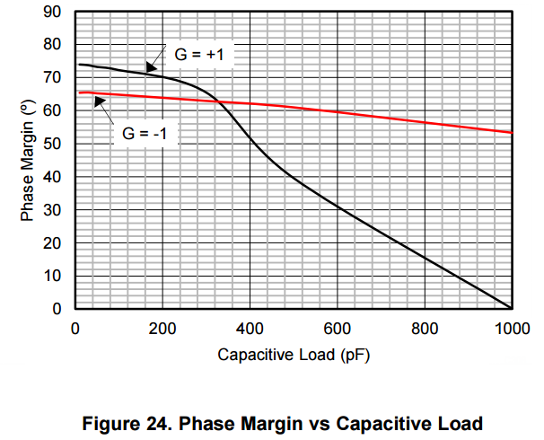

Hey I have one more OPA1622 question about wiring two or more 1622's up in parallel for more current output, similar to what NwAvGuy did with his O2 headamp. He used 1R balancing resistors on the outputs of the two parallel op-amps (0.5R total Z looking back into the amp). I know the DC balancing currents flowing between the chips can/will affect the class AB bias in the output stage to some degree. Is there a recommendation on an output balancing resistor value for 2 (or 4) OPA1622's in parallel that would cause minimal problems with the chips? If I could parallel two OPA1622s to double the output currrent and spread the chip dissipation I think the chip would start getting interesting to me. Thank you!

I agree a series output resistor wrecks the damping factor and often introduces additional distortion due to the non-linear current drawn by the headphones. I wrote an article on an alternate compensation method for headphone amplifiers in diff amp configurations to avoid this: http://www.ti.com/lit/an/slyt630/slyt630.pdf
For this exact reason, we designed the OPA1622 to be very stable into capacitive loads without a series resistor. This is shown in Figure 24 in the datasheet, which plots phase margin vs. capacitive load for G = +1 and -1 configurations (reposted here for convenience). In a gain of -1 the OPA1622 has 54 degrees of phase margin with a 1nF capacitive load and no series isolation resistor.
I'm not a big fan of overshoot vs cap load graphs. They make a lot of assumptions about the op amp's compensation in order to correlate overshoot to stability. I would rather cut to the chase and see the phase margin of the system to know if it's stable.
Series balancing resistors are really limited by the amount of DC circulating current between the outputs that is acceptable. The maximum input offset of this part is +/-500uV. So if we had two parts in gains of +1, the maximum output offset that is theoretically possible would be 500uV x 2 = 1mV (500uV is a 6 sigma number btw, so the odds of getting two at the max in opposite directions is like winning the lotto). If you had 1mV offset divided by 2 ohms of balancing resistance that's 500uA of DC circulating current. Probably no big deal.
I haven't played with putting OPA1622's in parallel yet to see how far I can push those balance resistors down.

Thanks for the quick reply!
You saw my post before I edited out the capacitive load stuff. :) I had that written up, then went back through the datasheet and saw the ">600pF drive" at the top and deleted that section. For folks that didn't see the before-edit on my post, I was asking about Cload capability. I hadn't seen the usual section on the OPA1622 datasheet about driving capacitive loads and (usually) adding series output resistor for isolation. Which is of course an audio problem because the resistor messes with the damping factor. I usually add 1 to 2.2nF these days on my output test loads to simulate cable and driver capacitance. I also hadn't found the typical graphs of step resposnse peaking for various output Cloads.
Your article looks very interesting! I will give that a read tonight. I was impressed to find that Cload was mentioned right at the top of the sheet and that the typical application circuits shown didn't include any output series resistor. You guys clearly understood the market requirements for the chip.
Ah so the Cload is on a phase margin graph. That is a clever way to do it! And useful. So margin hits the magic 30 degrees left at 600pF, but this is with non-inverting. One of the headamp projects I have posted on the forum here is inverting in both stages, the gain and the (-unity) buffer stage. With the OPA1622 in an inverting buffer config it is good to go way on out there, past my 1nF typical load. Sweet! :)
Thanks for the balance resistor guidance! In one amp project here I have 6 NJM4556A sections (3 dual op-amps) in parallel. While designing it I tested a pile of 40 of the things and found, interestingly enough, that not only were the offsets well grouped in the 2.5 - 3.5mV range, they were all positive! Every one. With that information I wasn't too concerned about balancing so many. Like you say, the odds of getting a -3.5mV after that large of a sample size would be like winning the lotto. :) Hmmm.... I may whip up a board for fun with some parallel OPA1622s. :)
Thank you again for the help and information!

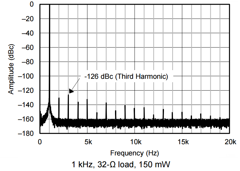

I understand that the THD is very low, but does the large number of harmonics in the graph concern you (I could see up to the 19th)? Is that crossover distortion? Would an amp with somewhat higher distortion but far fewer harmonics sound any better?

Huh they are at around or better than 140dB below the fundamental... the noise from the source would probably dominate.
Consider the scale and noise floor of the FFT though. Most of those harmonics are under -140 dBc! If I had done the standard 32768 pt FFT on a SYS-2722, we'd probably only see up to the 5th harmonic. We tend to assume that if harmonics are below the noise floor of the FFT, then they don't exist. But I can make the noise floor of an FFT whatever I want, just by changing the bandwidth, number of points/bins, and averaging. Fourier series are infinite summations, so although an amplifier's 2nd or 3rd harmonic may dominate, there are still likely higher ordered harmonics present.
As for the exact source of the harmonics, there's always multiple sources. The design of the output stage of the OPA1622 really minimizes crossover distortion, but being a class-AB output stage it's never completely eliminated. Also, the beta of the output transistors is dependent upon current density (IC) and VCE, so their transfer functions are constant changing with output current and output voltage. We actually plotted the gain of the output stage vs. output voltage of the OPA1622 in this blog post: Amp up your cans: Distortion in headphone amplifiers (part 4) - Precision Hub - Blogs - TI E2E Community
