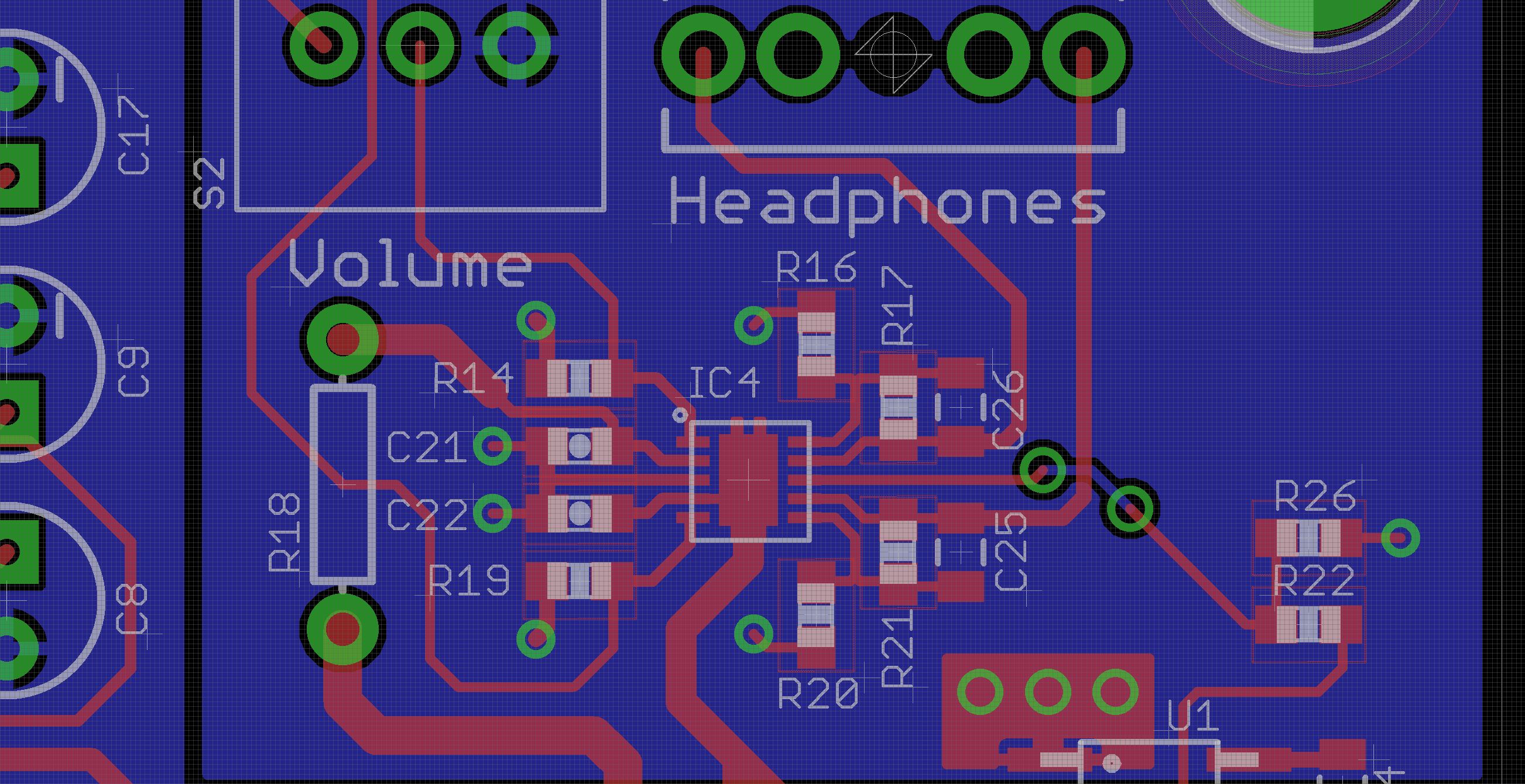

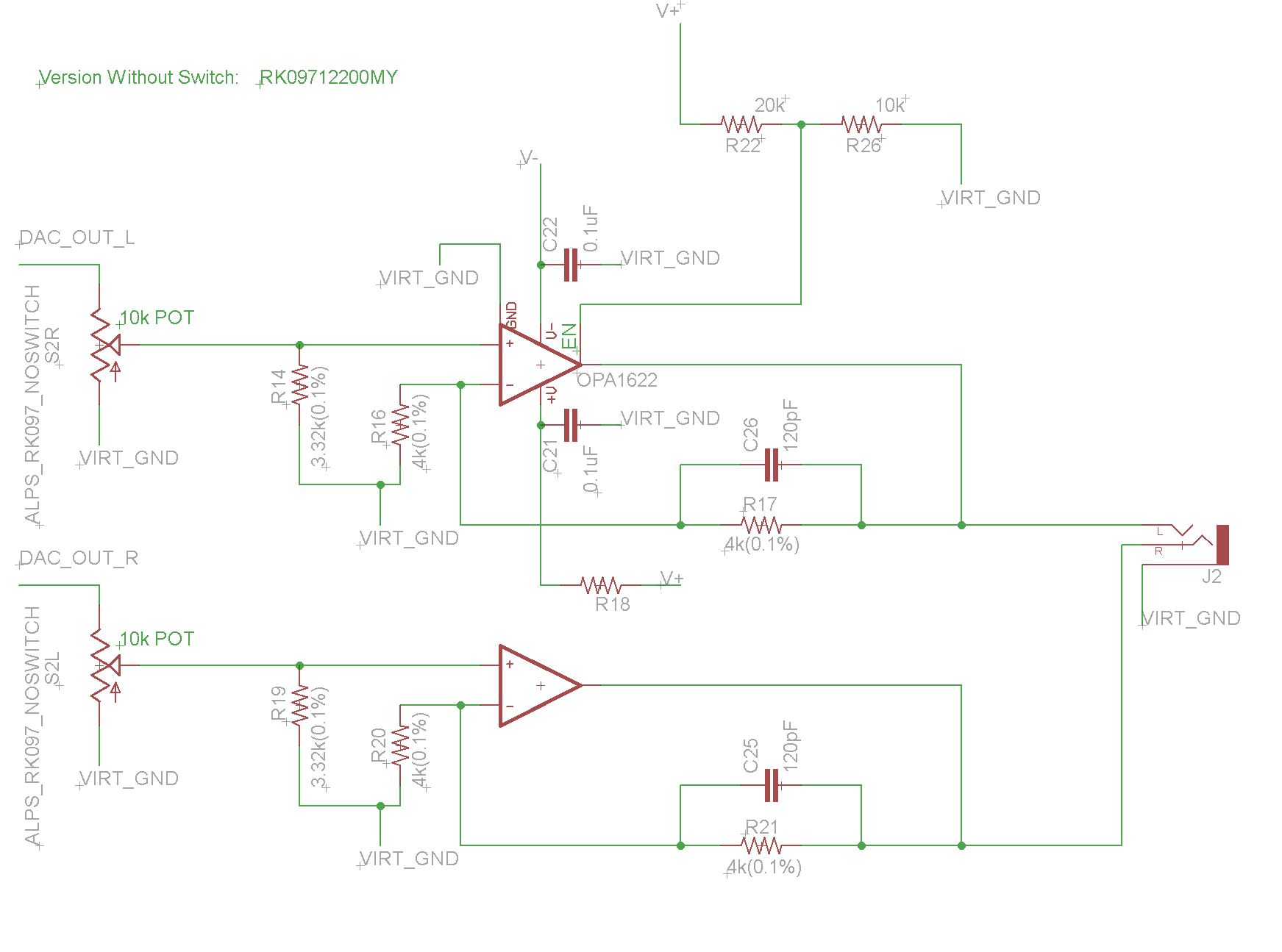

Awesome op amp! I too have implemented a rough amp design with this guy and it sounds amazing!
Just about to send out a next revision, John - could I get some feedback and your thoughts on this schematic/layout? In your opinion do I need a separate input and gain stage here or is it OK to use the OPA1622 as both gain (gain of +2 in this case) and output stage? Currently I've got +-5V power supply rails, and it is being fed by a PCM5102A DAC (2.1VRMS output) with a 10k pot in between the DAC and the OPA1622.
Thanks,
Connor
Thanks,
Connor
Thanks,
Connor
It's really up to you, from a distortion and stability standpoint gain of 2 is fine for the OPA1622. And bonus points for matching source impedances at the op amp inputs when the potentiometer wiper is at 50%! However, you are making a bit of a sacrifice in terms of total system noise. The large value resistors will contribute some thermal noise to the system, although the DAC noise may dominate here. And at different pot settings (not 50%) your DC offset at the output will vary. You might want to consider AC coupling between your pot and the 3.32k resistor.
Personally, I would put an OPA1642 (or OPA2140 for lower offsets: less click/pop) after the volume control because it doesn't exhibit common-mode distortion effects with high source impedances and configure it in a gain of two and then use the OPA1622 in a gain of 1 for the output. The OPA1688 and OPA1652 are also alternatives to the OPA1642. But that does mean adding another op amp, and I understand the less is more approach 🙂
5th Element: I'm so glad you got it figured out! Your issue had been on my mind the last few days wondering if there was something in your application that I had missed! I hope it gives you lots of enjoyable listening time now!
Thanks for the quick response John. I was planning on going with a pair of 1k resistors to get the needed gain of +2 with a lower thermal noise, but I was worried about the load this would put on the PCM5102A with the bias resistor being lower than 1k (around 550 ohm pulldown on the non inverting input as 550||5000 gets pretty close to canceling out the DC offset effects of the 1k gain resistors). Trying to avoid having to AC couple the inputs, I like not having to stick expensive capacitors in the signal path 🙂 Do you think a 550ohm pulldown would be a bit too stiff for the DAC to drive? Couldn't find any current output specs for the PCM5102A DAC...
They specify a minimum load impedance of 1kOhm in the PCM5102 datasheet, so best to keep it above that.

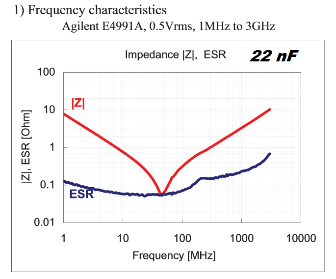

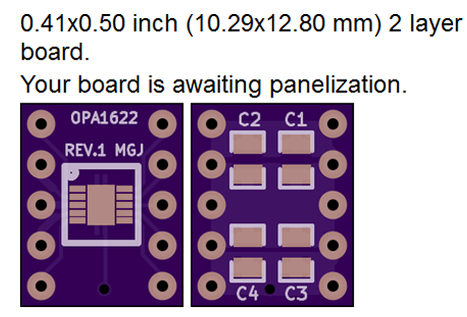

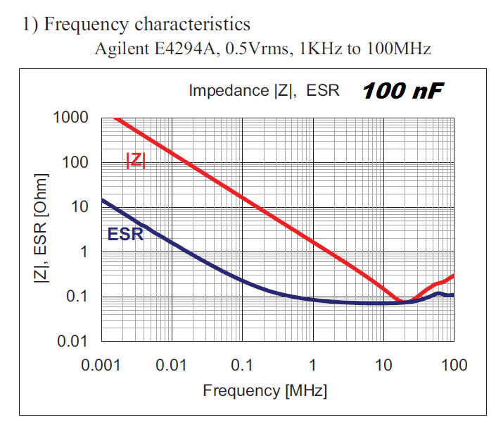

I sent off my rev.1 PCB design to OSH Park today. It's intended to be hand assembled, and applies a rude and unholy strategy of maximum complexity: SMD parts on both top side and bottom side, plus through hole attachment of the I/O pins.
Same pinout ordering as the SMD OP1622 except expanded to a 10 pin, 300 mil, Dual Inline Package. It mates with a standard 10 pin DIP socket like this one.
On the little daughter card, each supply has two 0805, X7R, 100V bypass capacitor: 100nF and 22nF. Impedance plots attached below. Why 100V? Because its dC/dV is lower.
I have no idea how many revisions will be required to get it working and make the soldering task easier. One revision? Doubtful.

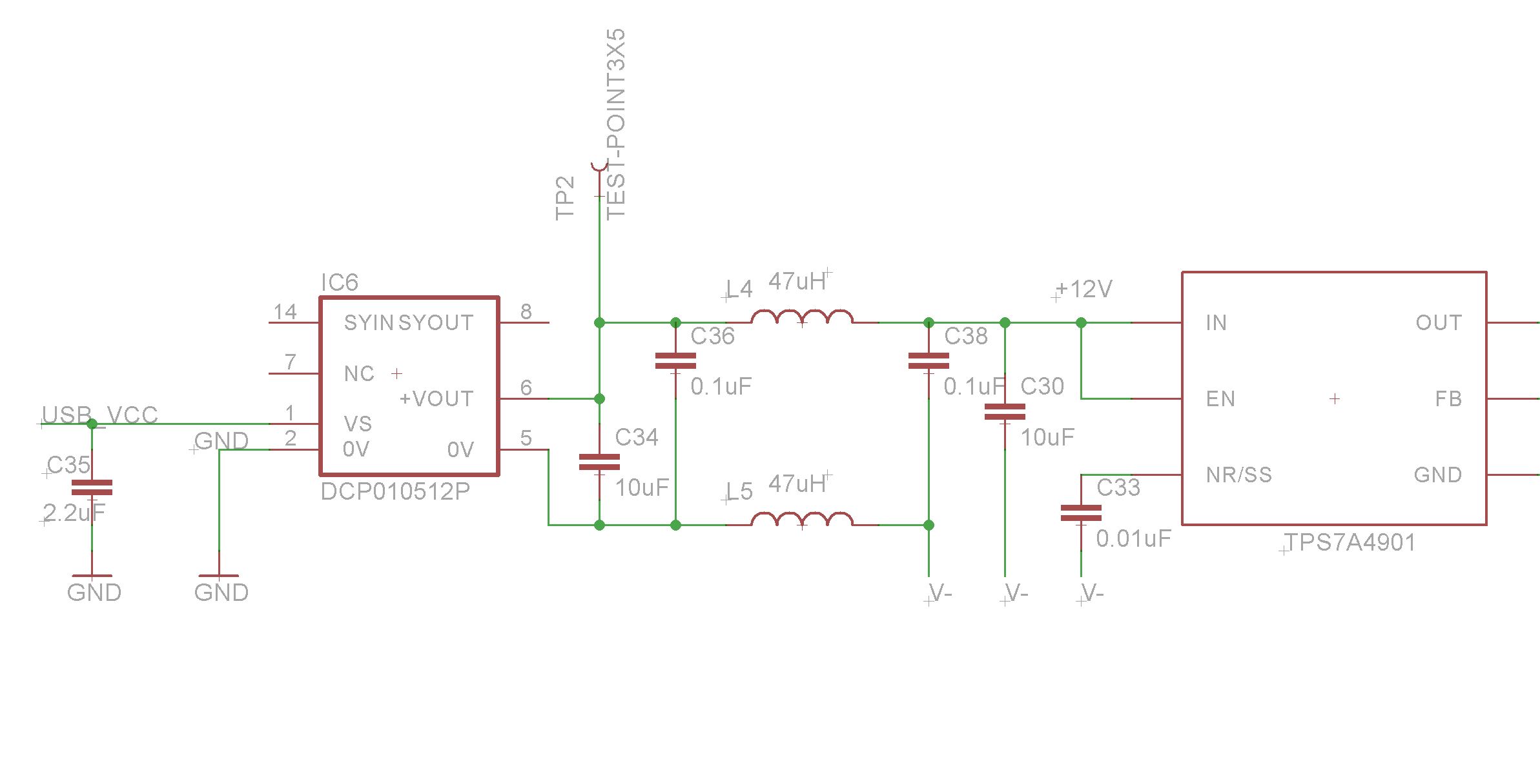

Hi John,
Do you have any experience with passive filter design?
I am planning on using TI's DCP010512BP isolated DC-DC converter to enable use of USB power (5V -> 12V) but would like to design a filter of some sort to cut down on voltage rail noise as this is a switching regulator. Granted it will be regulated with an LDO down to 10V to give a nice +-5V rail before it makes its way to the OPA1622, but a CLC filter or something similar in between would be nice.
The switcher has a switching frequency of 800khz, thus leading me to want to design an LC filter with a resonance frequency of around 80khz to keep the resonant point well out of the expected noise. Maybe a 47uH inductor with 0.1uF caps? As far as the proper impedance of the filter, I have no idea... 50 ohms?
Here's what I've got right now:
