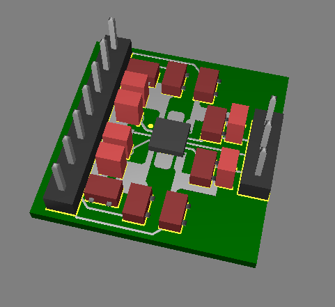

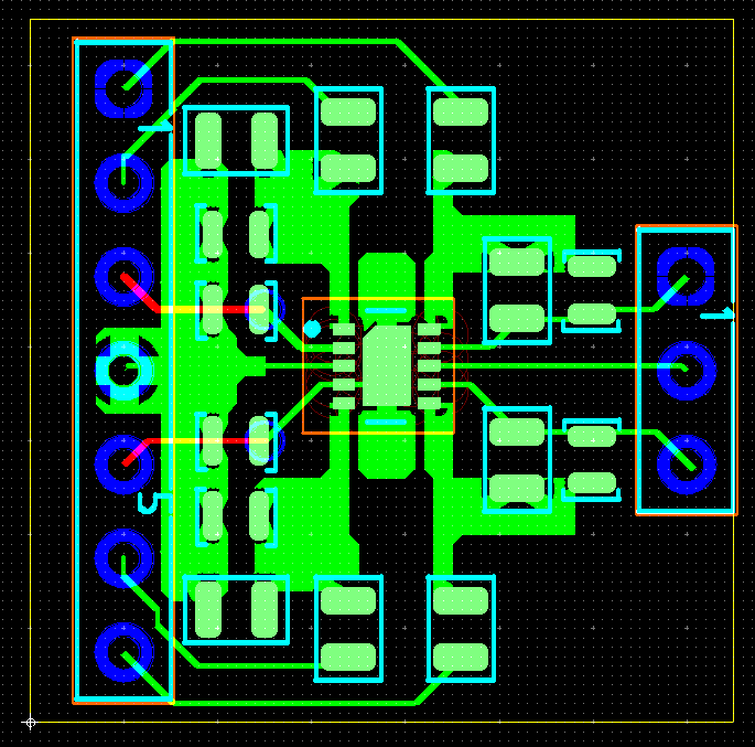

I think it makes sense to build an SMD adapter with SMD components. I cribbed the TI design from figure 60 in the data sheet into this which measures 0.750x0.750 inch:
jackinnj - looks good!
I was studying that datasheet layout example a few days ago and was wondering how V+ and V- would get to those two interior (inside the ground pour) pins. Are those vias under the two SMD pads to change layers and bring the power rails out? I haven't seen a via used as a SMD pad before. I was thinking that one way to get those power rail traces out was do a right angle and run them under the SMD resistor and capacitor, then out between ground and the V-/V+ traces.
You could do a via-in-pad or a via under the body of the resistor to bring the supplies in. Just make sure the supply line runs to the capacitor pad first before going to the chip to maximize the effectiveness of the cap. You could also run the lines under the resistor bodies but that will definitely limit trace width depending on the size of SMD components you're using.
Jackinnj - That looks really good! And will be very useful to a lot of people here. Because your components are larger than the 0402s I used in the layout example in the datasheet, it might make sense to re-arrange the components in the feedback path and the resistor connected to the negative input to try to reduce the area of copper at that op amp input. Keeping parasitic capacitance at the inverting input of an op amp low is always a good goal in op amp layout.
Really excited to see how this turns out!
