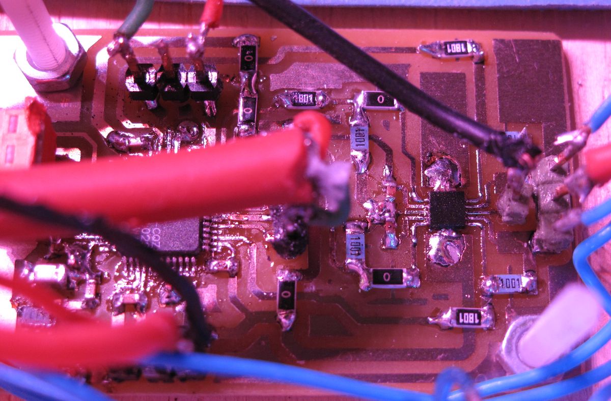

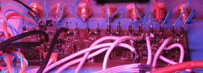

Attached are a couple of pics of my implementations.
One is the headphone board and the other is the 16 channel output board of which 12 channels are used. As it stands I didn't have the thermal pad connected to the reverse side of the PCB for power dissipation, but have 'wings' coming out of each side of the chip that enhances conduction away from the device. Of course the pad is connected to the -ve rail.
