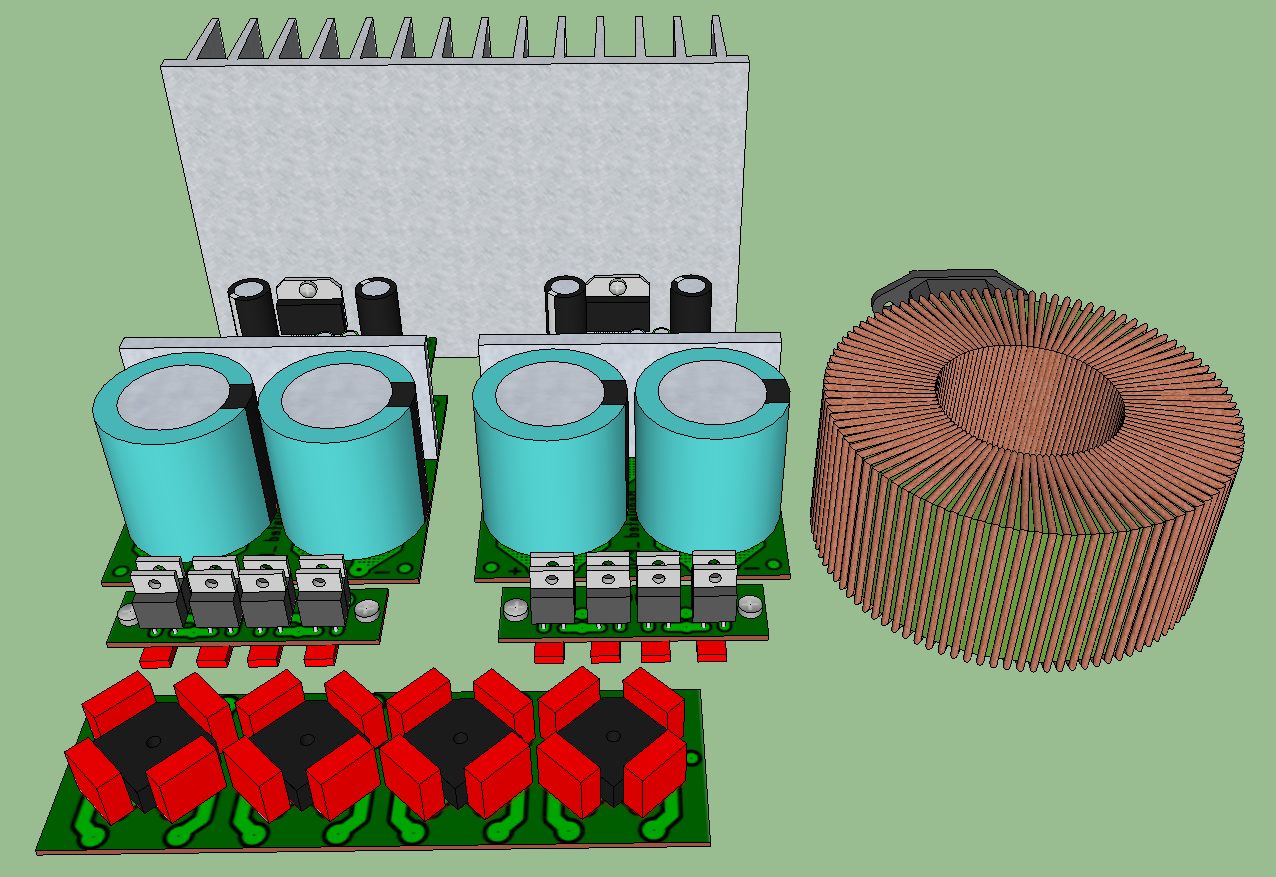

Hello there
Kuldeepsingh - I'm more likely to release all the artwork, parts list etc into the public domain for all to have a go at should 'they' find it of interest. As far as I can see there are far more interesting projects on this site.
The 3D images are done in Google Sketchup, free addition, at 1:1 scale.

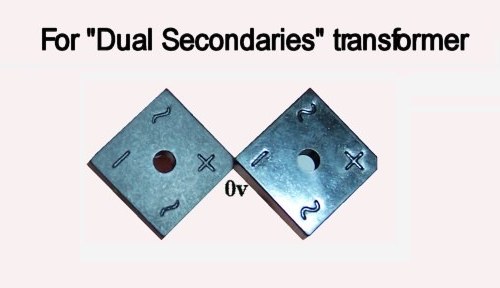

Oh no. Use the square.Diodes - 8A 50V Bridge rectifiers in a SIL package instead. Standard type 4 for £0.98p

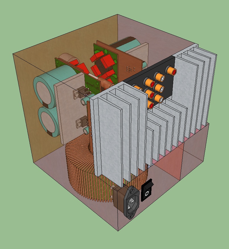

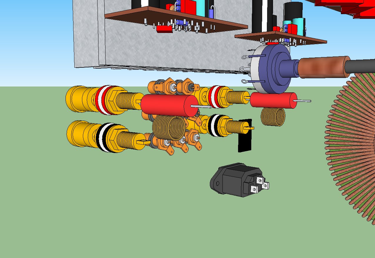

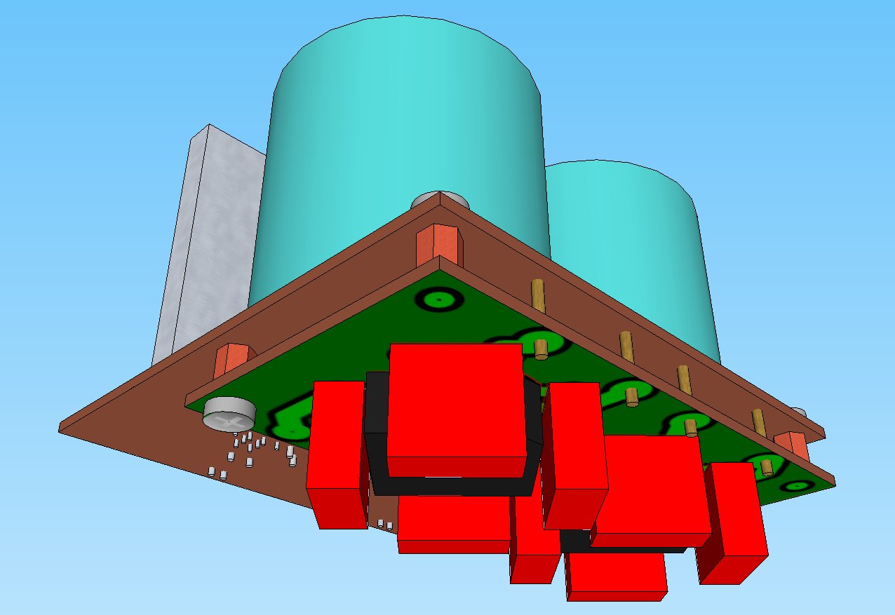

Hi All
Just waiting on monies hitting my bank account, tomorrow hopefully, and then I can order the first group of parts.
I've been playing around with an idea for a lay out and enclosure.
A cube 165.5mm on a side. The 100mm X 165.5mm X 35mm Heat sink recessed into the back, but open, to maintain the 'cubeness'.
To save space the rectifiers will be mounted back to back with their regulator partner circuit. I'm going to adjust the rectifier boards slightly so that the Power out to power in points, of the regulator, line up when the pairs are fitted together which will allow a very short piece of wire to link between them. Care will be taken with spacing and fixing to avoid short circuits.
The current image also shows the addition of a selector switch and extrra RCA sockets in the back. I aim to fit 3 inputs. This bit will follow once the initial modules are built, tested and no magic smoke escapes 😱
Other than the circuit build the above is still a WIP. The first 'enclosure' is likely to be a slab of MDF used to bolt everything down to for trials and testing.

Hi All
A slight problem has arisen! The 10ohm 5W resistor - I've just noticed that the ones I was going to get are in fact wire wound. I have seen, on the forum, the use of wire wound resistors to be ******** as they will behave like an inductor coil.
As this is the resistor that is, in some cases but not all, the one that has an air formed coil slipped over it, as per the circuit I'm using I guess this could throw things adrift.
Ebay has loads but all in Hong Kong 😡
But there is a suppler in the UK -
Ye Shoppe Online
But! The nearest value is either 9R1 or 11R going lower in value is probably not a good idea so would the 11R be OK?
These are the only non wire wound resistors I have found so far.

Hello Andrew HNY!
Could you expand on this please? The instructions that were with the original Schematic said to fit the one in the other. Or is this a way round having to use a wire wound resistor?
Following your guidance would I just solder the coil and the resistor, in parallel, but side by side rather than one within the other?
I am also adding a multi turn trim pot to each side of each regulator board to allow fine tuning of the voltage levels.

The field inside the coil can affect the way the resistor passes signal.
The field around (outside) the coil can affect nearby circuits and be affected by nearby metal work.
For these reasons I locate the L//R off PCB in the cable route to the speaker terminals.
Yes to wirewound if building a custom speaker to help level the response of your amplifier. Otherwise the answer is no wirewound.can I use a wire wound resistor without worry then?

Hello There
Thanks Gentlemen!

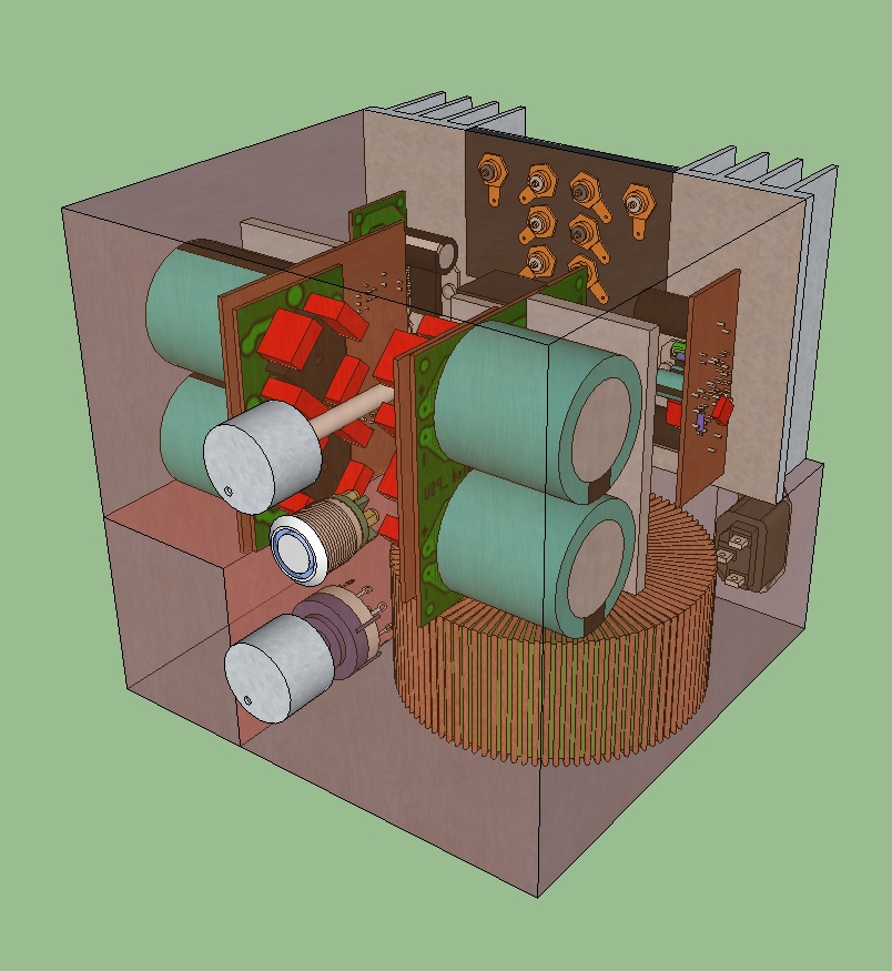

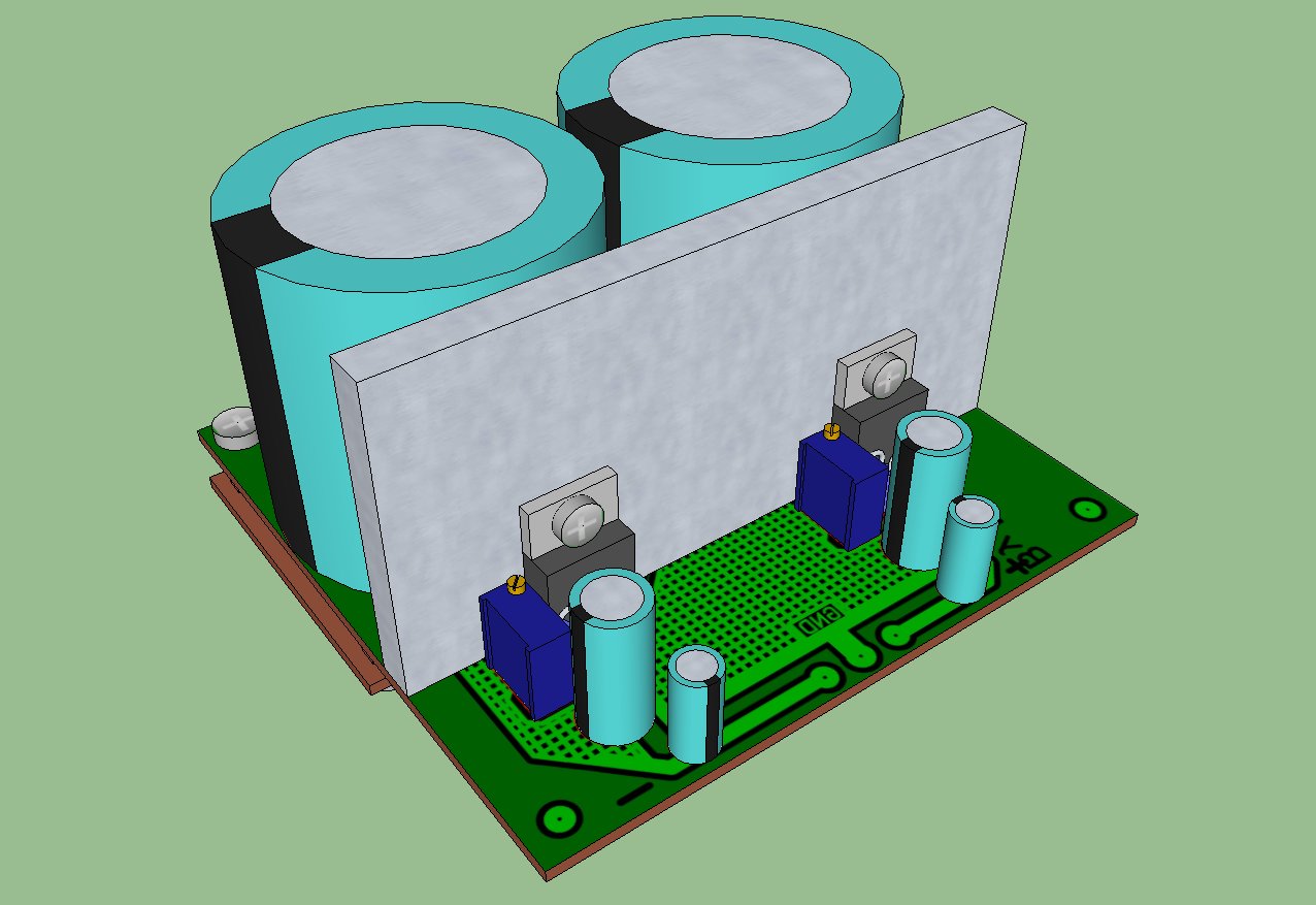

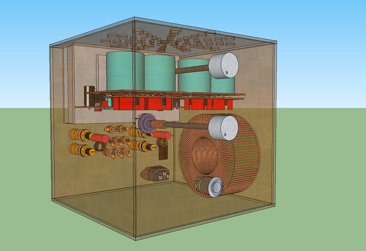

Here are a few mock ups with the trim pots added to the PSU and the L//R shown directly fitted to the Audio out post.
The 'possible' enclosure is now 200mm on a side. This small change has increased the available space for 'future' additions.

Will it be possible to reach the trim posts, via the ventilation holes, with the chassis fully assembled?
A couple of plastic guide tubes/cones will avoid accidents.
Hi Andrew
The holes don't line up well enough, if at all, and I certainly see your point.
Construction wise I am thinking of the top being a removable panel to allow access. Perhaps take this further and set it up so the structure is made up as a pair of U shaped sections rotated 90 degrees to each other so they they interlock.
This would be simple and allow access all round as well for 'maintenance' and 'extras'.
The front, back and base will be aluminium. The sides and top a stained wood. Possibly.
One extra circuit I will add will be a time delay tied to the mute control of both channels to keep the speakers muted during the 'power up' cycle. My Late mothers JVC system had a 5 second delay, I had to replace one of the relays for her, so I will take that as a start point.
I can either use a 555 based circuit. Or go for a simpler transistor/capacitor based delay. I will have to see if a differing voltage will be needed of course.
