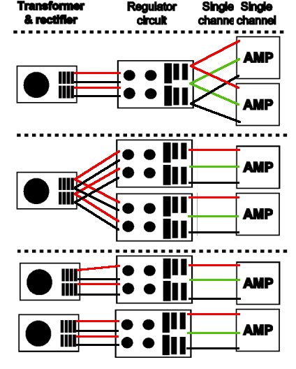

Hello Andrew.
Yes. I am going to use a regulated PSU. One per amplifier. This decision was driven by the compactness of the regulated modules which will fit inside my case, without issue, unlike the unregulated version. A secondary bonus to this is the free space left in the enclosure which may be useful for a input selector and or conditioner circuit (in the future perhaps)
As for the voltage. I'm following guides at this point but I am aware that the LM3876 has a much larger voltage capability.
So I have checked out the options on rapideonline. A 160VA - 2 X 55V@1.45A per secondary is the next Voltage up in the current price range.
I can get 2 of the above for £43
Or I go for a single transformer feeding the pair of PSU modules an example being -
500VA - 2 X 50V@5A per secondary for £39.67
My thoughts on the single are cost/efficiency. With it's higher Amperage on the output it shouldn't struggle driving both PSU/Amplifiers either. Please correct me if I'm talking rubbish 😀
That said there is a 55V in the same price bracket. Other than upping the capacitor specs to suit. 100V for worst case I think.
Both the above, with the secondary coils in parallel there will be 9 - 10A available.
Any guidance on this aspect will of course be gratefully received.
Would the single transformer effect how the safety earth is done or is the dual system still applicable?

The Safety Earth is the connection from the PE (third wire in the mains cable) to chassis.
It has nothing to do with transformer.
All exposed conductive parts must be connected to Safety Earth..
That requires things like terminals with an exposed metal part or a metal adjusting knob to be earthed to the chassis.

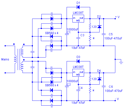

Hi Daniel
That is the circuit I am working to 😀
As for the voltage drop - As little as possible. Rather than strangle the available voltage down to a 'given level' I want to use as much as is available whilst having a nice stable output.
So with the following-
25V output > 38V output after rectification. Regulate this to 25V
30V output > 45V output after rectification. Regulate this to 42V
35V output > 53V output after rectification. Regulate this to 50V
All the above have the 3V minimum which should create the minimum of waste. There may be other variables that effect the unregulated output voltage requiring a change in the amount the voltage is dropped but I hope it is clear how little voltage I want to waste as heat. I appreciate I need to look at the highest possible AC input and the lowest from the mains as this will effect the regulators load.
Something I need to clarify - On the datasheet for the LM3876. Where the power is quoted as -
Supply Voltage |V+|+|V−| (Input Signal) 84V.
Is this the voltage on both sides orrrrrrrrr is it the total between V+ & V-. ie. +42V + -42V.

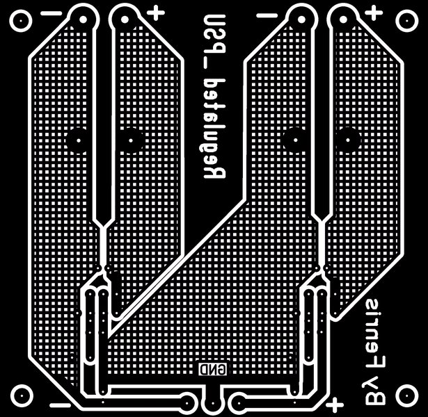

Also one area that is not covered on the schematic or the minimal text for the design - R6 and C6 These are not given a value but having looked around it seems C6 is 100nF and R6 can be 2R7@1W. I can only find 2R2 with my 'usual supplier'. Would this do?

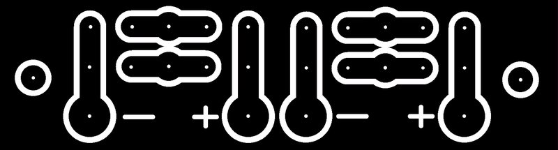

PCB wise I have made the diode rectifier portion a separate PCB. Variations on number of transformers, and regulator circuits are also being mulled over.

the two bars | & | mean Mod.
Take the +ve result of a +ve value and/or take the -ve value and invert it to a +ve value.
So Mod Vcc + Mod Vee = Rail to Rail voltage.
Note that 84 is an absolute maximum if signal is connected there is also a 94V max for no signal condition. These maxima must not be exceeded in worst case conditions.
I don't know why National show 2r2 for the output Zobel.
I have found that 10r works and 5r works. 5r (1W2) = 10r//10r, 10r (2W4) = 10r//10r + 10r//10r
If you want to try 2r5 since that is a lot closer to 2r2 then use 4 pieces of 10r 600mW resistor for the high power low value resistor.

Hi Daniel
The regulator is based on the one as described on the Decibel Dungeon site. See attached image. So the parts were chosen against this rather than my knowledge, or lack of it.
I have edited the image to add a pair of caps directly across the secondary coils and added caps across each diode of the rectifier sets. I have seen both these referenced on here and you mentioned the latter as well.
I did google for information on transformer selection. I think I ended up at the ESP site where there is a pretty comprehensive guide to PSU design. I'm afraid when it got to the math involved I blacked out........... (One day I'll pay a certain math teacher a visit and remonstrate upon his person in no uncertain terms how badly he screwed me up with the subject)
regards
Foo
regards
Foo

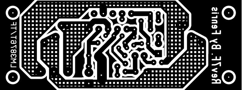

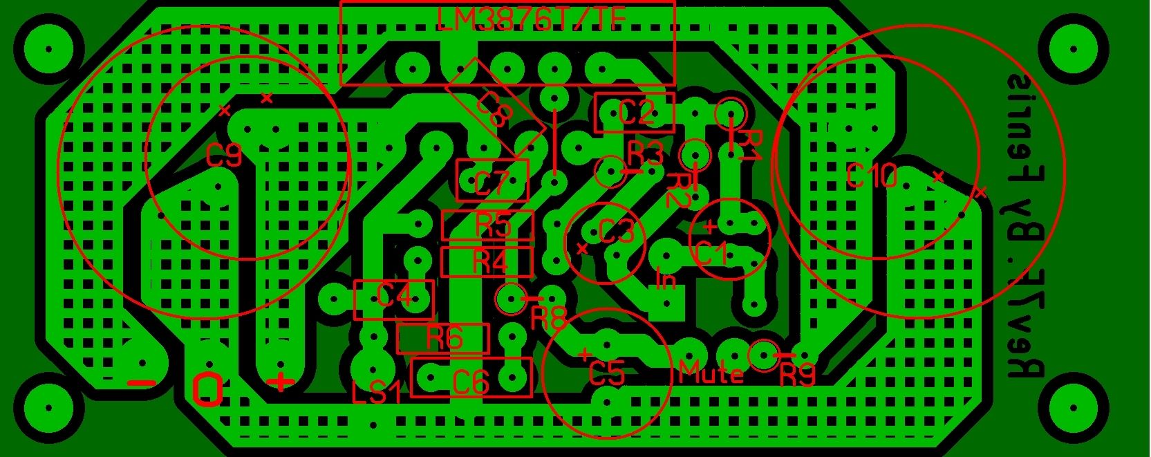

ARGHHHHHHH!
Ho Hum.

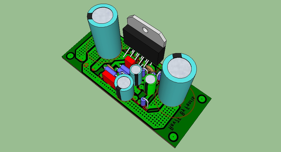

Whilst compiling my shopping list for this project I came across some minor 'issues'.
I have mixed up C2/C4 as far as physical outline goes. I can correct this with minimal disruption to the existing PCB pattern.
But, there had to be one somewhere, C1, the 2u2 cap, has a package footprint of 7.2mm X 7.2mm. This means a pretty large movement of C10, to the right is needed which buggers up the mounting hole in that quadrant. I really don't want to make the PCB bigger to accommodate this change. Also having tried out this change I just don't like the look of it......OK it's only a PCB pattern but I have my foibles 😀
So, C1, can I change to an alternate value such that I can use an item which has a footprint that falls within?
A resin dipped cap of 1uF perhaps? I could even fit 2 of these in parallel by fitting one topside and the other track side.
Or 220nF, seen on a few other designs that has a footprint of 2.5mm X 7.2mm.

C1 (amp input cap):
Elna Cerafine 4.7uF or 3.3uF or 2.2uF // ~10nF polyester (that combination is named "classic combo")
Nichicon ES 2.2uF // 10nF polyester (turn the 2.2uF for clearest operation, add the treble with polyester)
Nichicon ES 1uF// Nichicon ES 0.5uF (set one "BP" mark inverse of the other)
Blackgate (see audiosector support forum)
Input transformer (see audiosector support forum)
These options are likely to outperform the overlarge selection on clarity.
Any of these prospects is for far higher quality audio than masking at the input with huge plastic and or motor caps for tone purposes.
For modification of input capacitor tone without endless capacitor selection, just make a clear choice and then add my "impedancething" circuit series to the input. It does not replace the input cap but rather adds the slight impedance screwup that audiophile caps can do for a more laid back sound. With clear input cap + impedancething, capacitor effect is entirely under your control via variable dial. The article on it is located in the triple lm1875 thread along with an economy audiophile sound card and a few other ways to do stuff on purpose rather than leave them to chance.

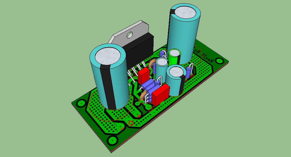

You might want to allow more spacing, including selectable pin spacing arrangement, for NFB cap. It seems crowded up against the feedback-shunt resistor and input jack. Sure, you could use 16v caps here, even recycled from computer motherboards; but, what you'll really end up using is whatever is clear, regardless of its physical size. It may as well fit gracefully. At some point, there may even be a trackside party, so be sure to leave room. The importance of this part is equal to, if not greater than, input cap. An NFB cap provides better speaker safety, a longer lasting amplifier and better dynamics; however, there will be a small selection effort, like interviewing a few candidates. Whatever works is more important that whatever fits. You might want to plan for that.
Hello Daniel
I've googled your recommendations, purely for visual reference, The uF ones are in fact electrolytics yes?
I know electrolytics can be used I'm just checking I am on the same track as yourself.
I quite agree that what works is more important than what fits. Fingers crossed your post gets me round the fitting issue without detriment to the end results.
Something I picked up in another thread, as regards the PCB pattern, I have moved the edge of the trace, that runs under the LM3876T, so there is a gap between the board edge and the trace in question to avoid possible shorting issues with the heat sink.
Where I can I have added extra pads to allow 2.5mm - 5mm pitch caps to be swapped out.
