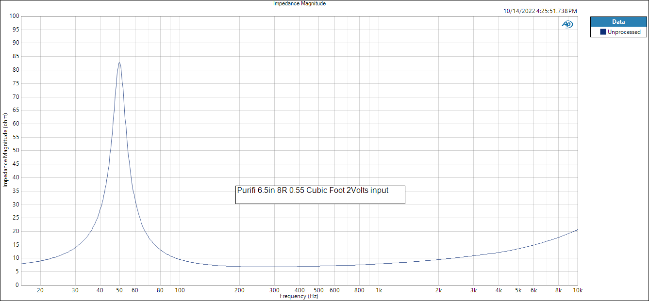

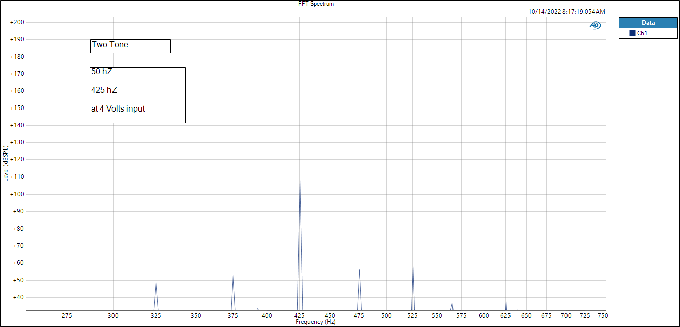

Hello All,
Here is what I can do with the noise of cooling fans.
This is a IMD plot at 50hZ and 425hZ, for the 6 1/2 inch 8R purify mid-bass driver in a 0.55 cubic foot sealed enclosure.
Not unlike the datasheet.
This is very nice for a mini 2.1-way that will sit on my bench top.
Very much worth the time and money.
By the way I do have a system with 15 inch woofers 10 inch mids and constant coverage CD's + waveguides in the same room. 10 Watts will have the police knocking at the door. I will post measurements another time and place.
Thanks DT

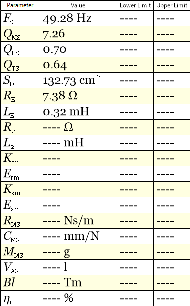

Overall I believe that you are correct. If you get into the fine details there is more to know. I do not think that the influence of suspension turns off like a switch at resonance nor does the mass become suddenly in charge at resonance either. Resonance is just a fuzzy division between the two.Yes indeed - the driver is mass-controlled above resonance, so there may be some HD due to the air suspension at bass frequencies, but this won't cause IMD up the frequency range - so is largely unimportant.
Also the air volume of the sealed enclosure is also responsible for the increase of the resonance frequency and Q of the driver when it is installed in the sealed enclosure.
The resonance frequency of the bare driver is 34hZ and increases to 50hZ when it is installed in a 0.55 cubic foot sealed enclosure. If you look at the IMD plot of 2 tones, 50 hZ and 425hZ that I previously posted you see all the evidence of a IMD skirt on either side of the 425hZ tone, which is well above the 50 hZ resonance frequency.
See the attached plots:
