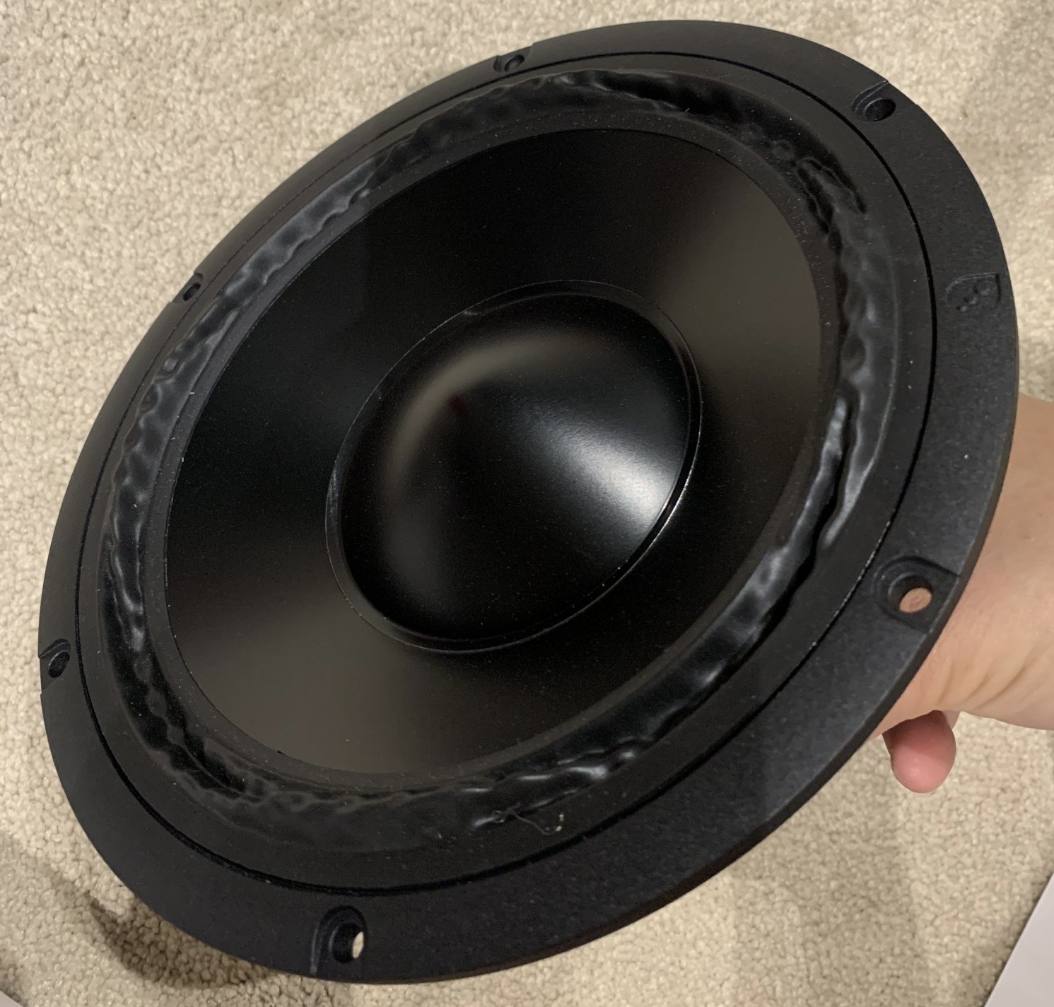

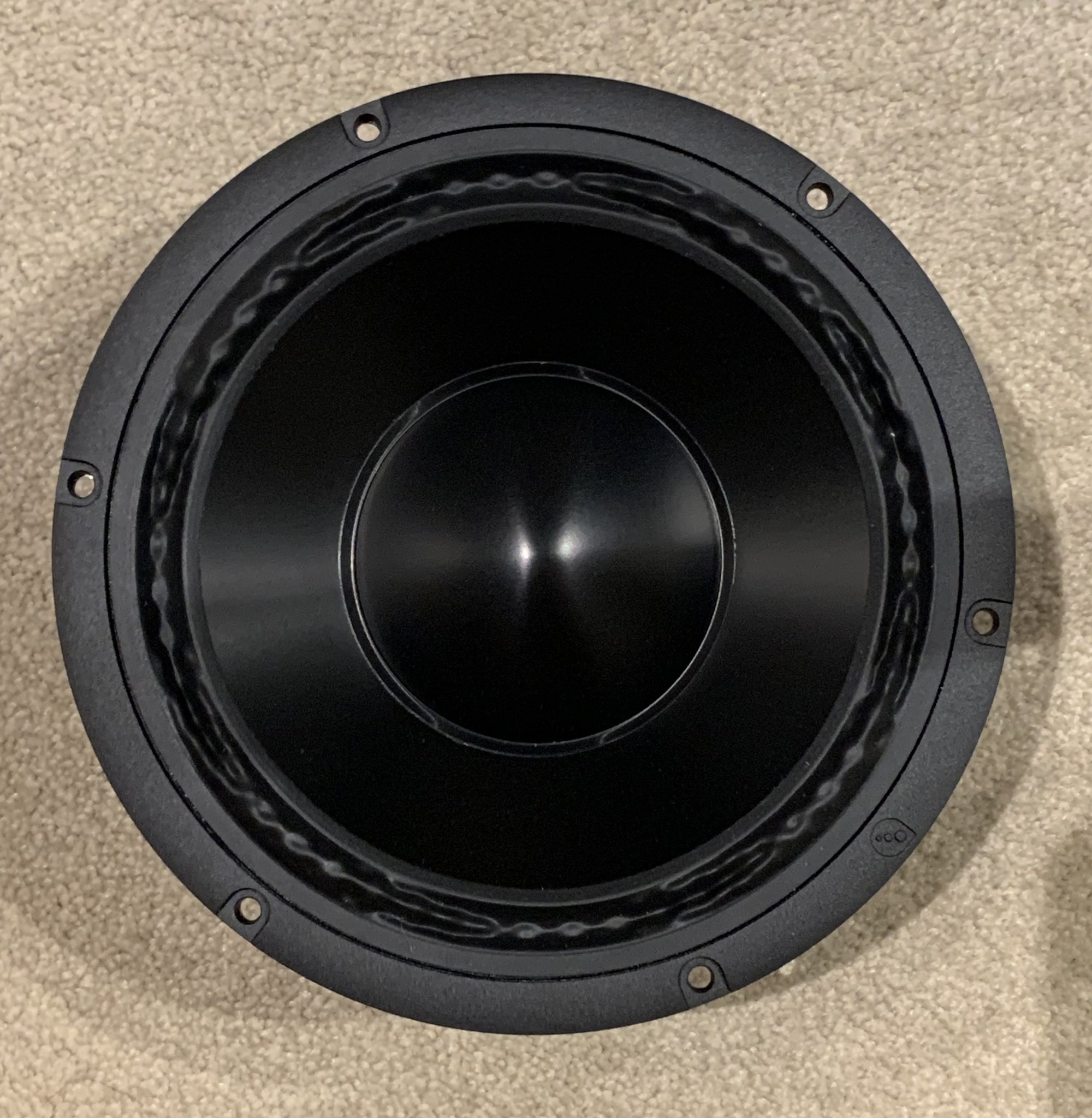

Mine arrived this week…
https://www.diyaudio.com/community/...ifi-woofer-speaker-builds.352063/post-7085572
Basically it works in the same box as the 4 ohm version.

The PTT8.0X-08-NAB (8Alu-8) looks ripe for waveguided 2 way. Or use in pairs. Or converted to a state of the art co-incident/co-axial driver.
Now, who’s brave enough to remove that dust cap… @5th element
Use a hairdryer or heat gun and gently heat the dustcap until the glue softens. The only drivers that happen to use heat resistant (non thermoplast) glue are the alu coned Dayton Long stroke subwoofers. For others resistance was futile..But Lars can certainly tell us if the glue applied is thermoplast or not.
