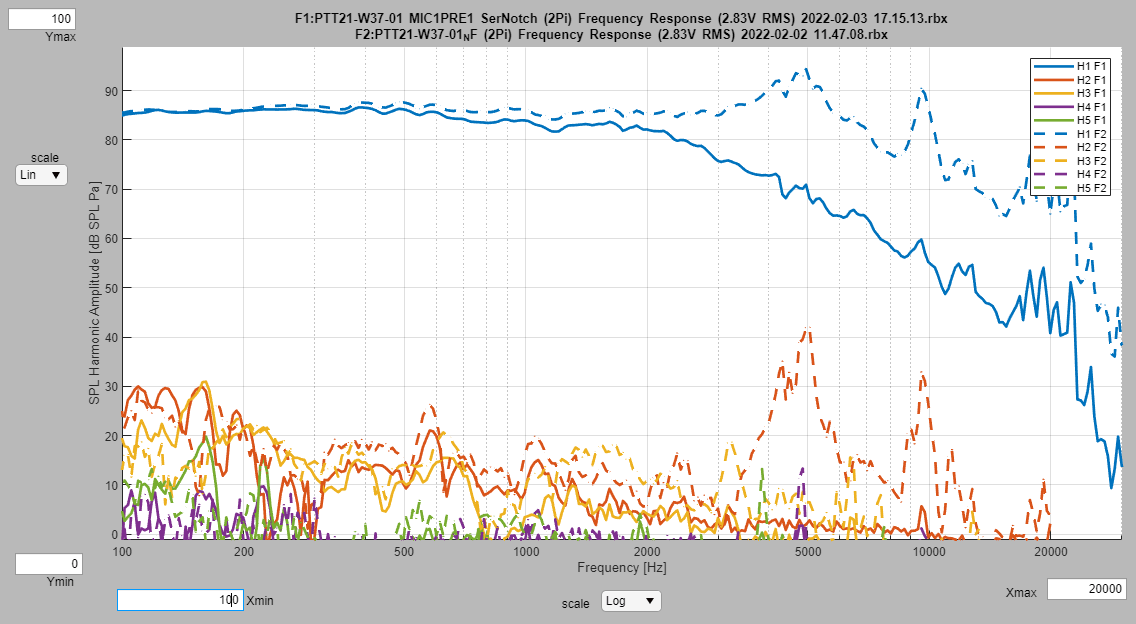

OK, if we're on the 'I want breakup distributed' concept, let's look at this logically for a minute. This unit, like some others, obviously has the design objective of concentrating the main modes to a single well-defined peak (the secondaries don't start until almost an octave higher, which gives a good idea of how effective this cone profile must be), and act more or less as a pure piston below that. A single well-defined peak, especially at a reasonably high frequency, is a hell of a lot easier to deal with in a crossover than multiples, as well as resulting in lower overall distortion levels. Multiple distributed modes are certainly appropriate for a wideband driver like a Jordan, MA etc. -that's how they work. But that is not what this is for: it's a midbass with very different design method & priorities. Lars & Purifi are obviously aiming for a slightly less ambitious, but still quite broad BW over which the driver is more or less unresonant (i.e. 'pistonic') with very low HD and a stopband mode that is easily dealt with in the filter. True, that does partly preclude a low-order filter at a relatively high frequency, as was suggested above, but those have their own issues with a 6 1/2in driver in terms of centre-to-centre spacing, polar response etc., so presumably compromises like that weren't a priority when designing this unit.

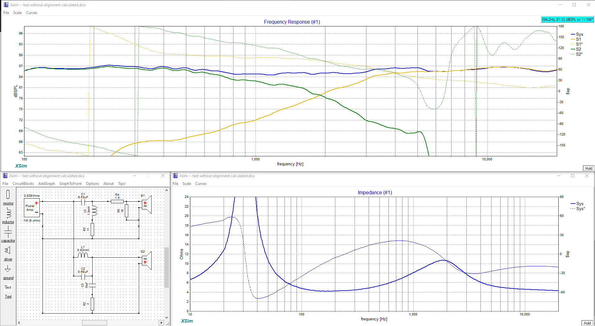

What's wrong with a 1st order slope up to say 4kHz, together with a notch at 5k and notch at 10k? If the amplifier is not screwing things up then those resonances should just be a kind of 'falsetto' with no reason to suspect a loss of purity as such except for the radiation pattern.AC (presumably) was referring to 'Acoustic Centre'.

If you're saying 1st order acoustic at 4KHz, then you'll only be about 4.5dB down at 5KHz, with a wide transition band, and with a bottomless notch placing a high Q hole in the response within this. If you simply EQ the response to the target curve, you won't stop the resonant amplified HD -you need a bottomless notch to do that. Granted, it's low as-is, but higher than it would & could be if you use the driver as Lars & co. appear to have in mind. On top of that, the polars would be lousy with the midbass narrowing significantly relative to the (presumably) tweeter with its much broader dispersion pattern through that BW and below. Usual message applies: on axis response only gives part of the story.
Right, a shunt would be a way to work around the peak, of course.the subharmonic distortion peaks are due to motor distortion (hysteresis /current distortion) being amplified by the cone peak. However, our motor has extremely little distortion to begin with. Moreover, by adding a notch as an event in series with the driver then the current distortion is proportionally suppressed at the peak frequency thus killing the subharmonic peak. the THD peak at the peak frequency it self is also killed by the EQ. we come out with an app note about this

I played a bit with traced fdr and imp from the specs to see, and it's quiet hard from that data to cross higher than 2kHz with a second order passive crossover to avoid that resonances. I'm not using dsp myself for the moment, but i guess it will be similar. You will need high order crossovers to go higher than 2kHz, and once past 3kHz it will be impossible to tame that peak. But at that point dispertion is getting so poor it's not feasable anymore for such an expensive high end driver made for neutral sound to cross. Even from dispertion point of view 2kHz is more or less the limit. Pure as illustration of this I added my result (tweeter is SB26ADC, no calculations were made for alignment and so, it's a pure theoretical try out).
we do not measure Le(i) but you can get an idea from looking at the current distortion. The motor topology has inherently very little Le(i) modulationRight, a shunt would be a way to work around the peak, of course.

applying notches: one has basically to tune the center frequency, Q and depth of the notch and any peak can be ironed flat. Of course, unit to unit variation and component tolerances sets a limit at the end of the day

My desire is for a 6 or so inch driver, that is reasonable to 60 or so, and be able to reach where most tweeters are happy, 2500 minimum, 3K better and get away with no more than second order electrical. I am not so greedy, or unaware of phase, to expect a first order electrical filter. My own testing concurs about with the published charts from Purify, that on the low end, distortion skyrockets at about 1/2 X-Max. ( Maybe the Purify does better 🙂 ) That applies to tweeters as well. So many look tempting to cross low as they get a pretty frequency response, but not good for distortion. These harmonics may be one of the causes for the breakup whose additional sub harmonics are causing the "glare" issue I am working on. That is why a LP on the tweeter only helps a little bit. Well behaved tweeter helps a little, and some yet to be determined behavior of DAC and amps effect it a little but less if a well behaved tweeter. Bad mixing effects it a lot, but nothing I can do about that.
