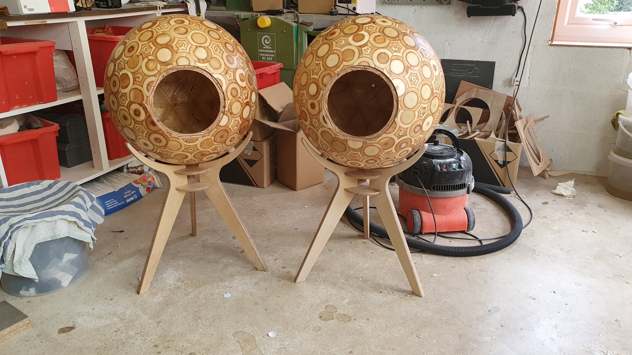

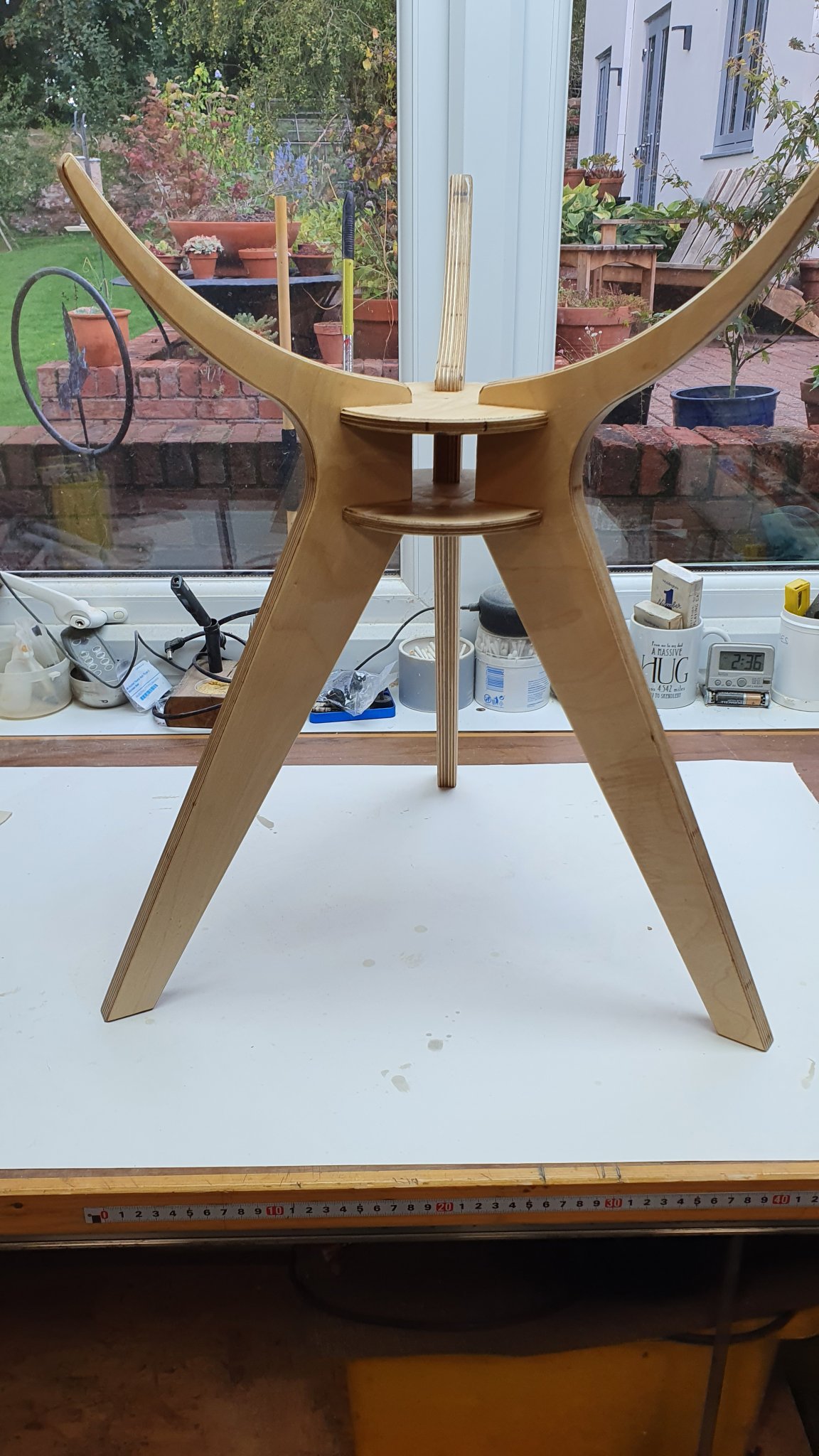

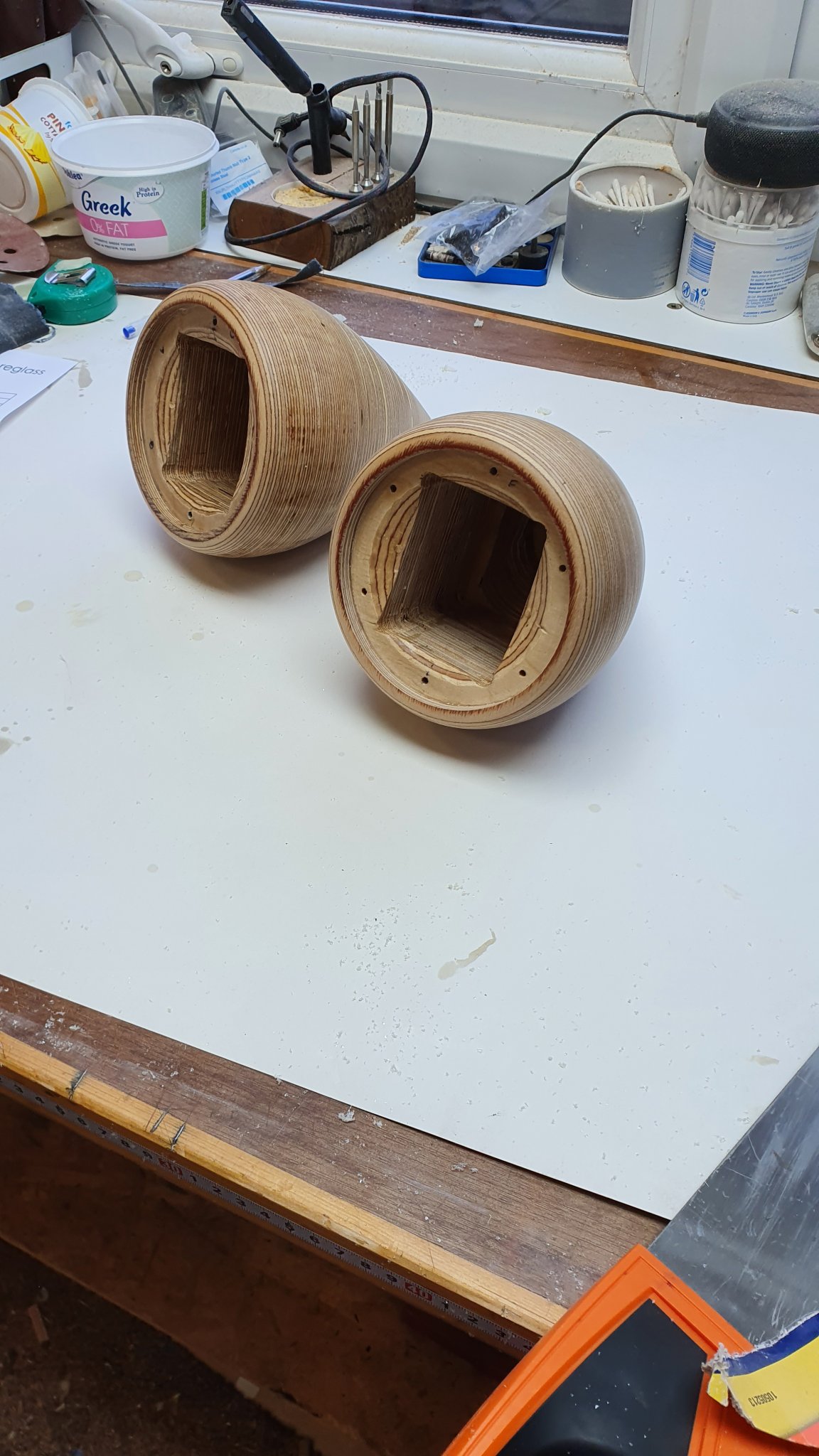

Have you had any more thoughts on giving any info in regard to the acoustic centre for this driver?
My build is progressing, drivers have arrived, tweeter pods are made but can't be shaped to fit close to the spheres until I have an offset figure for the drivers (easy for the tweeter it's a ribbon)
I will soon be in a position to make some measurements for this offset, but to have an approximate physical measurement would give me much more confidence in my acoustic measurements!
Steve

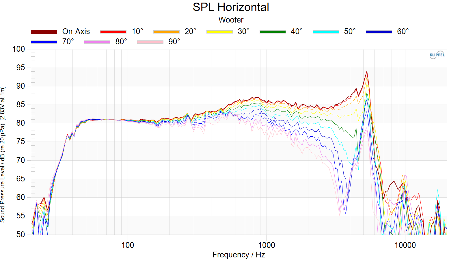

here's everyone's favorite older, but smaller brother PTT6.5X-04-NAA in a thoughtfully constructed cabinet-

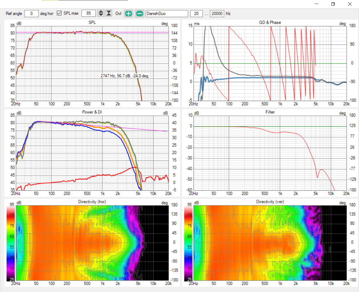

Mr. NFS shows that the 10K resonance seen on the datasheet has been suppressed:
with just one notch filter filter tuned for that 5K resonance:

the 1k glitch from Erins NFS is not there.interesting. well done!

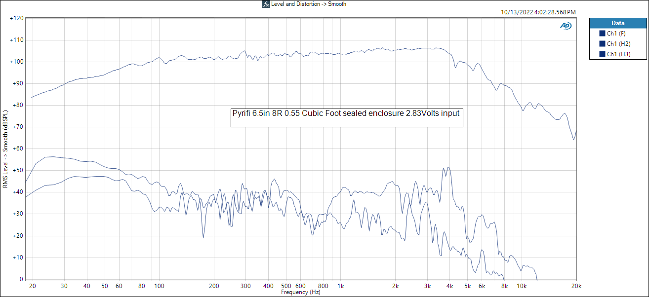

Hello All,
Today I have been test driving the Purifi 6-1/2in 8R driver today in an effort to dial in the APx 500 test procedures. The plan is to do similar testing with the 8in 8R drivers when they arrive here in the Pacific North West.
I set the Purifi 6-1/2in 8R driver up in a sealed 0.55 cubic foot Denovo enclosure and input 2.83 volts in an effort to compare my test results with the data sheet. See the attached test plot below.
My results are mostly in line with the data sheet. For my possible application as a mini 2-way bookshelf on my bench this sealed enclosure speaker looks like it could work well. There will be a sub tucked in on the shelf below the bench.
After previously seeing the red flag caution about about using this driver in a sealed enclosure I am glad to see tame levels of distortion in the below 100hZ range. The little assist in stiffening the LF suspension limits the LF travel of the cone. (speculation)
