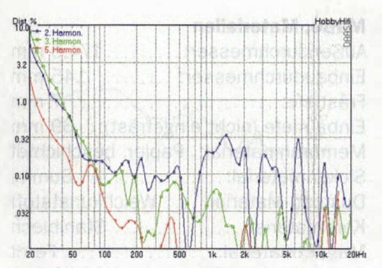

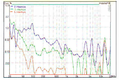

Take a second look at my chart b_force bigger drivers are outperforming the purifi in some IMD test like the 10" Peerless XXLS at 60 and 144hz (albeit in fractions of percent).Bigger speakers having higher IMD numbers compared to smaller speakers just don't make a lot of sense.
If you don't want to look at my data look at hobby hifi tests. Let say we are doing a 40 and 96 hz IMD test with the Purifi 6.5W04 and seas l26roy
Here's the distortion profile of the Purifi
and here is the Seas L26roy
96hz is not looking good for the Seas, but that's why I test at a variety of different frequencies. To be fair a 20hz and 48hz IMD test might tell a different story.

We were talking IMD, this is just plain THD.Take a second look at my chart b_force bigger drivers are outperforming the purifi in some IMD test like the 10" Peerless XXLS at 60 and 144hz (albeit in fractions of percent).
If you don't want to look at my data look at hobby hifi tests. Let say we are doing the 40 and 96 hz test with the Purifi 6.5W04 and seas l26roy

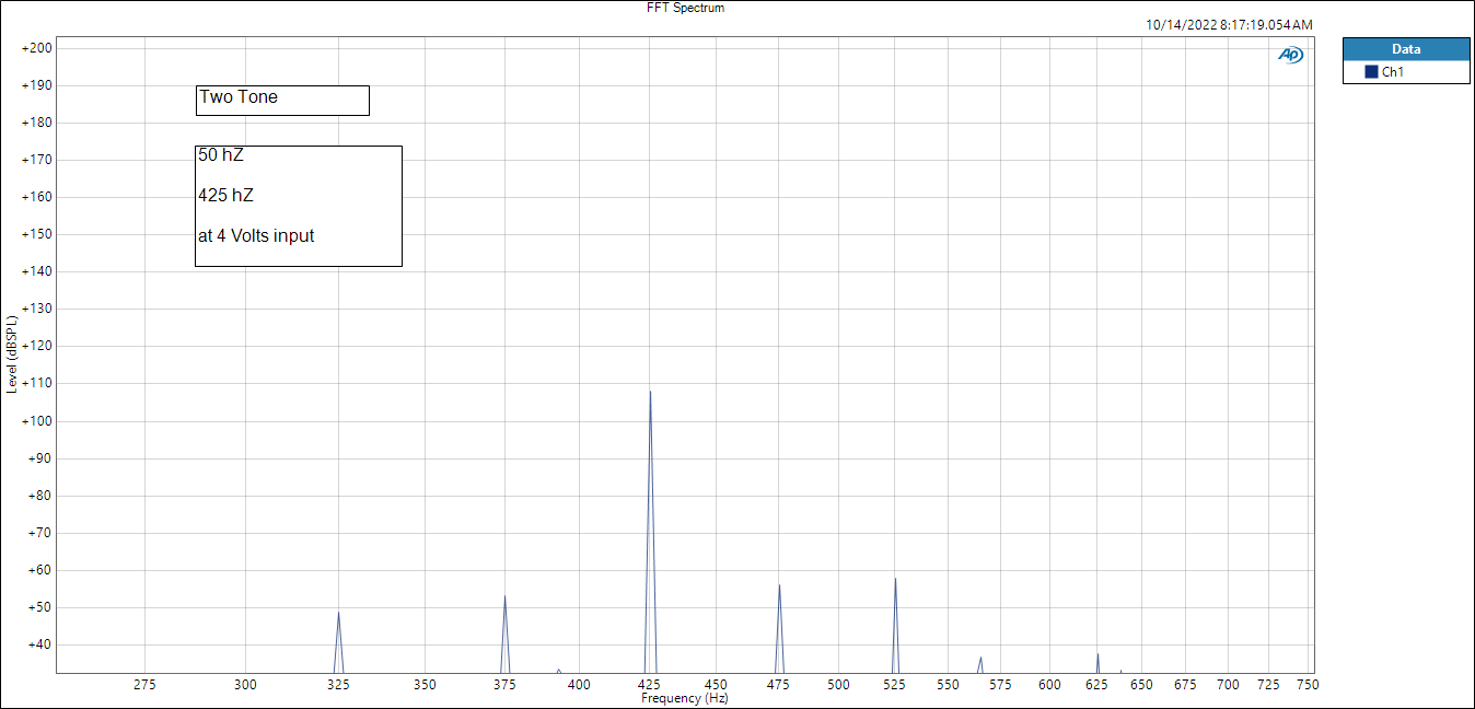

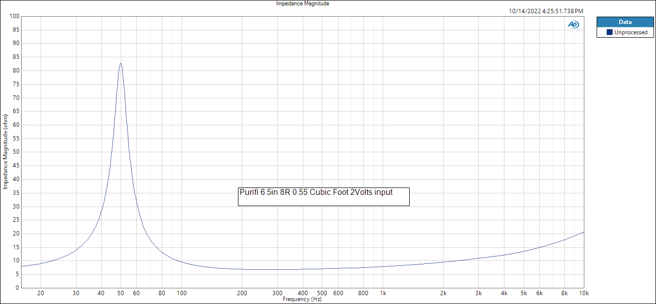

I tested this. I installed a 6-1/2inch Purifi driver in a sealed 0.55 cubic foot Denovo enclosure.
As expected the 2nd HD below 100hZ increased a bit. The HD above 100hZ was largely unchanged. The Two Tone 50hz , 425hZ IMD was unchanged or slightly improved. Voice Coil displacement is reduced.

I installer the 8R 6-1/2 inch Purifi driver in a sealed 0.55 cubic foot enclosure, then ran an Audio Precision impedance sweep plus TS/P calculator and found the Total Q of the driver in the sealed enclosure to be Q=0.64. This is not bad for a sealed enclosure.
Then I set up The APx555 with the AP acoustic measurement software application, the output voltage was set to 2.83volts with the microphone at 1 meter. There was way too much room noise and room reflection. So I moved the microphone to within 4 inches of the driver cone (near field).
I used the same setup for the same reasons as above at 4volts for the Two Tone IMD voice test.
I am okay with the bass FR as is. If I need more bass I will turn on the sub-woofer. I want to avoid imputing more bass frequency current into the Mid-bass driver that plays the voice frequencies.
What I am asking you is, are you equalizing to raise the the bass SPL? That answer appears to be yes.
Thanks DT
