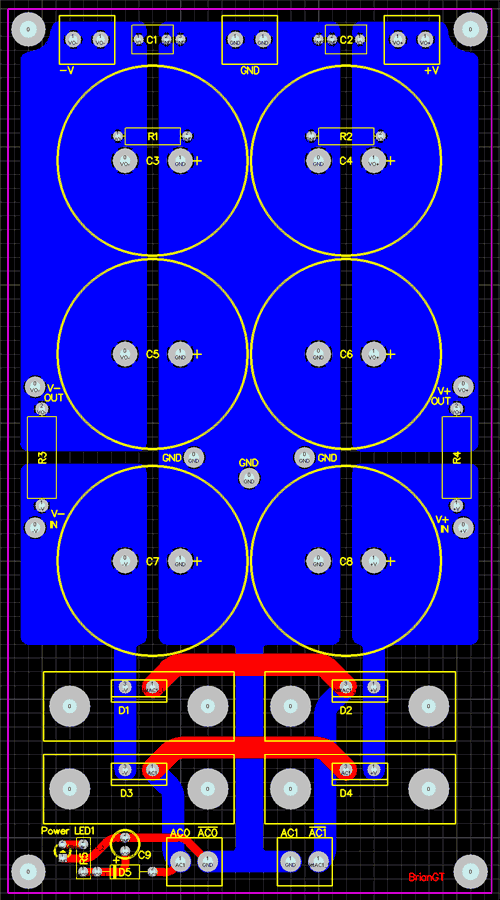

Here is a picture of the power supply board, single bridge with heatsinks on the discrete diodes.
There are 6 - 35mm caps on the boards.
The pads allow for a CRC or CLC setup. If the stock application is desired, jumper wires can be installed instead.
I am looking into making a soft-start/relay board for the amp now.

The current idea is that there will be 2 pcbs made:
Amplifier pcb:
2 - amplifier pcbs
4 - output boards
size: 3.5" x 8.2"
Power supply board:
1 - power supply board
1 - soft start pcb
size: approx 3.5" x 8"
(boards scored for easy seperation, as with my gainclone boards)
For a dual mono, 2 power supply pcbs could be purchased.
For the soft start board, I am researching this now, and here are my ideas for the board:
- pcb mount AC recepticle for mounting against rear panel of chassis
- fuse for AC line coming in
- CL60 thermistors in series with AC lines
- transformer and relay circuit (similar to this )
- possible AC caps for filtering
- selectable for 120/240 power
The idea for the power supply is that the AC plug would plut into the soft start pcb, and then the transformer primaries would connect to that board. The transformer secondaries would connect to the power supply board. This would eliminate the chassis wiring, except for the central grounding setup. The goal is to allow for a momentary switch to be used, and handle the inrush current.
Let me know what you think. I want to get this design finalized soon and prototypes ordered so that we can get this design tested and get a production run of boards.
Brian

Absolutely🙂People still interested in this..
Pyyyh, I am not the only one. What a relief😀 😀p3a, doz, lm3876, aleph2, aleph-x (will probably never finish), ksa-50 and now mini-a i am crazy.
The PSU design looks great, If people wants a regulator it can be
applied after the caps, with little effort.
Brian, very good idea with the softstart/fuse pcb. Be sure to include the AC cap as well.
Steen.
I'm still in.
Brian, would like to find out more about the soft start PCB. Might also work for our Krell KSA-50 Klone GB too.

The idea is this:
- pcb mount IEC connector
- ac line fuse
- selection allowing for 120/240
- CL60 thermistors in series with AC primaries
- heavy duty relay used, controlled by the momentary switch with a flip-flop / debounce circuit for the AC switch
- For the board, CE guidelines should be followed so that people in the EU can use the board. (where can I find these guidelines?)
The CL60 thermistors should handle the inrush currents if they are put in series with the AC primaries.
This board would also be available separately for use with projects other than the Mini-A.
Brian

I tried to use resistors with some of Pass amps, but it never worked well. Since the amps have a constant current draw, there will be always voltage drop on the resistor (it may be even 50% of mains supply). The caps will never charge completely, and when resistor is shorted, there will be more inrush.
Thermistors, while changing resistance, provide more dynamic behaviour, and seem to be a perfect choice for that type of applications.
I am asking this because I don't know:
How about a hybrid solution, using a thermistor in place of the resistor, but also using relays to cut the thermistor out of the circuit after inrush charging (when the thermistors resistance is low)? Probably overkill, but would make the thermistor last longer, though it sounds like it's longevity may not really be an issue (never used one).
Thanks for all your work on this guys!
Putting relay to cut thermistor off is a good idea (although more complicated to implement). It has advantage especially when you switch the amp on, right after it was put off: in that case thermistor might be still warm and doesn't perform well in inrush supressing.
So would it be as "simple" as swapping a thermistor for the resistor, then uping the delay time for the cutout relay?
I would thinks so. In case you are using relay, the thermistor's value could be even higher, for more suppressing action.
