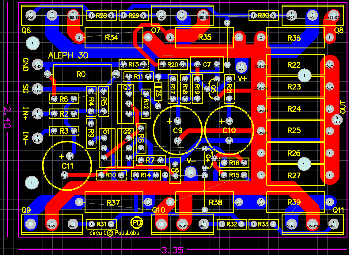

The Aleph30 PCB layout
I have created a poll for both designs to see what people prefer:
http://www.briangt.com/gallery/aleph-poll
(site will allow you to click vote multiple times, but only 1 vote is recorded per IP address)
I will make the poll results visible on the site, once a substantial number of votes are recorded. (wouldn't want to skew the vote through early reporting).
If the Peter's Aleph30 design is preferred over my Mini-A design, I will work with Peter to rework the design into this new form factor. I would also prefer to add the zener protection diodes to his layout, and make the mounting holes easier to access.
Brian
For a sake of comparison, this image would be better, as it shows overall dimentions. It is also the latest version, with all pads and some traces further optimized. 4 mounting holes are added as well, for using board as front end only.
I think people would like you two guys to
stick your heads together, right about now, and create the most
elegant, flexible, scalable set of Aleph pcbs possible. Preferrably with all the good ideas that has come up so far. I am Zensing that
Peter is really fired up on this, so let us all get the advantages of that🙂 🙂 Can anyone second that oppinion?
Steen😎
BTW: I do like the idea of having output boards😉
I absolutely second that opinion. Both designs are very good, with unique advantages, but really they are very similar. They are two arrangements on the same theme.
I like idea a seperate power stage PCB. I also know that I will opt for the Aleph30 configuration when I get a chance to build one.
If you reall only wanted to used one board for an Aleph30 Peter's PCB is very nice.
Otherwise, I tend to lean toward Brian's PCB as it seems a simple way to allow for very flexible heatsink layout. You could easily use one heatsink for all 6 devices, or 2 for each half, or even other options I am sure.
I am sure you could have a lot of flexibility with Peter's PCB too, but you would have to run wire to your output devices, and with 6 that 3 times for wire than you would be running with Brian's kit.
Still Peter's design is very attractive because if you can leave the devices on the PCB and layout you heatsinks accordingly it will not have any wires in the signal path. I doubt anyone would ever be able to discern that difference audibly, but technically it is apealling. 🙂
I agree it is very appealing, BUT, I strongly doubt that it would be possible to dissipate the heat from all the mosfets when they are sitting so close. Running 6x3 leads is not appealing though😉 I can only repeat: Outputboards is it, if you want several output devices.
Steen.🙂
I have some concern about having the Aleph30 in such a small form factor. Recalling how much heat the MiniA generates when I built my earlier prototype:
http://www.briangt.com/gallery/mini-a
The heatsink that I used ended up being too small, and ended up being too warm to touch. (I did orientate the heatsink in a vertical fashion when running extended tests, for proper heat dissipation)
I am thinking that unless active cooling is used, output boards would be a wise idea to space the devices out more.
Also, 4 wires per output boards won't be difficult to wire up.
