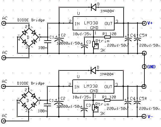

tiroth said:You could easily use Digi01's LM338 boards for this, the current and voltage is well within their specs.
For the main board "ONLY" not the output boards correct?
I would hate for someone to let out more smoke..
They are spec'd to 5A, I believe. I don't know how much you can realistically get out of a single regulator though in class A...the thermal demands are much higher.
"Use with caution" depending on your bias, perhaps. 😉

That is true about the Digi Boards i have 4 set's too : O ) I wonder if they will handle the current though. Also would have to change some parts to get 15V rail's

I've been using an LM338 regulated power supply for a while now as a generic supply for various projects, with the output as high as +/-30V at 4 amps continuous, with occasional short demand spikes as high as 10A, so I don't see a problem with using them to regulate the whole amp supply. That being siad, I would err a bit on the side of caution, and separately regulate each channel. Also, don't forget to put a big schwack of capacitance after the regulator too.

I think ill use my regulator boards : O ) now to find the exact part to get the output after the regulator to 15V
You can throw a pot in there, tune it, and then just measure the values. Probably the easiest way.

A pot in where ? On what resistor i don't have the schematic..
