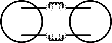

I have a new power supply board that I created for this, with more capacitance. My current idea is stay close to the service manual schematic, with 2-3 - 35mm snap-in caps per rail, and a single bridge rectifier, created with discrete diodes.
If the power supply boards are small enough (2 caps per rail makes them reasonably sized), then they could be added to the pcb set. I think that a single pcb with scoring could be created to accomidate 1 main board, 2 output boards and 1 power supply board.
As far as a CRC/CLC setup, nothing has been created yet. Any suggestions for implementation?

Make the pwr PCB set up for 2 caps and have the traces end on each side of the caps with plated through holes.. If CLC is desired then jumper with coil. If no CLC then short with wire.
