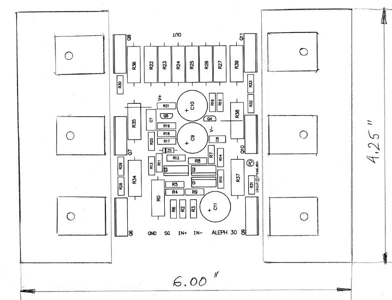

I think the solution to that is very simple. Since my board is about the same size as Brian's Aleph Mini board (yet still allows functionality of both A30 and A mini), all it needs is additional output boards for broader (and more thermally efficient) applications. This way you will have the best of both. I'd like to note that although my board allows all 6 Mosfets (and power resistors on board), the front end section layout is not compromized in any way because of that. I actually think it has some advantages.
As to the output boards, I would see them as rows of 6 devices, which can be broken in half, if only 3 per side are needed. This would give a choice to people getting one board for two channels or one per channel for more power. There would be 2 output boards per set.
I'm not gonna mention here possibilities of applying the boards to Aleph X as well 😉
Still, no matter what verdict in here is, I will produce my board anyway, as I believe it's a way to go with a small Aleph. I did a drawing, showing 6 devices mounted, with copper spreaders (which definitely would be very advantegous). As you can see, the size is about right for R-theta heatsinks ( 6" x 11") which are perfect for one channel of Aleph 30.

And I'm trully not concerned with heat problems. With copper spreaders it will run cooler than with bigger board without spreaders.
I can't help thinking that Brians layout is more simple to implement. If this is to reach a broader audience, I dont think copperspreaders wil be appealing (to most ppl) Also if the output boards are to be used in Peters design, you would have to leave out 14 resistors on each board. Also there would have to be 2x4 clearly marked pads on each board, for taking the leads to the outputboards. Unless you mean to take out 18 leads from each pcb.

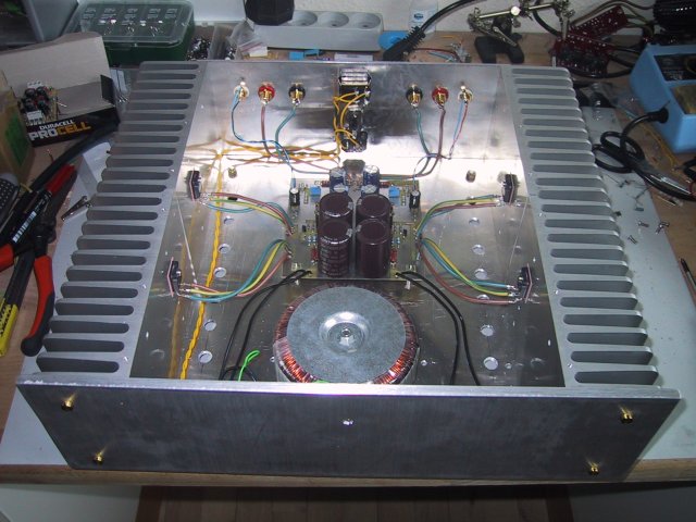

So for the groupbuy, my vote is still for Brians layout. BTW, Peters layout is quite amazing, with all that stuff fitted on that little pcb🙂 And cute it is, for sure😎 As for the heat, I was playing a little this weekend. It occured to me that I had all the stuff lying around for a ZenV1 amp. I stumbled over a pcb for it😀 I couldn't resist and did put it together. The chassis is my "play" chassis🙂
Considering this is 2x10 watts, the amp runs amazingly hot. The sinks not being huge, but not excactly small either, I was stunned about the temp it ran at. One Fet per sink! I would never mount three on each of them. Have a look .🙂
Steen.
BTW it sounds great, except for the psu ripple that spills over at the output. I intend to get rid of that though.
I agree with Peter, I had no problems with one of my Zens dissipating 100W per channel on huge heatsinks with the only 2 mosfets which were fairly close together. With the A30 this dissipation is shared between 6 FETs so the junction temperature will be even lower. If one still think it gets too hot one can always decrease bias current... there are plenty of topics on how to do that 🙂
Actually it's only 7 wires, if you want to spread the mosfets: you leave mosfets on one side on the board, all resistors stay on board as well, and you place only 3 mosfets outside the board. You will need 3 wires to connect gates, 3 wires to sources, and one wire for shared power rail.
