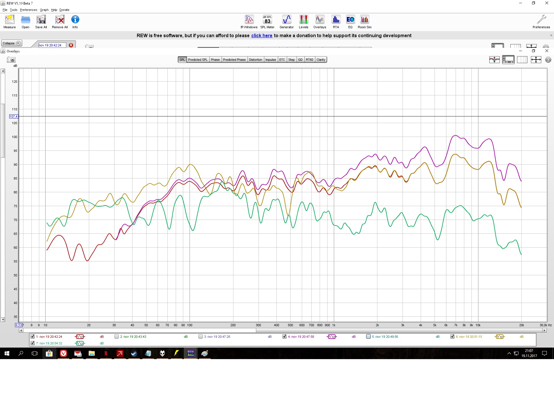

In the absence of proper measurement facilities, I have done some measurements at 42cm distance from the cone center of my right side speakers. There is hardly any room interaction on this distance.
In this picture the measurements (all 1/12th oct smoothing) are as follows:
Pink: FC152 only, no EQ or other settings.
Red: FC152 only, no EQ but a 3db LP filter at 5khz.
Yellow-ish: FC152 + dual 15-400, no EQ but a 3db LP filter at 5khz.
Green: And last, it's the listening position, with FC152, dual 15-400 and the same 3db LP filter at 5khz, nothing else.

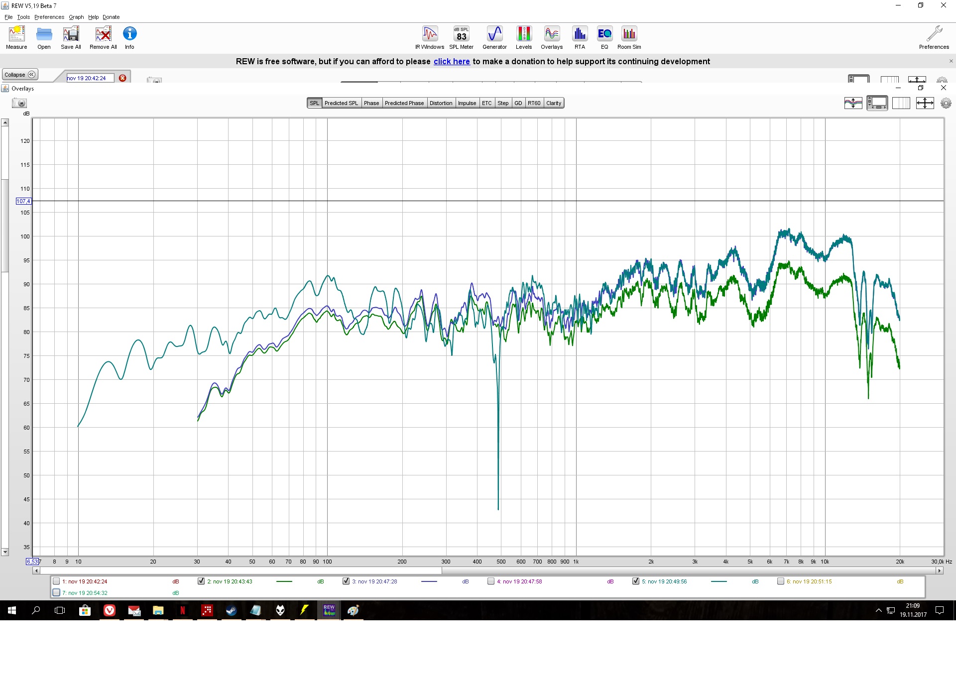

Here is the Unsmoothed 42cm measurements:
Cyan: FC152 + dual 15-400 and nothing else. (Blends with the Blue over 1khz)
Green: FC152 only and 3db LP filter at 5khz.
Dark Blue: FC152 in it's natural state, ca 80 liter sealed box.
Overall I am very happy with the results, the 15-400's give me more frequency extension than I'd hope for in my listening position. The FC152's are toed in slightly to give a broader sweetspot, when toed in it sounds nearly the same in any seat, even if you are directly in front of one.
There would not be any problem at all to use further EQ and filters to flatten the response, but when comparing the different files I tend to prefer the slightly dampened top end over most heavy EQ settings.
