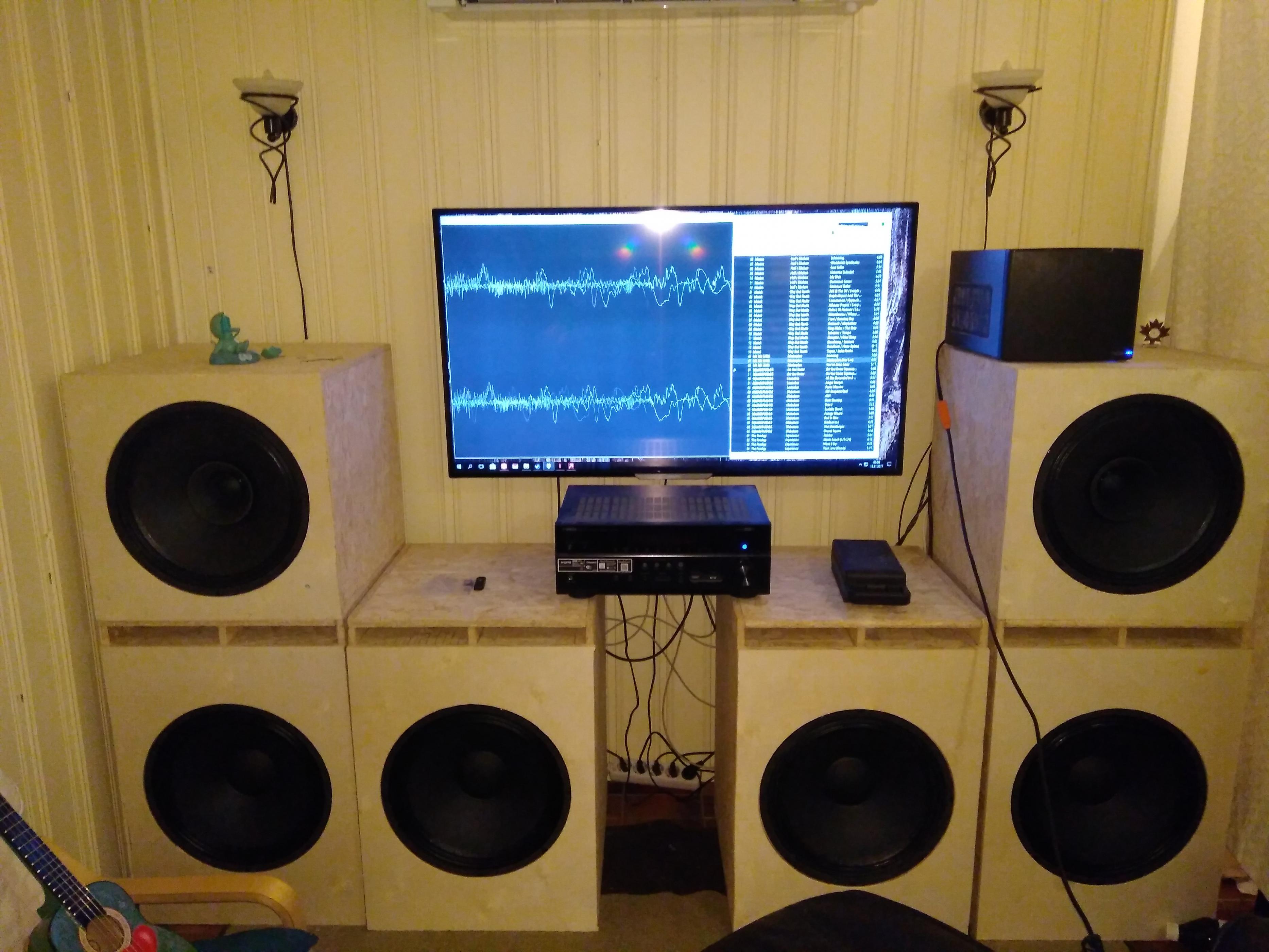

We have liftoff. I had to give up, at least until spring. Will do the surface treatment then. Too cold and snow outside, and my trim router bit broke, need some more parts also to hide the ugly corners. But the speakers sound fantastic, even at low level there is a sensation of impact that is very engaging.

wow!! would love to hear this setup in person!!
did you put the 15" fullrangers into a closed cabinet? how much litre?
with 2x 15" additional drivers i would have expected you to build an open baffle?

I do not have much power to give them, but they will probably be used with the tpa3255 when I get around to it. They play ridiculously loud with hardly any cone movement. It will have to wait until spring before I can drag them outside and try and give them a beating. If I had a marginally thicker wallet I would have offered to reimburse you if they do not fit your application, but I have to prioritize here. 97% certain you will be extremely happy with them. If nothing else then as a mid/tweet. Treble is better than some silk domes even, not all of them though, but very dynamic and natural sound.
Did heat them up with some 16hz sine and music at the same time, only gave them ca 90watts each total, low music high sine but sounded very clean, amp got toasty fast.

4 x 15-400 and 2 x fc152
Planning thread here:
Http://www.diyaudio.com/forums/multi-way/286139-budget-40-10k-hz-100db-planning.html
Started planning in January 2016, a lot of thinking and checking out drivers, theory etc. It's been a very good experience. I knew I had absolutely max 300 liters per channel worth of space and wanted 100db/2.83v 40-10000 hz, decided on smooth roll off to 26hz and sacrifice some dbs output at 40hz to get lower and improve group delay and phase variation. Bass is extremely detailed.

80 liters sealed. You are welcome to drop by if you are in the area. Many people like OB, I have tried it and want to go a different route, no matter the design there's always a compromise.

No xo. Just a 3db low pass centered at 5khz right now, because the FC152's are a bit hot up top.
I am going to make/get some bench thingy to stand in the middle, so there will be a tower at each side of the 48" tv. Because I find that when you significantly reduce the noise floor, phase variations and group delay it is not difficult at all to localize the origin of frequencies under 80 hz even. Good bass is much better in stereo, so that has been my plan all along. I do note there is some issues now because the speakers are not vertically aligned, but do not think I will be able to hear anything other than a point source when they get stacked.

The sound is very smooth, tight and punchy. Some times I feel there is some low end lacking but it's more recording variations than anything else. There is enough of everything, depends on the decisions made in the recording studio.
