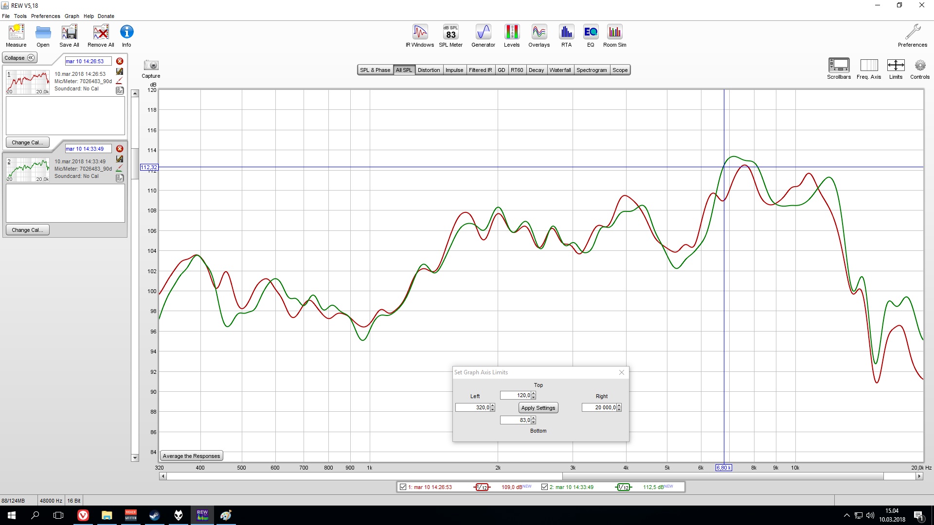

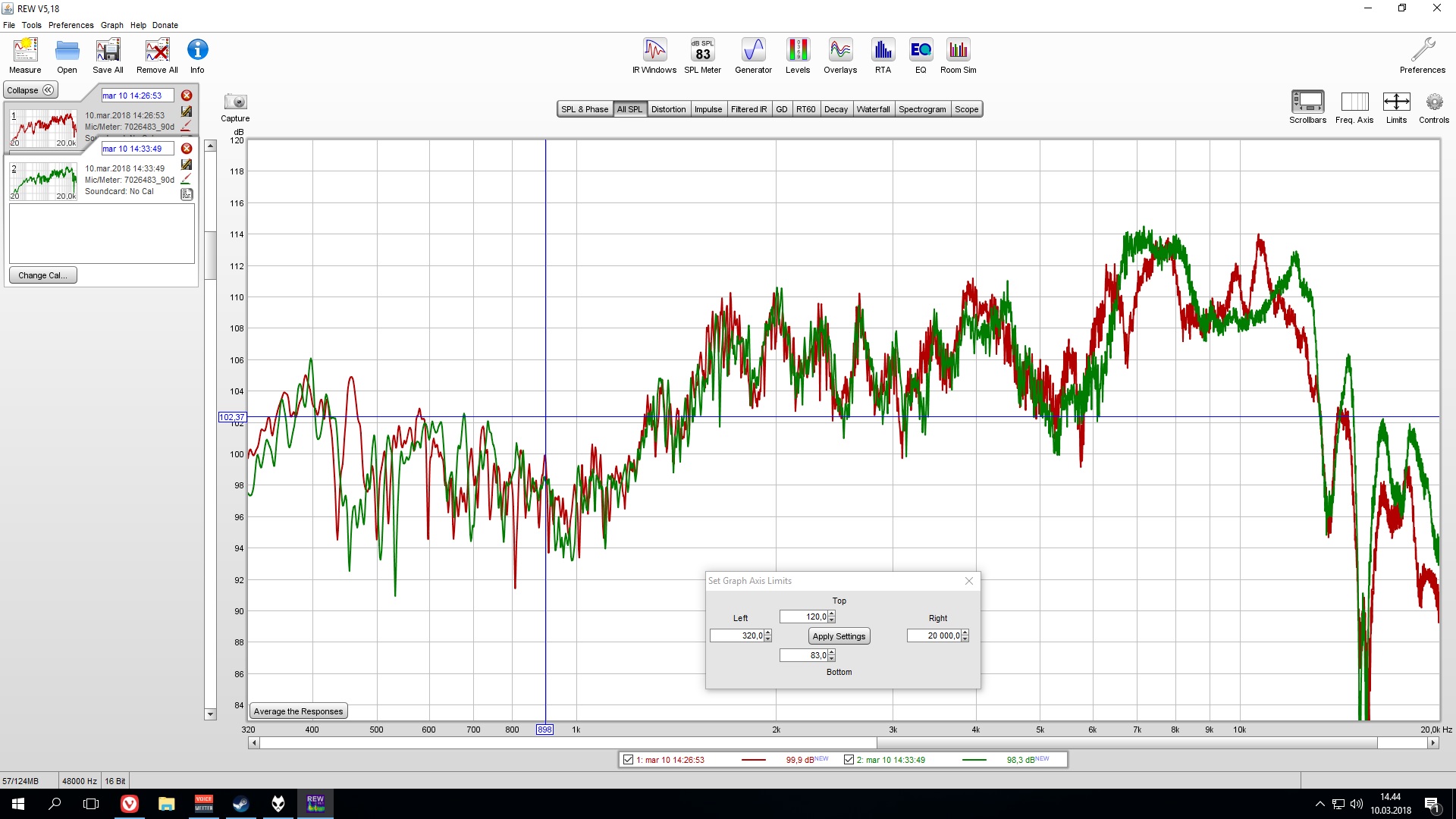

I have not had the time to measure the one driver I used diluted PVA on, but did have to remove the experimental eq that was running. So now the treated one is sans eq the stock one is with eq (-8 or -9 db at 7khz).
Might have time to measure them today.

Here. Measured "quite loud" with the umik positioned 61cm distance from center of cone. Tried firing the speakers into the room, but there is a little bit of disturbance of measurement <900hz
I do not get it, the Treated one "sounds" a lot more mellow, maybe it's the very slightly reduced dip between 5-6khz combined with the small reduction of the peak at 6,8khz that makes all the difference?
RED = with PVA
GREEN - Au naturel
No clue. But that was my contribution for now, gonna play some 'choons!
Edit:
Added one with 1/12th oct smoothing for easier comparison.
Edit2:
Actually, from the factory graph, one might argue that the off-axis of the 15" may be better up top. And per watt, the 15" seems more sensitive up top than the 12". But this is nitpicking.
