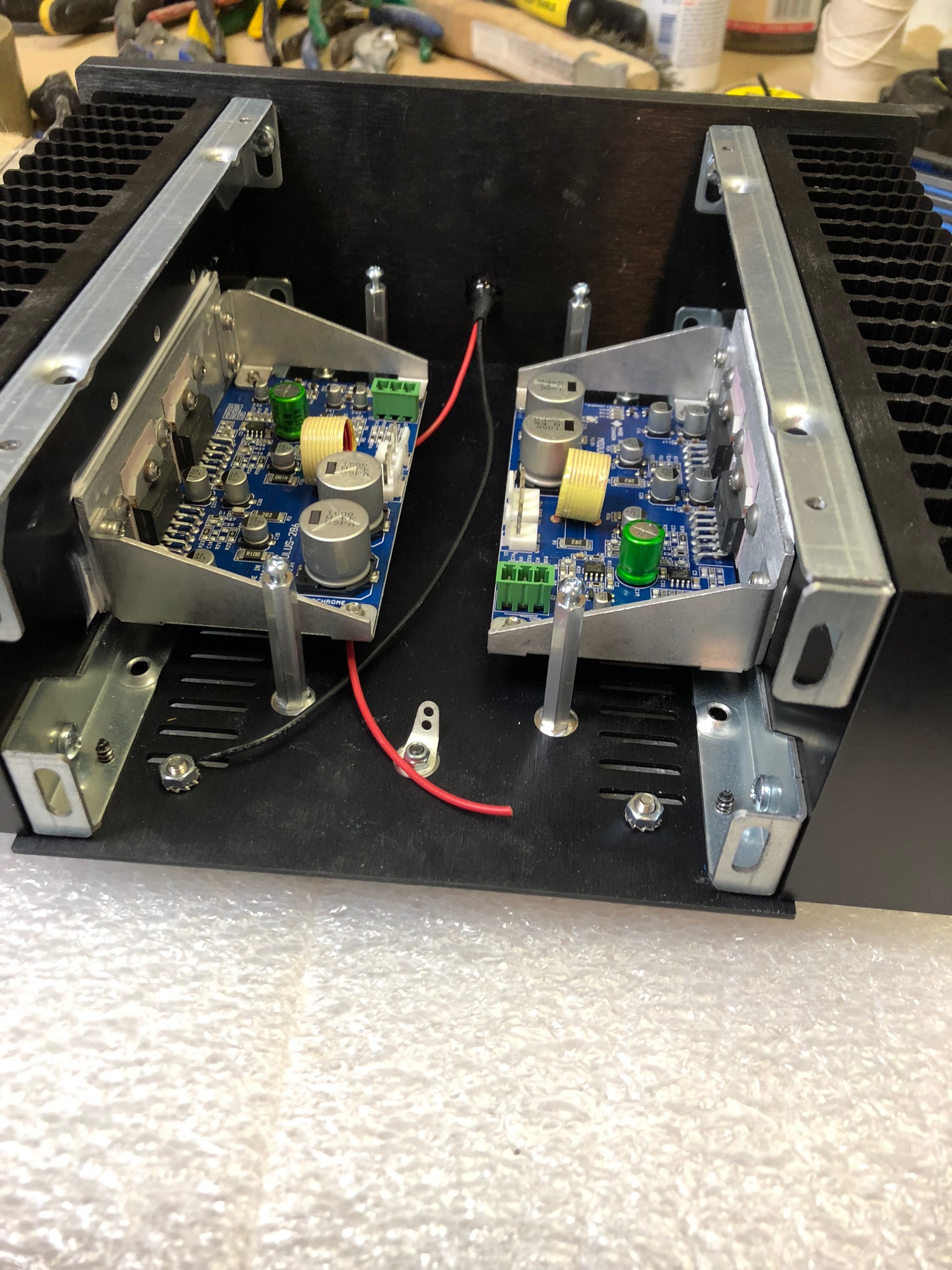

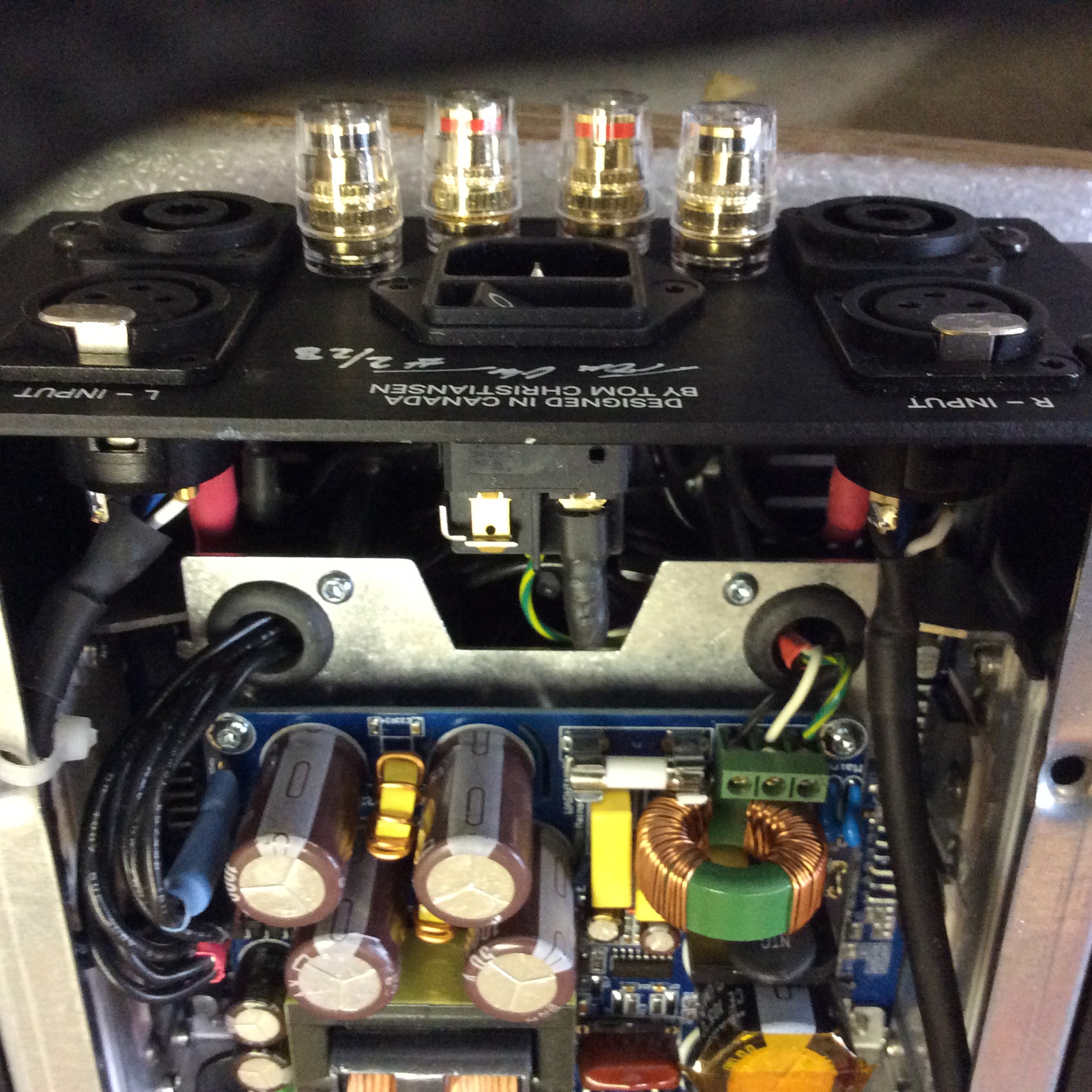

So I got started on my Kit assembly this afternoon, but have already sent Tom a message with couple of questions before I can post any photos that will be more detailed than his own of the mock-up, sans wiring.
The 3D assembly for which Tom elected to keep the chassis width to the minimum is a very tight squeeze indeed, and if all models ship with the same machine screws for mounting amp board modules to heatsinks as mine, you’ll need a log shafted 2.5mm Allen key for those, and #2 Phillips driver for attaching the heat-sink modules to front panel.
A few snapshots

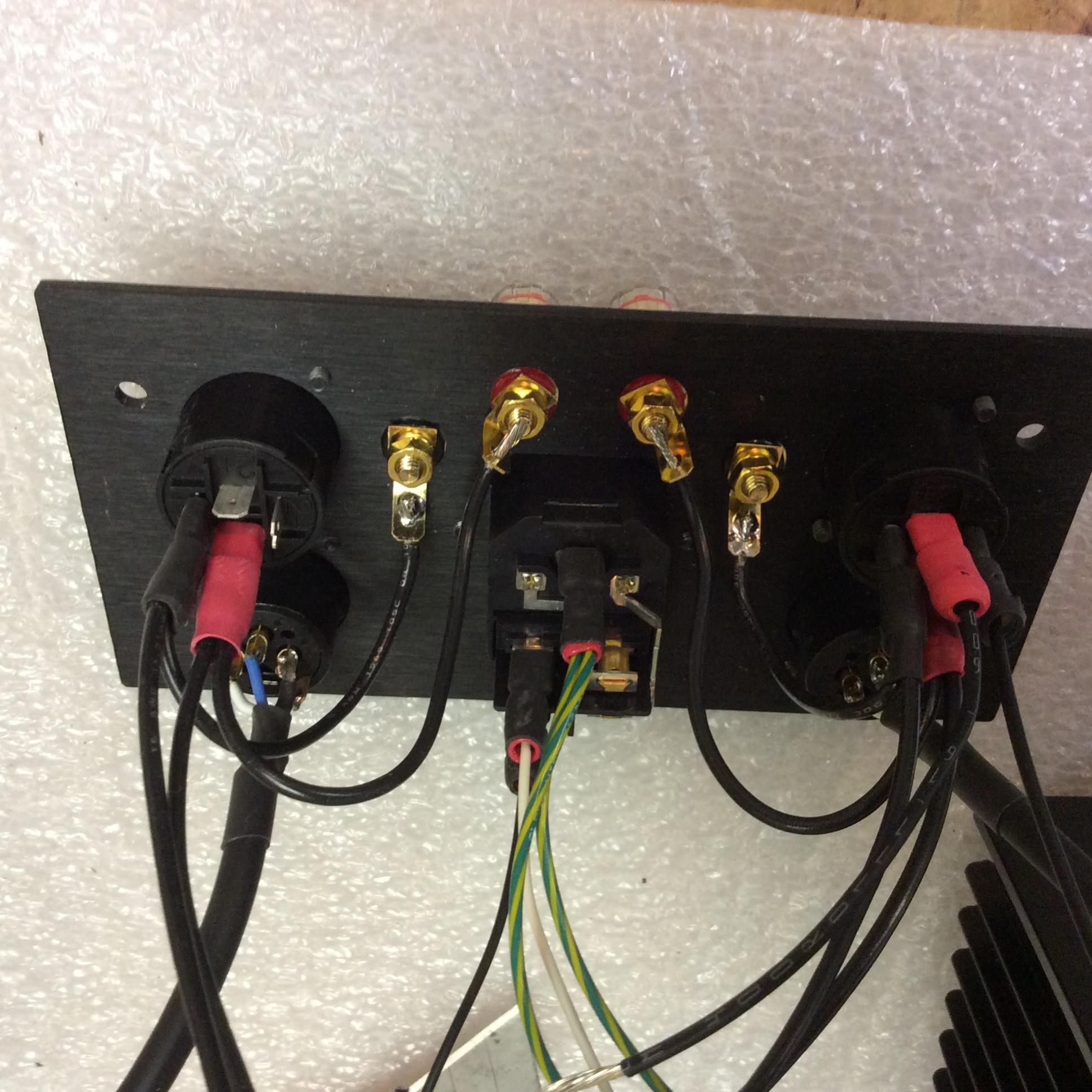

As I mentioned in previous post, very tight fit - particularly area of the PSU wiring harness and speaker wire outputs under the mezzanine.
Rear panel speaker wiring is before connecting jumpers for combined L & R output on 4 pole Speakon.
Hard to estimate total build time a fresh build would require as I had several interruptions, and my chassis came completely assembled, so several of the steps in the preliminary instructions Tom supplied were redundant.
Initial smoke test - none, and DC offset below my cheap meter’s threshold, so now just need to round up some XLR connectors for cabling, then test drive. That’ll be later this afternoon.

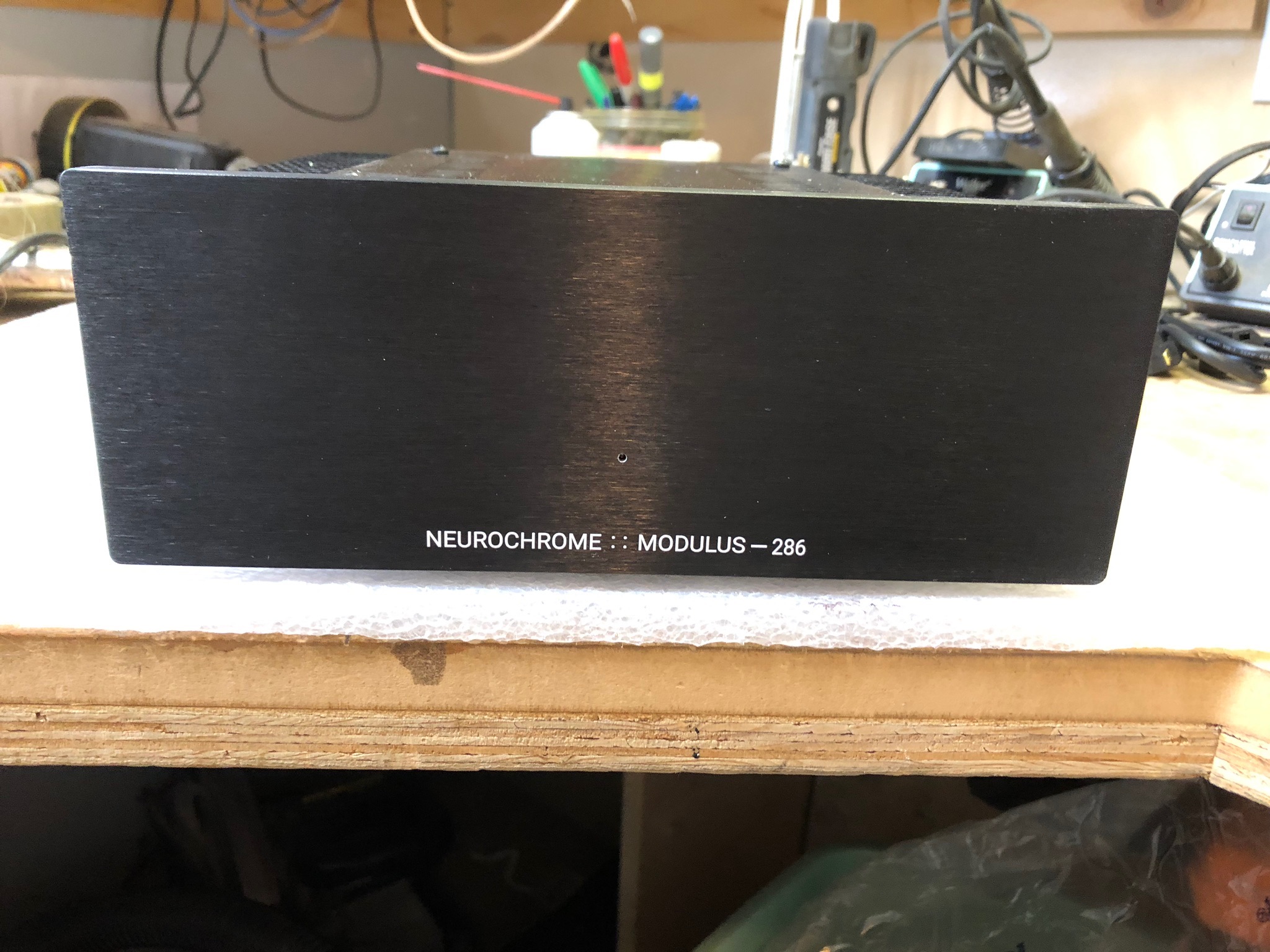

Chris' chassis was the photo model for the pictures of the black chassis on my website. Rather than tearing the chassis down for shipping, I just gave Chris a head start. Everybody else will received the kit as a flat-pack. ModuShop does a superb job at packing these things. You can see their packaging job here.
The front, rear, and bottom panels are assembled first. The LED is epoxied in place in the front, the standoffs and grounding lugs populated on the bottom, and all the connectors are added to the rear. Then the wiring as shown above.
I give all the measurements for how to make the wiring harnesses, so the Kit should come together pretty easily, though the tight squeeze will challenge some I'm sure. You'll need your brain surgeon skills for the assembly. 🙂

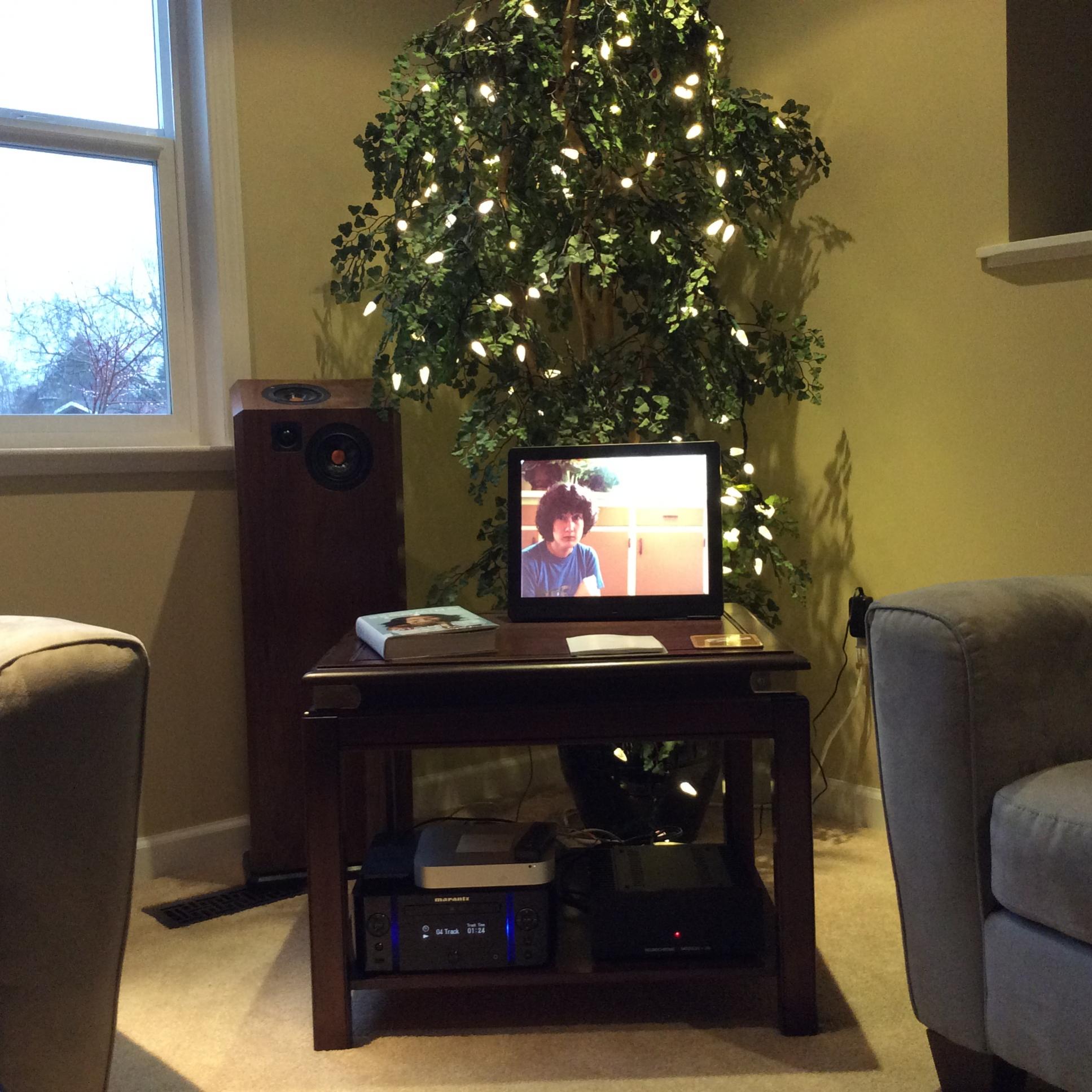

In her natural habitat
Yeah, Tom is good at what he does, and while the 286 sounds big enough for its modest footprint, it ain’t no Tardis.
Just installed in the upstairs system, and makes the amp stage of the Marantz CR611 sound like exactly what it is.
Dead quiet, no warmer than ambient temp at current operating level, very detailed, open, much tighter and deeper bass. Definitely worth the wait.
Got me thinking about what 3@286 & 4@186 might do for the HT rig - nah, that’d be silly.?
