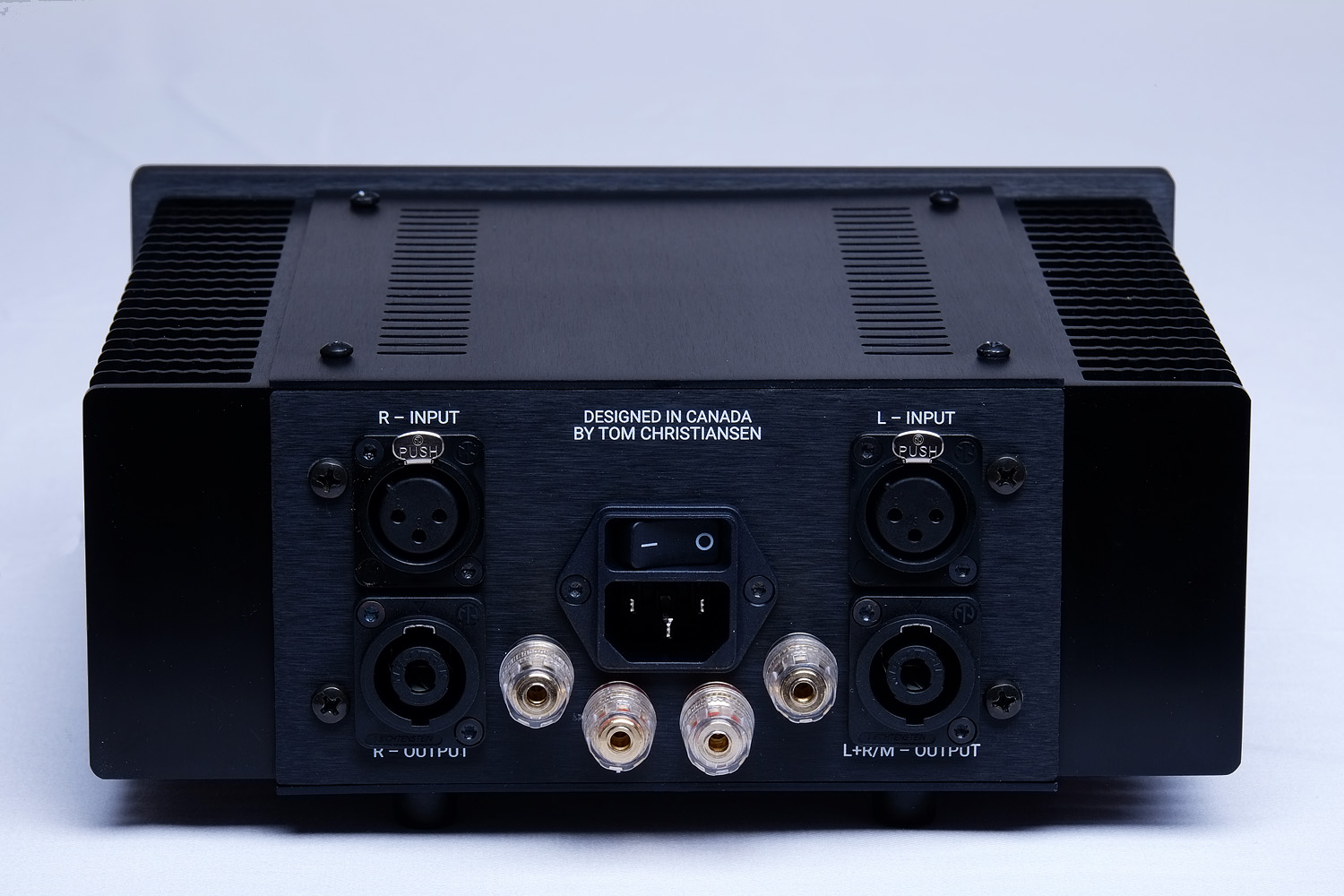

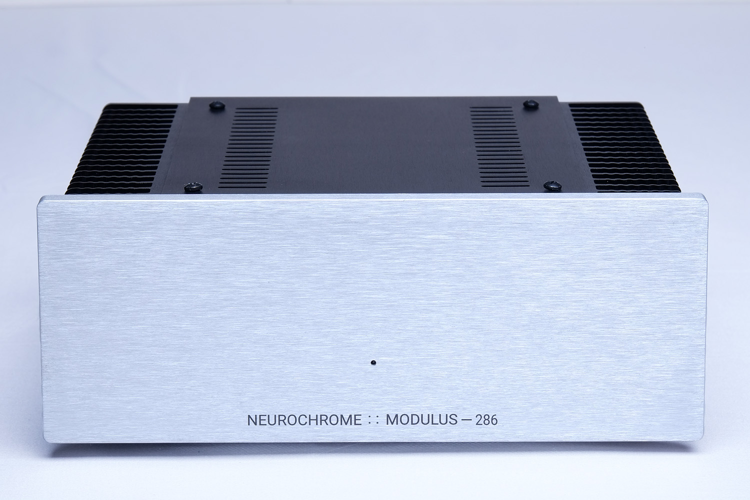

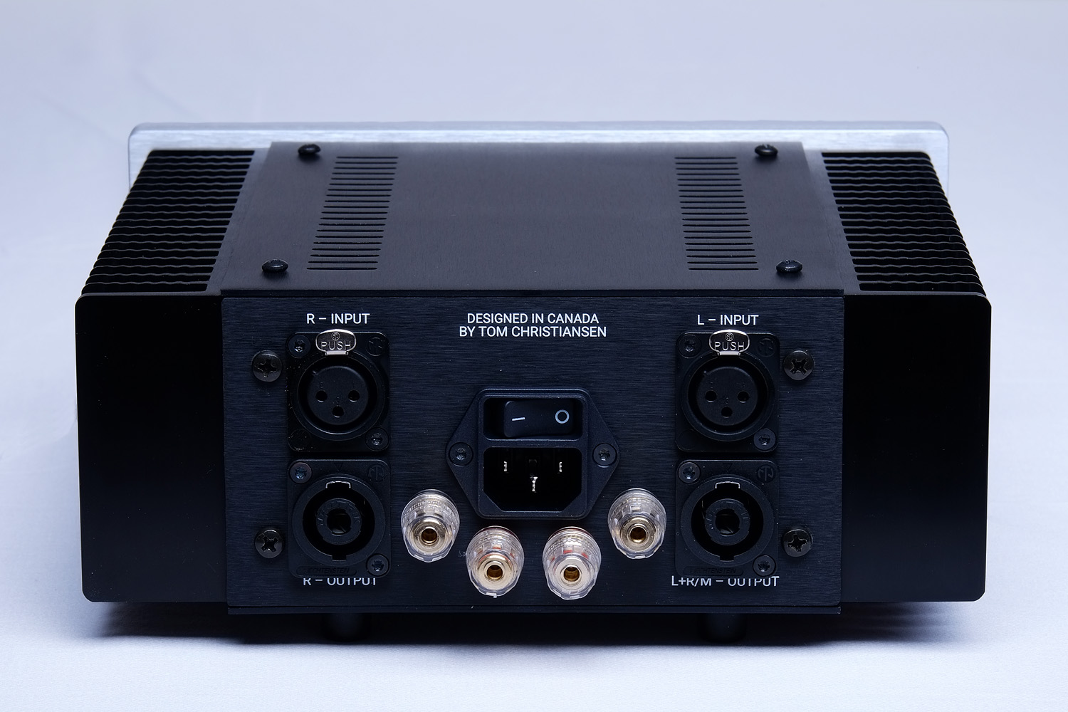

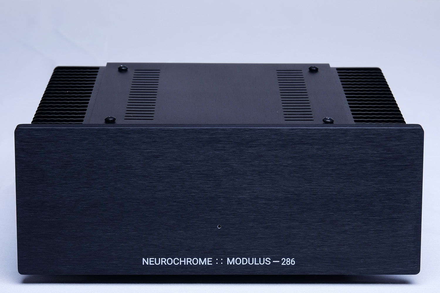

The new front panels have arrived from ModuShop. They're pretty... Attached images show the final version of the chassis.
The ON indicator is a 5 mm LED countersunk into the front panel with a 2 mm hole on the front. The default LED will be a pretty HeNe Red (634 nm). If you'd rather have another colour, just use a different LED. Easy-peasy.
The chassis is available with both clear anodized and black anodized front panels.
I still have a couple left at the $1099 price point. I'll start a Facebook ad campaign on Monday. I suspect the kits that are left at the sale price will go pretty quickly once the campaign starts.
Manufacturing takes 3-4 weeks, so I expect the kits to start shipping just before the new year.
Tom

Ugh! Due to a Christmas shutdown of the anodizing facility, the ship date for the chassis just pushed out to the third week of January. Sadly, this means I won't be able to ship until the end of January.
That said, I think the new chassis will be well worth the wait. The chassis will be anodized after all the machining is done, which means that all exposed holes and edges will be anodized (and dyed if applicable). This is normally something ModuShop charges extra for. This will make a big difference in appearance, especially for the black chassis where even the inside of the hole for the ON indicator will be coloured black.
Pardon the delay.
Tom
