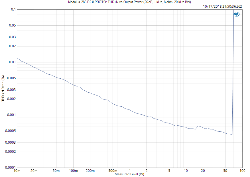

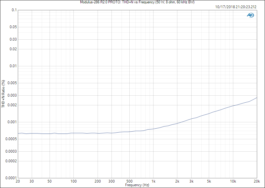

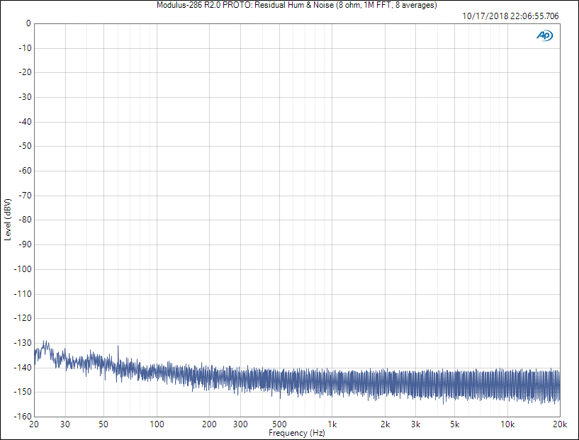

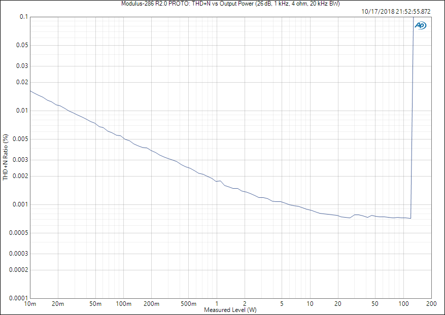

Key features:
- Mono construction.
- 65/125 W into 8/4 Ω, respectively @ THD < -120 dBc.
- Tested for stability with reactive loads up to 1.0 µF || 8 Ω.
- Multi-tone IMD residual: < -100 dBV.
- Damping factor: >560 @ 1 kHz; >225 @ 20 kHz (8 Ω).
- Integrated noise (20 Hz - 20 kHz): 17 µV (A-weighted); 22 µV (unweighted) @ 20 dB gain.
- Integrated noise (20 Hz - 20 kHz): 27 µV (A-weighted); 32 µV (unweighted) @ 26 dB gain.
- Balanced input (can be connected to unbalanced sources as well).
- Default gain: 26 dB for ease of use with other HiFi components. 20 dB available upon request. Higher gain possible by a simple resistor swap.
- Four-layer PCB, fully optimized for the highest performance.
- Designed, manufactured, and assembled in Canada. All components sourced from reputable distributors (Mouser, Digikey, et al.)
- Available for pre-order within the next few days with a significant early adopter discount. Expected in stock by the end of November, 2018, at which point the into sale will end.
Note that attached picture and measurements are of the prototype. I will follow up with a more comprehensive set of measurements once the production version is in.

The Modulus-286 is suitable for 4 Ω operation. It's 2 Ω stable, i.e. will not misbehave or self-destruct if loaded with 2 Ω.
If you limit the supply voltage to ±20 V, you can drive a 2 Ω load. For 2 Ω headphones (there are some wicked ribbon drivers out there), the MOD286 would be a good option. For 2 Ω speakers, I think you'll find the ±20 V to be a limiting factor.
You didn't miss the reactive load measurements. I haven't gotten there yet. Let me get through today (exam tonight), then I'll get those measurements in for you. To start, I look at stability into a reactive load (8 Ω || 1 uF). That AP box looks super cool, though. I'll see if I can get something similar going. It won't happen right away, but it's something that's been on the back burner for a while. Stereophile publishes a frequency sweep with a simulated speaker load that I'd like to reproduce also.
You can find the THD+N vs power and THD+N vs frequency for 4 Ω in Post #1.

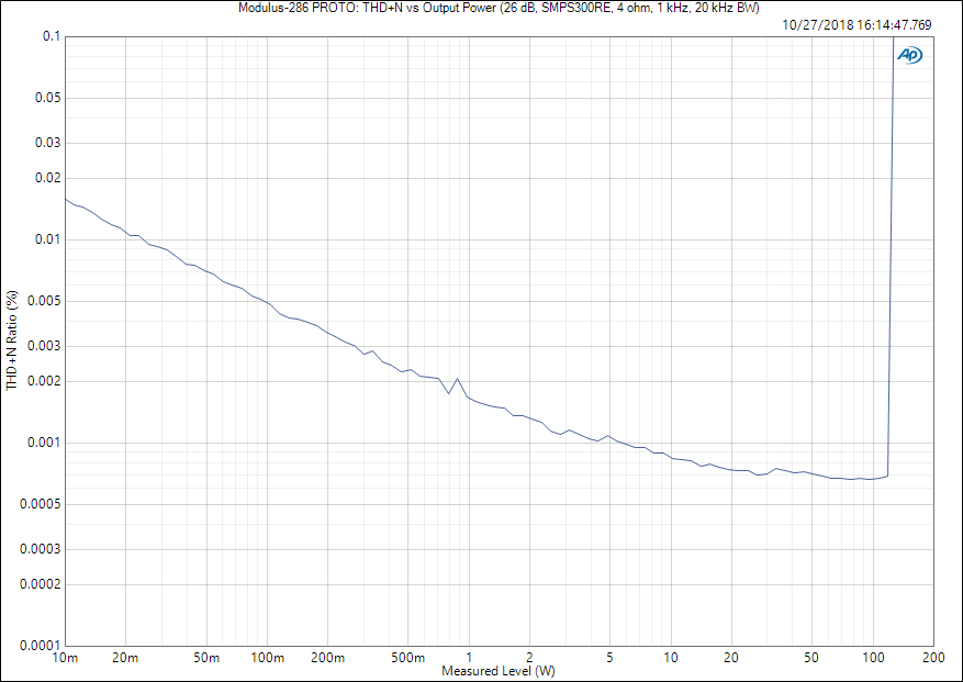

The Modulus-286 Kit is shaping up. The Connex SMPS300RE power supply is a good match for a stereo pair of Modulus-286. That'll allow me to specify:
2 x 65 W into 8 Ω
2 x 125 W into 4 Ω
1 x 140 W into 8 Ω (bridged mono)
The amp is stable into 2 Ω, but I don't recommend driving 2 Ω loads with the MOD286 as it'll overheat rather quickly. There's no way around physics. Sorry. 🙂
The 140 W in bridged mode is limited by the output current of the SMPS300RE power supply. On a beefier supply, the Modulus-286 will deliver 240 W into 8 Ω. With the kit, I'm aiming for an affordable small package, hence have settled on the SMPS300RE and the smallest ModuShop 2U Mini Dissipante.
Observant readers will note that the THD+N vs output power for bridged mode goes past 200 W. That's at 1 kHz, where the on-board supply capacitance provide the peak current. At 20 Hz, where the SMPS300RE will have to sustain the peak current for longer, the supply starts to brown out around 140 W, hence, I spec the amp for that.
Note that in bridged mono, the gain of the amp is 32 dB in the default configuration with each MOD286 providing 26 dB gain. If you configure the modules for 20 dB gain (pluck a resistor off the board), you can get 26 dB gain (and a bit lower noise floor) in bridge mode.

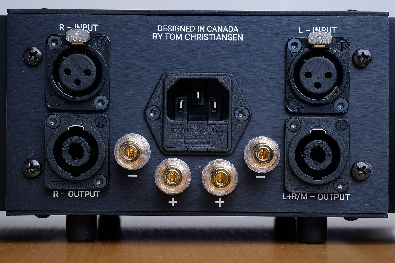

It fits! Now I "just" need the wiring. The power supply is a Connex SMPS300RE in ±36 V. For the production kit I am getting a custom version of the supply made with 25 mm tall supply caps. That'll allow the supply to fit in the chassis and leave enough clearance to the chassis to meet electrical safety requirements.
In the first picture, I included the cover for Mark Knopfler's latest album. Yes. It's a CD! That gives you an idea of how small this amp is.
The outputs are Neutrik speakON and binding posts. The binding post are placed 3/4" (19.05 mm) centre-to-centre, thus allows for the use of banana plug adapters - even for balanced operation where the output is taken from the two "+" terminals.
This amp will provide 2x125 W into 4 Ω (2x65 W into 8 Ω). 1x140 W into 8 Ω if you bridge the two channels. Bridged operation into 4 Ω is not recommended.
The amp weighs in at 3100 g. 🙂
