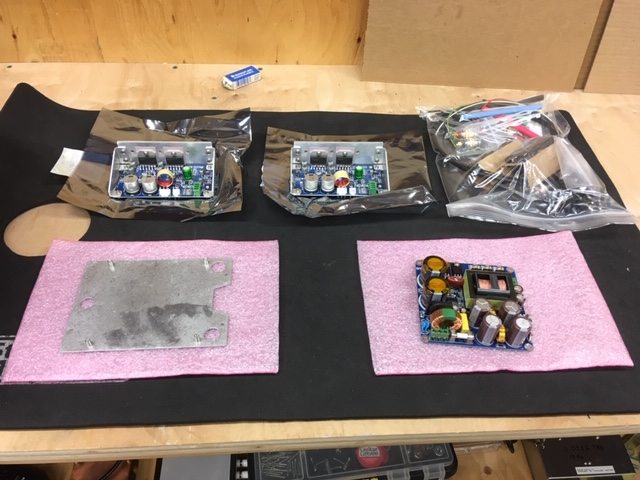

Hi folks,

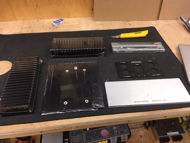

When you open the box, you are rewarded with two more: One with the box (er, I mean enclosure 🙂) and one with Tom's stuff.

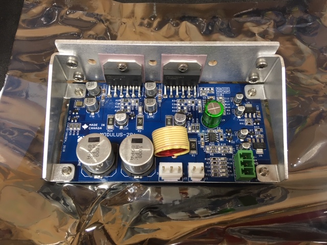

Tom's stuff includes two modules, the switching power supply, and a bag of goodies. Speaking of the modules, they are pretty impressive. Mechanically they are very solid and look like they will be easy to mount - having just one mounting surface (the heatsink) very much simplifies the mechanical design. They are also well laid out and assembled - they are quality looking boards. Here's some photos:

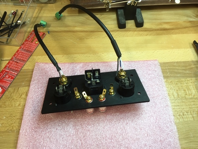

Gentlemen,

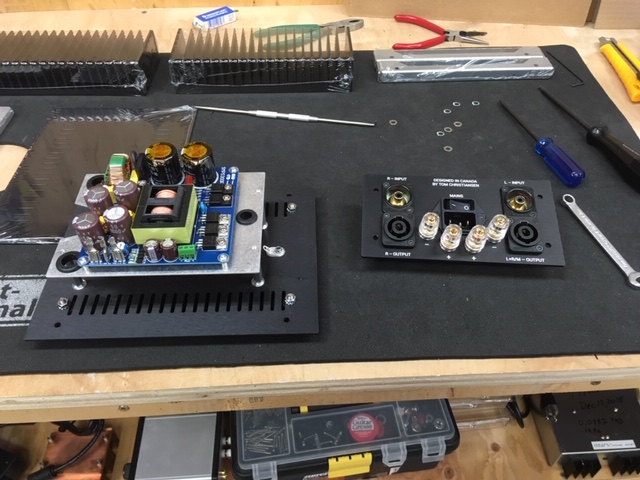

The HiFi-2000 metalwork is top-shelf as always. As you likely know, Tom is a big fan of Torx screws. This didn't pose a problem for me as I've got a collection of Torx screwdrivers ... until I got to the ones that hold the standoffs to the bottom. These are Torx T8 screws, which I didn't have a screwdriver for! A quick trip to canadian tire solved that little problem. You might want to check your collection for the smaller drivers.

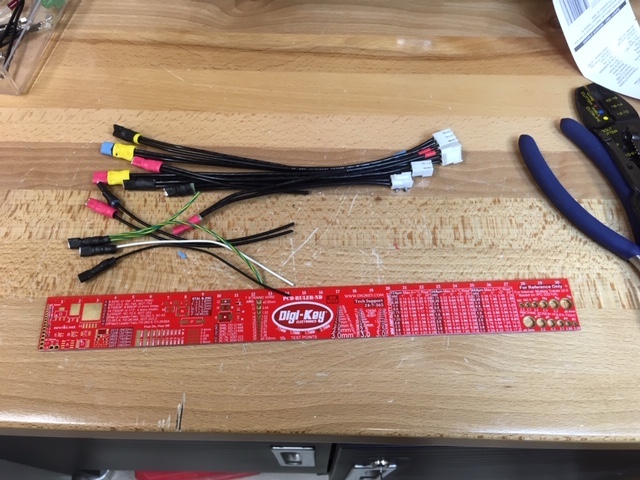

The wiring harness had very clear instructions and I had no problem. Actually I lie - I managed to use the wrong 'yellow' crimp connectors for the wrong part of the harness. oops. I had some spare ones, so no issue - but please confirm the exact size of your connectors before you attach them.
Back plate inputs are connected and wired. Yes I am an unbalanced individual.

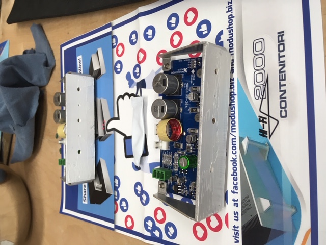

Here's the modules with the thermal compound. I can't say enough about the mechanical design of these modules. The physical aspects of them are great - it's a clever design.

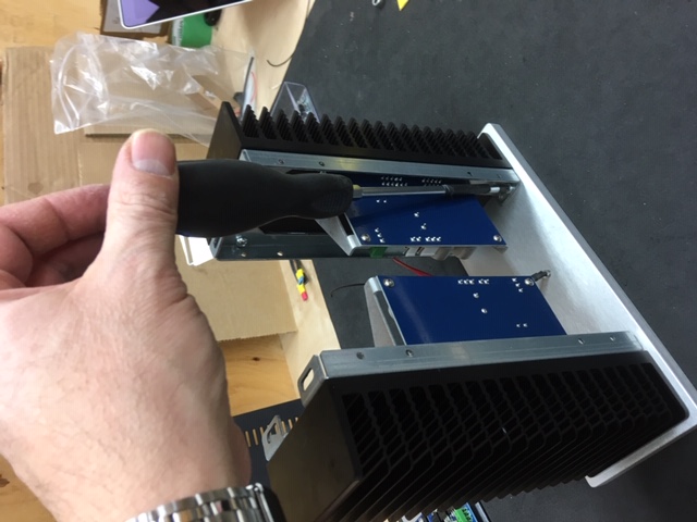

The instructions said to assemble the heatsinks to the face plate, then attach the modules to the heatsinks afterwards. I found this to be impossible to do because my Torx drivers don't allow you to work at an angle. Instead, I attached the modules to the heatsinks then attached the heatsinks to the front plate.
We're getting there!

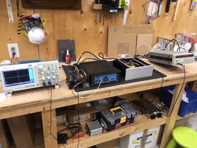

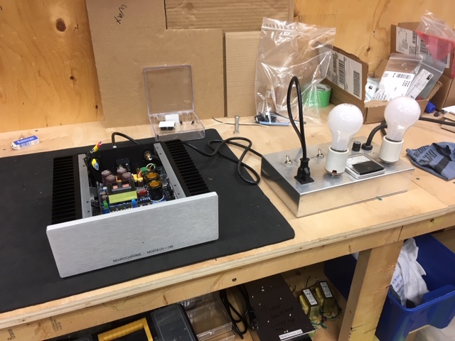

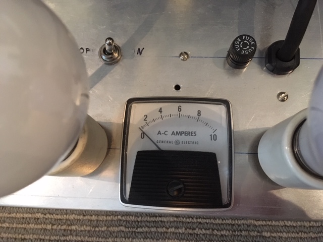

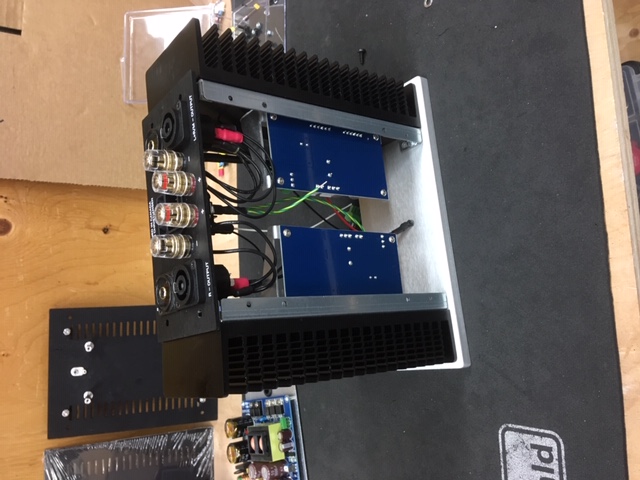

The amp is together and alive. here's some shots. I found that the best way to get the back plate on was to first screw on the bottom plate to pull the heatsinks in the proper position, then attach the back plate. Tom says in the instructions that this is the most challenging part of the build. He is right!
I brought up the unit on the dim-bulb tester. This thing has saved my *** on more than one occasion. After making sure that the rail voltage was right, I attached a signal generator, dummy load, and a scope.
Looks like there's a signwave on the scope! More testing in a bit.

Torx screws: Yeah. I like 'em. The bits don't slip and scratch up your chassis unlike Philips screws. The Torx bits deliver good torque to the screws. I think the black screws are actually Torx-Plus, so even better than Torx. Thankfully, you can use a regular Torx driver with them.
If I recall correctly, the kit requires: T-8, T-10, 2.5 mm hex, and Philips #2 to assemble. At least I meant to include screws with 2.5 mm socket heads for the amp modules (M4 x 6 mm) as I figured more people would have a 2.5 mm hex key than a stubby T-10. From your description it sounds like they might have been Torx. With Torx you can always use an SAE hex key. I think it's a 3/32" that fits in a T-10. You can also get Torx keys that are shaped like hex keys (if that sentence makes any sense).

hey what's that red digikey board? looks like a board to measure stuff or bend passives? have a link for it?
thank you
It's a Digikey ruler that they sent out as a freebee sometime this past year. P/N: PCB-RULER-ND
I don't think it's useful for bending passives, but for figuring out hole sizes and such, it's semi-useful. Mine lives on my desk and I use it occasionally when designing PCBs.
Tom
Tom
thank you! is there anything useful or that you can recommend to bend the passives? or the term to look for it myself. thank you again

BTW, I've done some more testing, and here's what I found:
1 - Tom's power output figures for the modules are accurate 🙂. I pulled 67 watts RMS into 8 ohms before clipping with my unit.
2 - On attempting to measure the THD, I found that I could not measure anything above the noise floor of the signal generator! This means that a) Tom's design is pretty linear and b) my signal generator sucks. I used to have access to an AP at my old work, but sadly now have to rely on older stuff that I can afford...

Needle nose pliers? Honestly, I've been at it so long that my hands are calibrated for bending resistors to 0.4" lead spacing. I do it by feel.

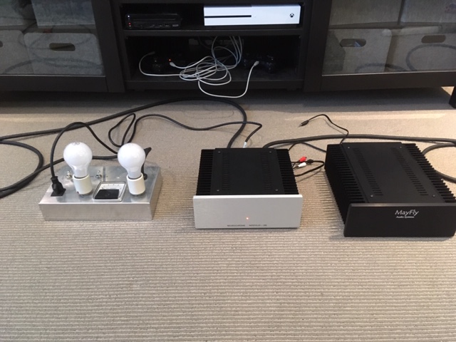

Folks,

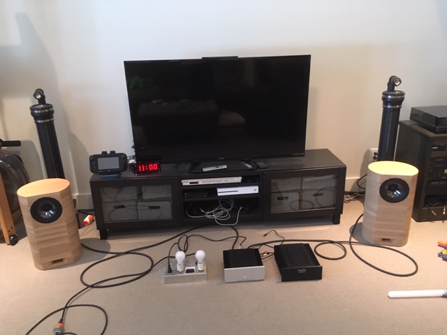

Had a chance to have a good listen to the amp and do some comparisons. Here's what I found:
1 - the amp is dead quiet. There was no discernible hum or hiss coming from the speakers.
2 - on listening, everything sounds as it should. I'm personally not a big fan of subjective listening tests because there is so much that can bias them, but I will say that there are no defects that I can hear. No distortion, no strange phase stuff, full frequency response, 'sounds good to me' sound stage, etc, etc. Thumbs up from the sitting on the couch and cranking the tunes department.
3 - when running the amp does not use much power. It would not even deflect the needle on the current meter. Stays cool as well.
4 - A direct comparison to a fairly pedestrian LM3886 amp of my own design showed that the two amps sounded pretty much the same. Now I must point out that I can measure THD in my design, but I cannot with Tom's. That is saying something. Also my design is larger, heavier, and about 25 watts down on power 🙂.
Here's some pics: Note the Linkwitz Plutos in the background (which are why I'm into LM3886s in the first place!)
In terms of accessing tricky screws I find two extreme approaches useful.
I have a large set of 1/4" hex bits (they're cheap...) and use EITHER a driver plus a 12" extender bar (which stops the handle of the driver fouling) OR a tiny ratchet.
Screwdriver Bit / Hex / Adaptor / Power Bit Extension (300mm) Magnetic TE441: Amazon.co.uk: DIY & Tools
DRAPER 17 PIECE OFFSET RATCHET SCREW AND SOCKET DRIVER SET(DRAPER 811SXA): Amazon.co.uk: DIY & Tools
These get you "most places" (at least in my experience to date)
