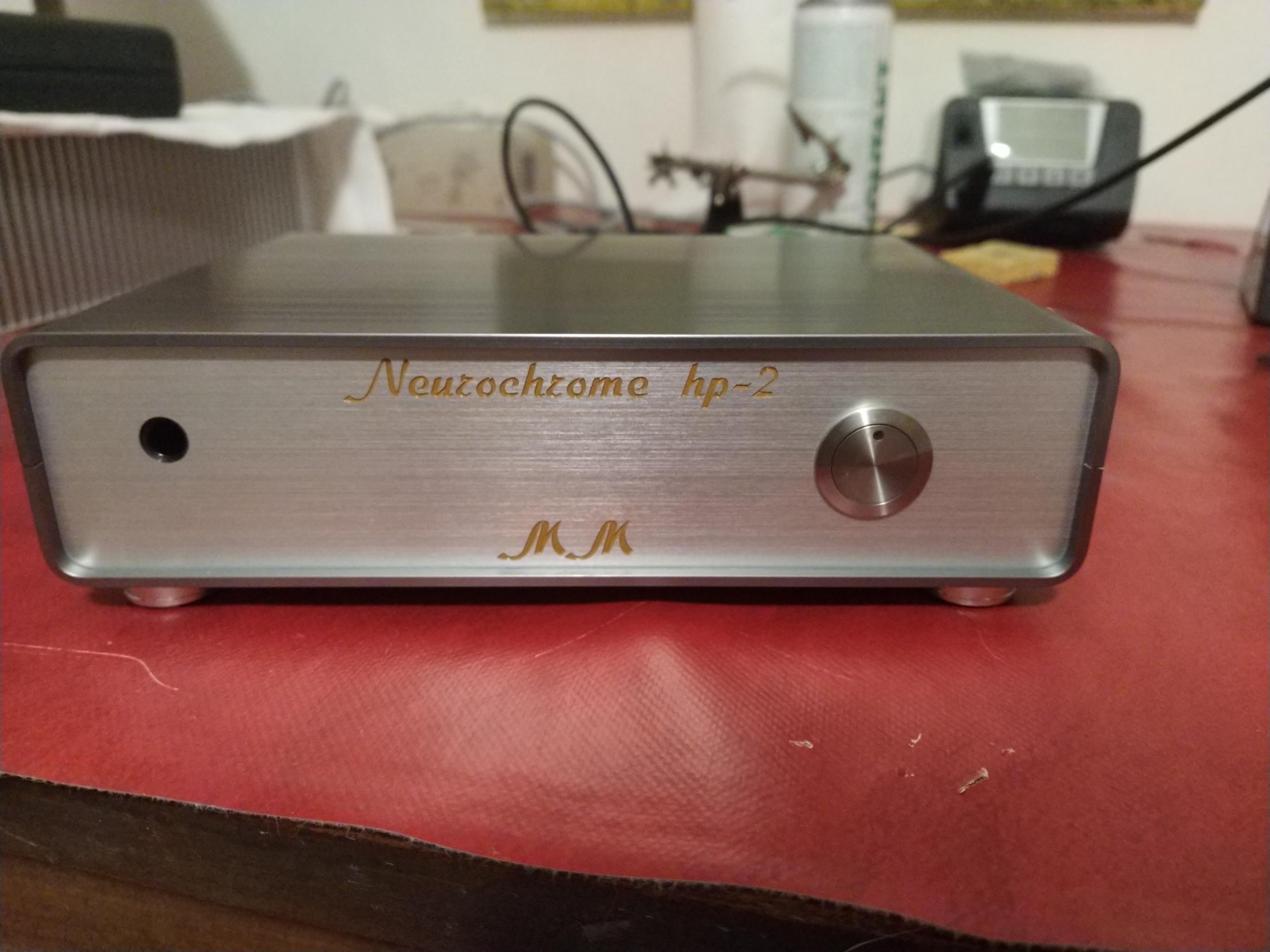

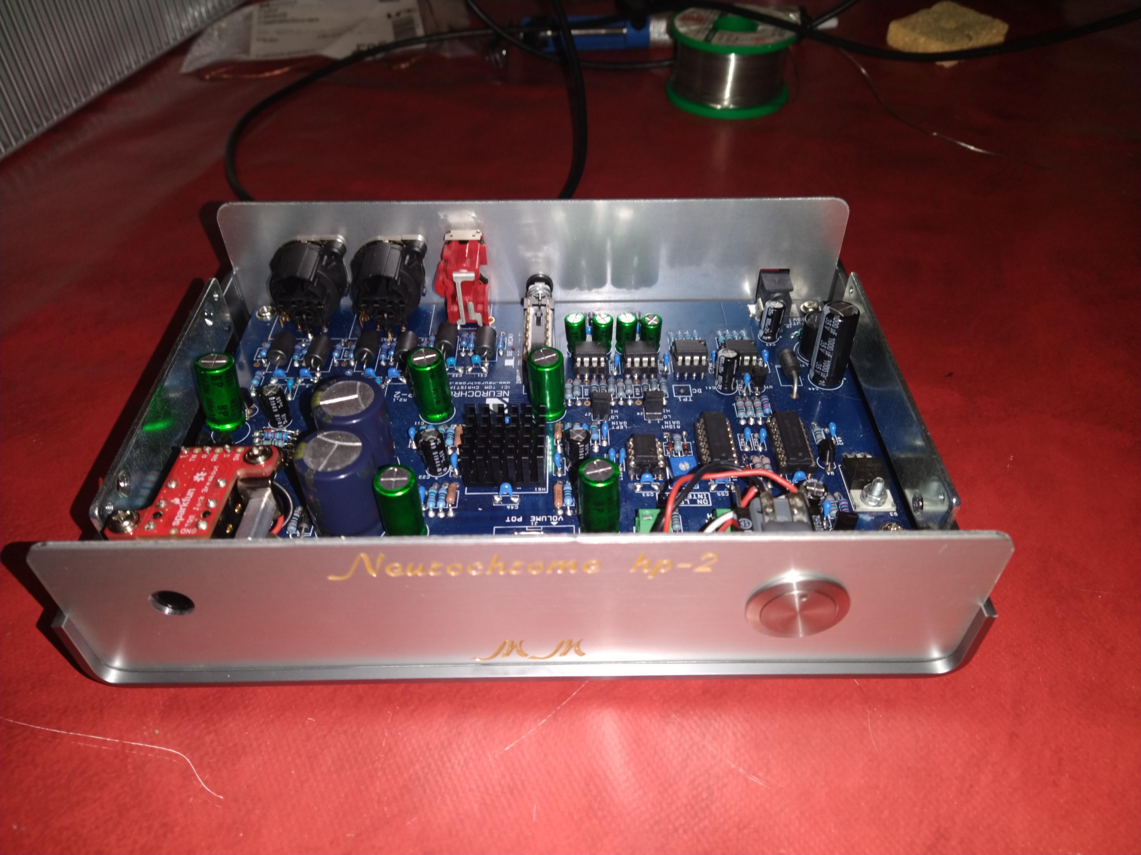

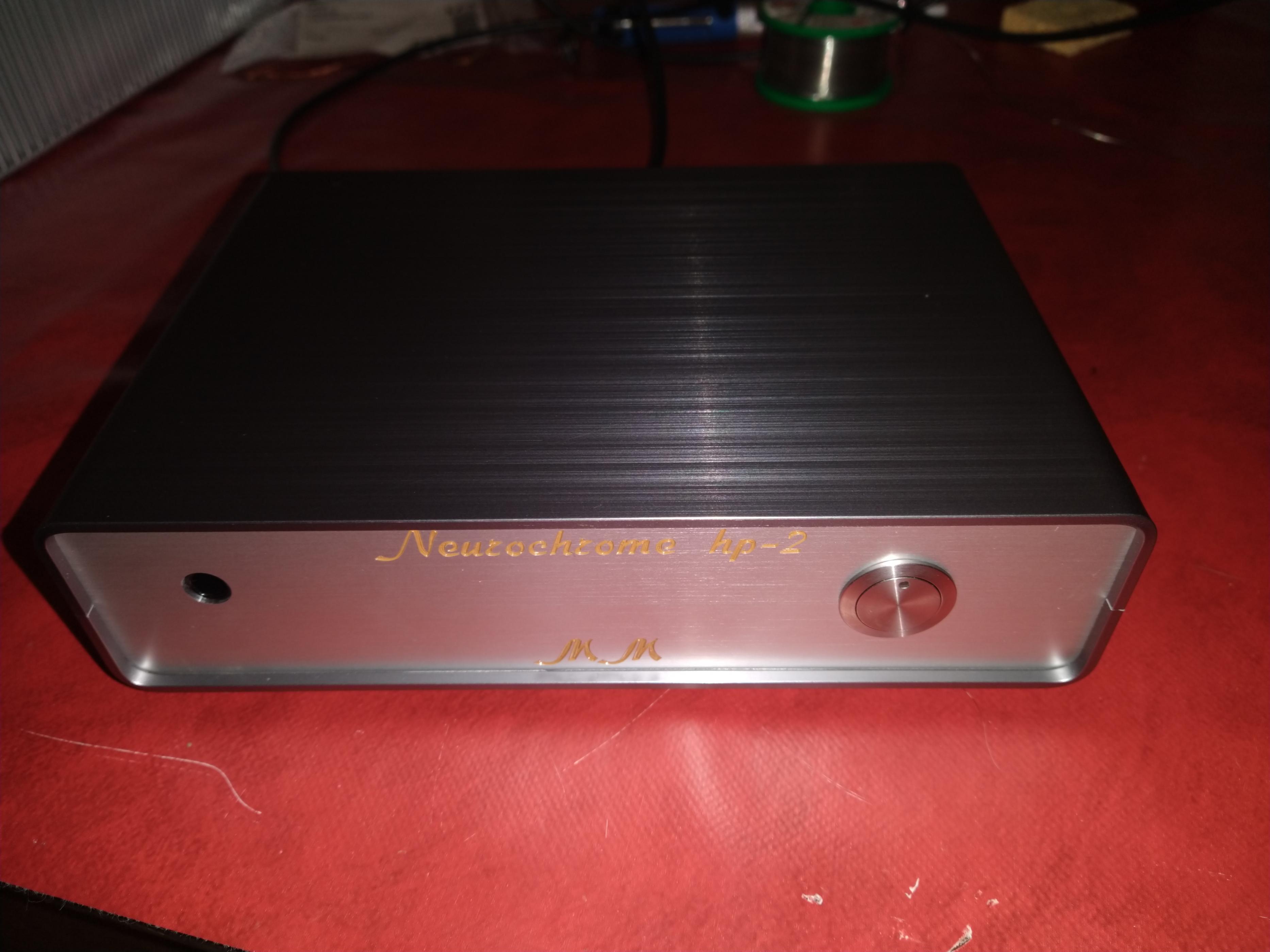

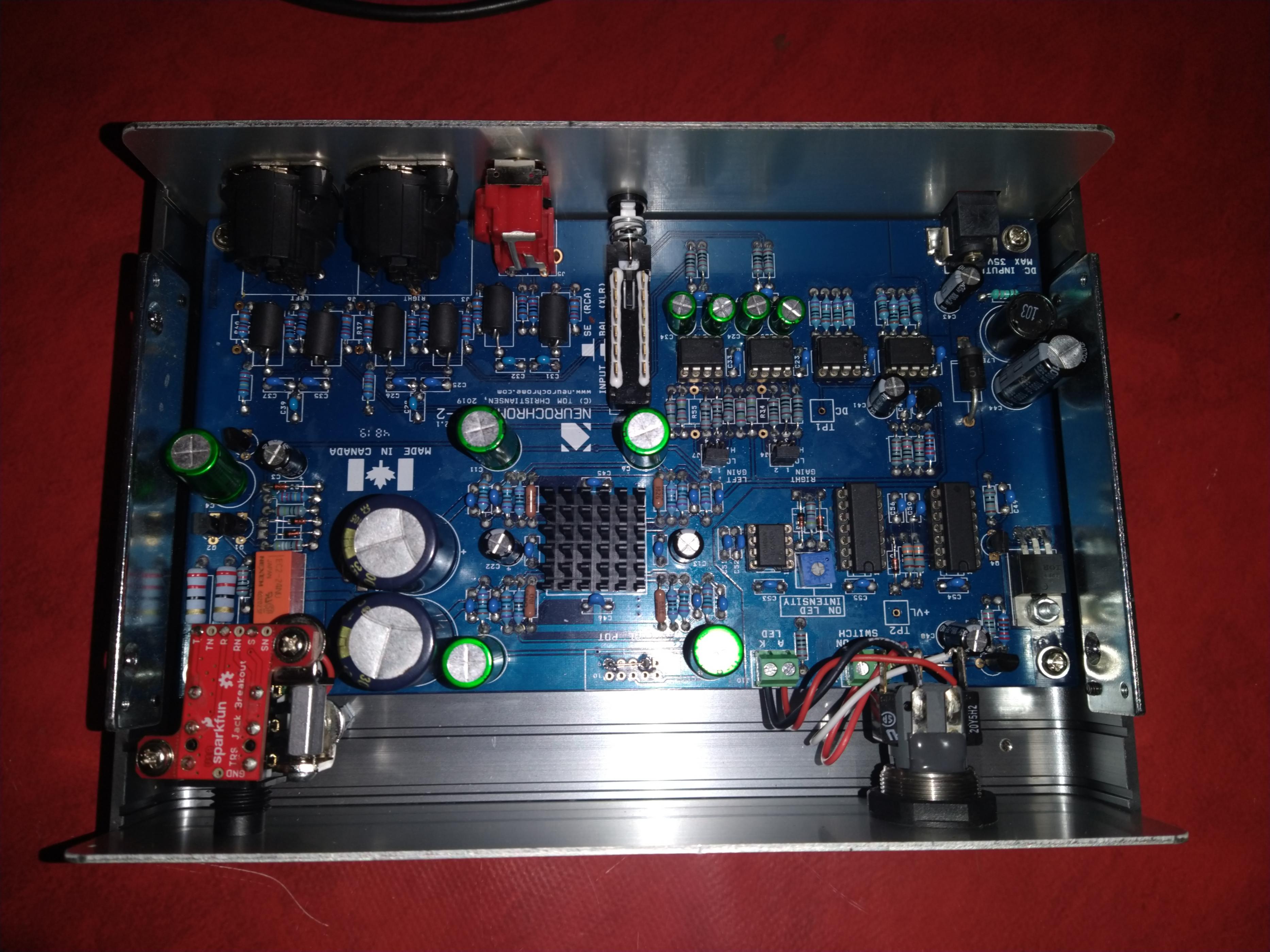

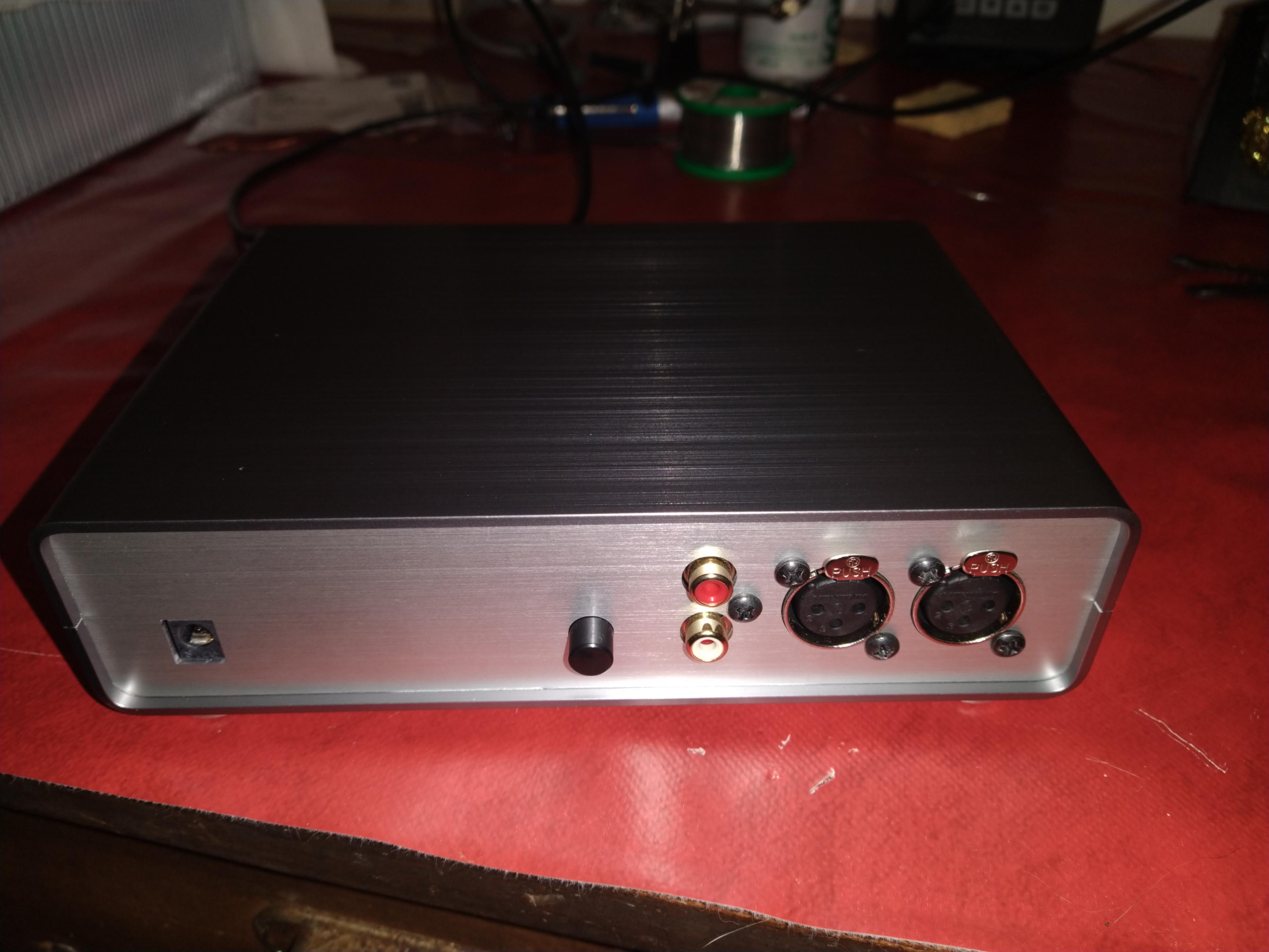

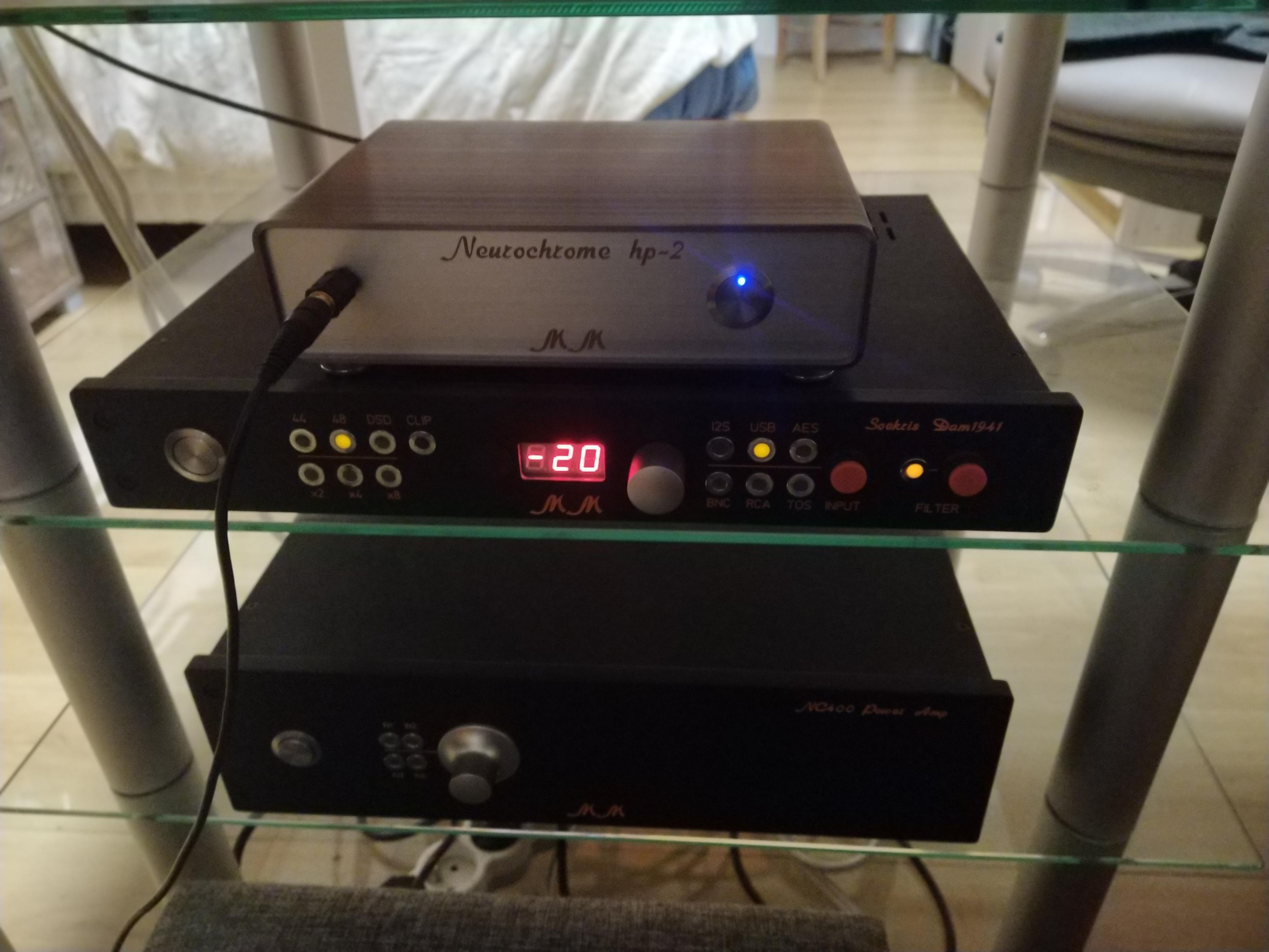

Hello Tom,

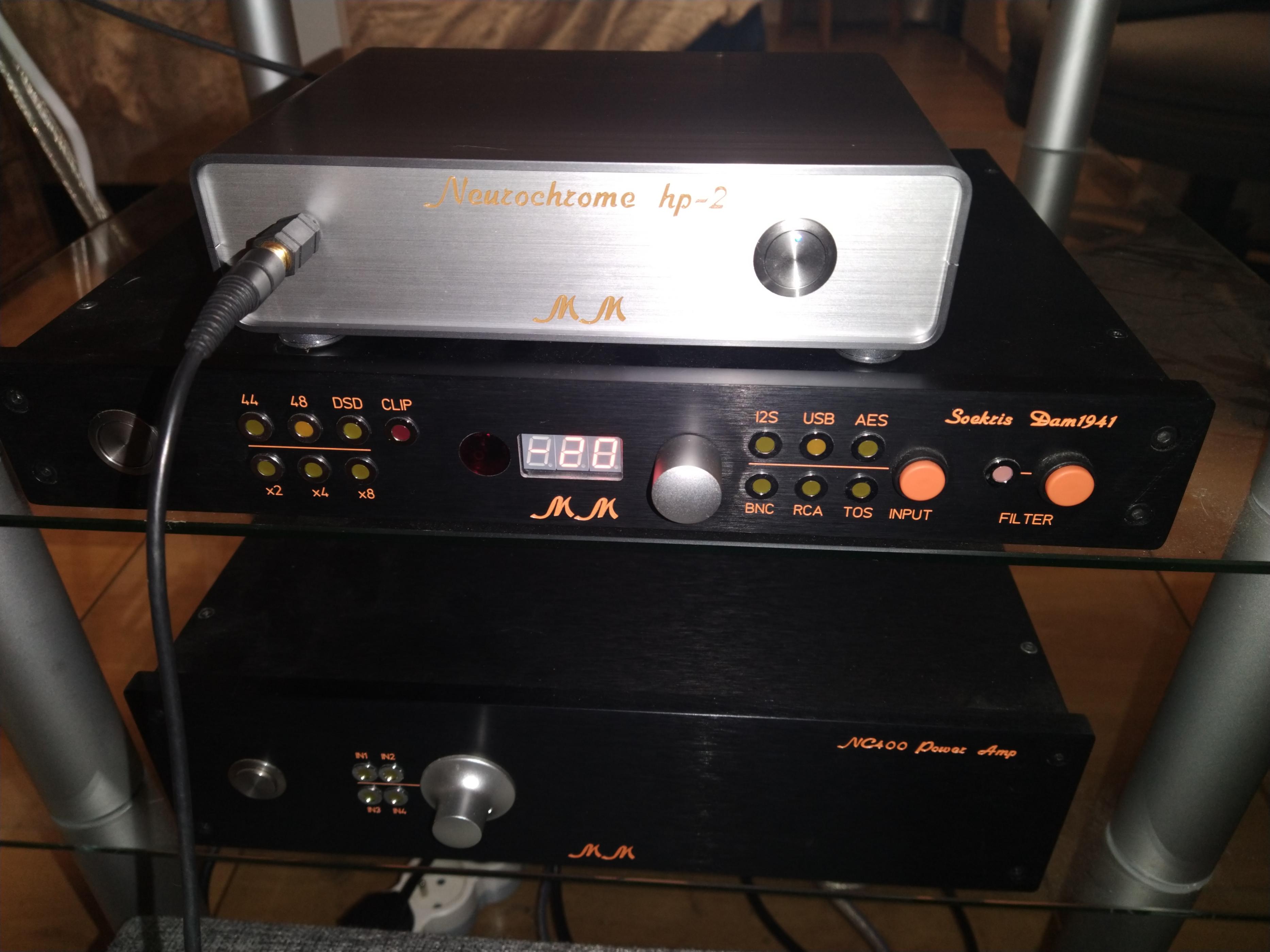

Hope you are right. I finally finish my hp-2 build. I have the pcb finished for a long time, but the final build was delay several time... I finish it today and i am happy with result, both aesthetically and sonically. Now i need better headphone, my akg k702 are destroying my ears 😡
Some photos, the last one with my soekris dam1941 and ncore.
