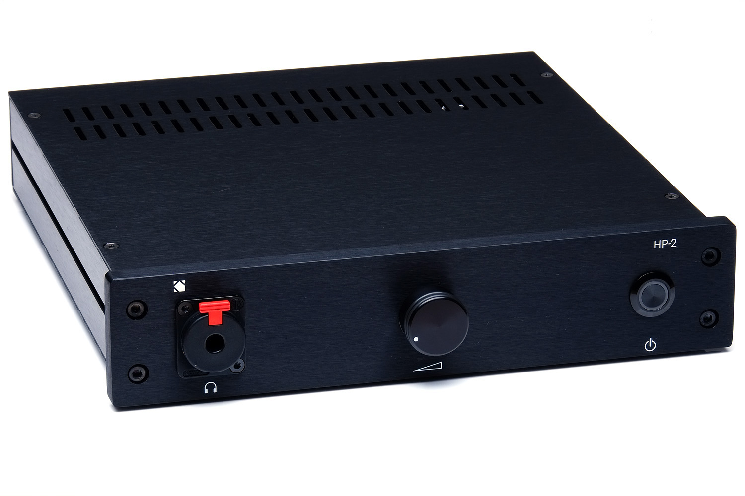

Key features of the HP-2:

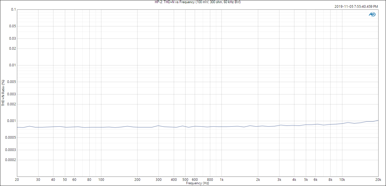

- 4-layer PCB fully optimized for performance while being relatively easy to assemble.
- Output power: 440 mW (32 Ω), 660 mW (50 Ω), 260 mW (300 Ω) at vanishingly low distortion.

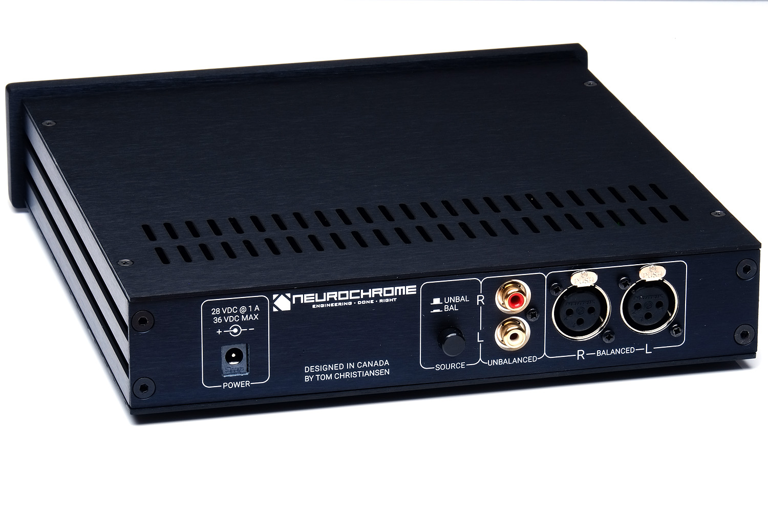

- Inputs: Balanced/differential (XLR) and unbalanced/single-ended (RCA).
- Alps "Blue Velvet" volume potentiometer.
- +5 dB and +15 dB gain settings (jumper selectable).
- Integrated headphone protection circuit, which disconnects your headphones in the case of DC voltage on the output of the amplifier.
- Integrated output muting circuit ensures that the HP-2 is completely absent of turn-on and turn-off clicks and pops.
- Optimized on-board RLC power supply filter allowing for stellar performance with the recommended switching power supply.
- External 28 VDC switching power supply accepting 85 – 264 VAC mains for use world wide.
- The PCB features elaborate use of planes and copper pours to maximize circuit performance by minimizing supply and ground impedances.
- On-board EMI/RFI input filter to prevent wifi and switch transients from interfering with the sound reproduction.
- With the exception of two SOIC-08 surface mounted ICs, the HP-2 is all through-hole construction with socketed ICs and is easy to solder.
- Bill-of-materials includes a Mouser Electronics Project Link for ease of parts ordering.
- Gold plated PCB, fully electrically tested by the manufacturer.
- PCB is designed and manufactured in Canada.
- Custom designed chassis manufactured in Italy.

- Output power: 440 mW (32 Ω); 660 mW (50 Ω); 260 mW (300 Ω)
- THD: < -130 dBc (50 mW, 300 Ω)
- Multi-tone IMD residual: -144 dBr (AP 32-tone, ref. 100 mW, 300 Ω)
- Output noise: 1.0 µV RMS (A-wt, 20 Hz - 20 kHz)
- Dynamic range: 125 dB
- Gain: +5 dB, +15 dB (jumper selectable)
- Input sensitivity: 2.90 V, 865 mW (gains +5 dB, +15 dB, respectively; 100 mW, 300 Ω)

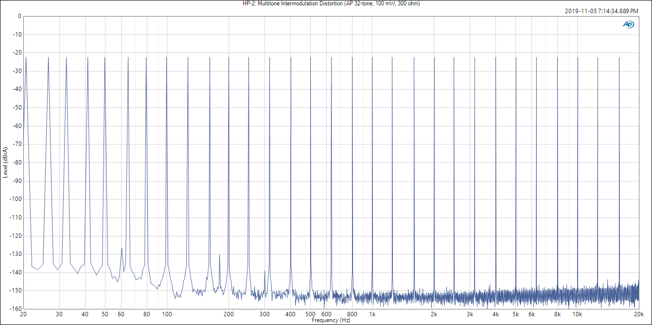

HP-2_ Multitone Intermodulation Distortion (AP 32-tone, 100 mW, 300 ohm).PNG95.8 KB · Views: 340

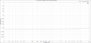

HP-2_ THD+N vs Frequency (100 mW, 300 ohm, 60 kHz BW).PNG46.1 KB · Views: 341

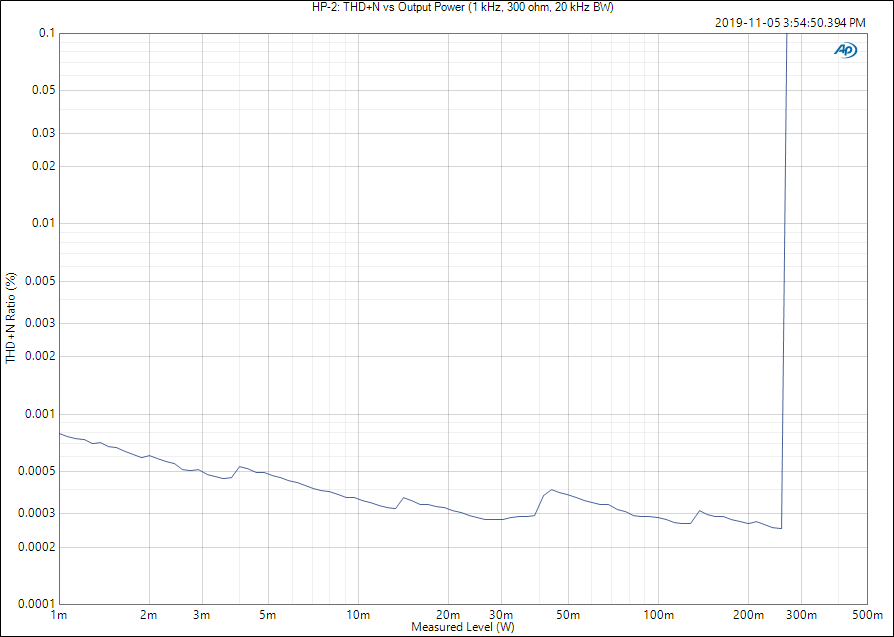

HP-2_ THD+N vs Output Power (1 kHz, 300 ohm, 20 kHz BW).png39.1 KB · Views: 468

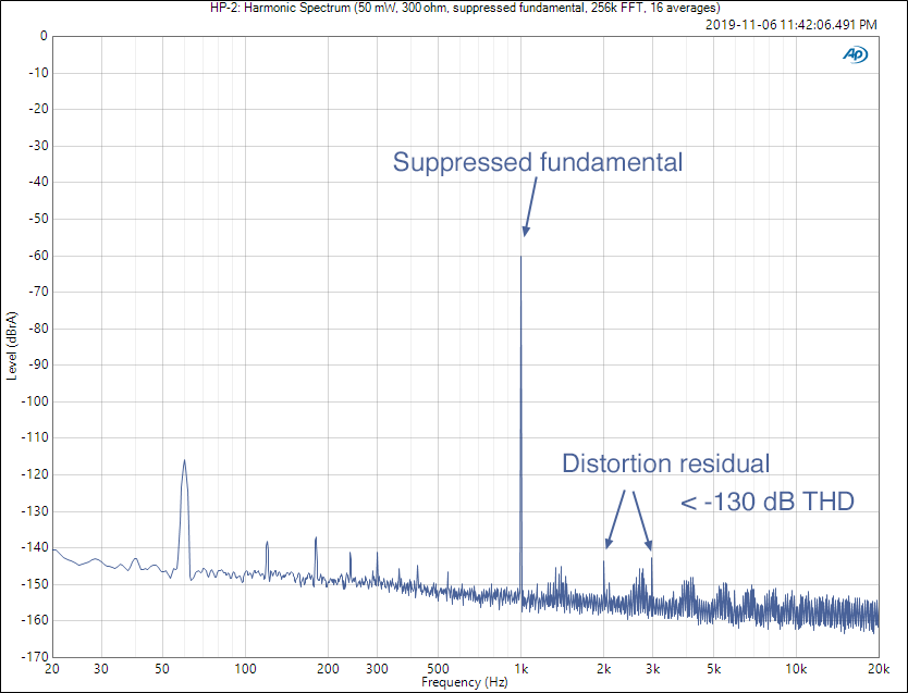

HP-2_ Harmonic Spectrum (50 mW, 300 ohm, suppressed fundamental, 256k FFT, 16 averages) - annota.png52.2 KB · Views: 1,641

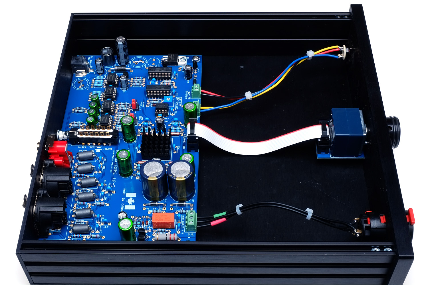

You can build the HP-2 with the following outputs:
There's only a minuscule benefit of using the 4-pin connector. You get ever so slightly better channel separation as you do not have the shared ground connection in the 4-pin connector.
Some will argue that a balanced amp will provide lower distortion due to the cancellation of harmonics. That's true in a high-distortion design. The cancellation doesn't work well for low-distortion amplifiers. In fact, any sort of cancellation scheme is much more likely to degrade the performance of a low-distortion amp than to improve it. Even in the cases where the THD is reduced by such cancellation, the cancellation mostly affects the even order harmonics – the ones most find pleasant sounding – while leaving the odd order harmonics (that many find to sound harsh) in place.

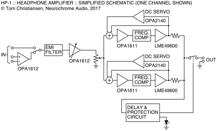

No block diagram (yet) on your site, like the HP1 .
HP-2 – Neurochrome

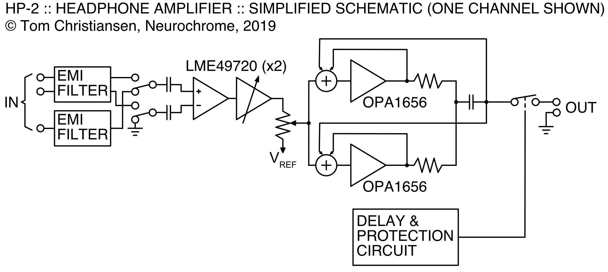

How do you go from the 28Vdc to a + and - supply ?
It's LME49720 + 2 paralleled OPA1656 with an AC coupled output, so a capacitor at the output . mmm...
Correct. I need to proofread about half the verbiage as well. 24 hours/day one person kinda thing. I just got caught up after returning from BAF.
I don't. Hence, the output cap. I use nested feedback to eliminate the THD of the output cap. It works rather well.
Output Impedance 2.6 Ω ? Pretty high...
Meh... Does it matter? I agree that it won't look as good on Amir's ranking plots on Audio Science Review, but it will certainly work well (as my data show).
