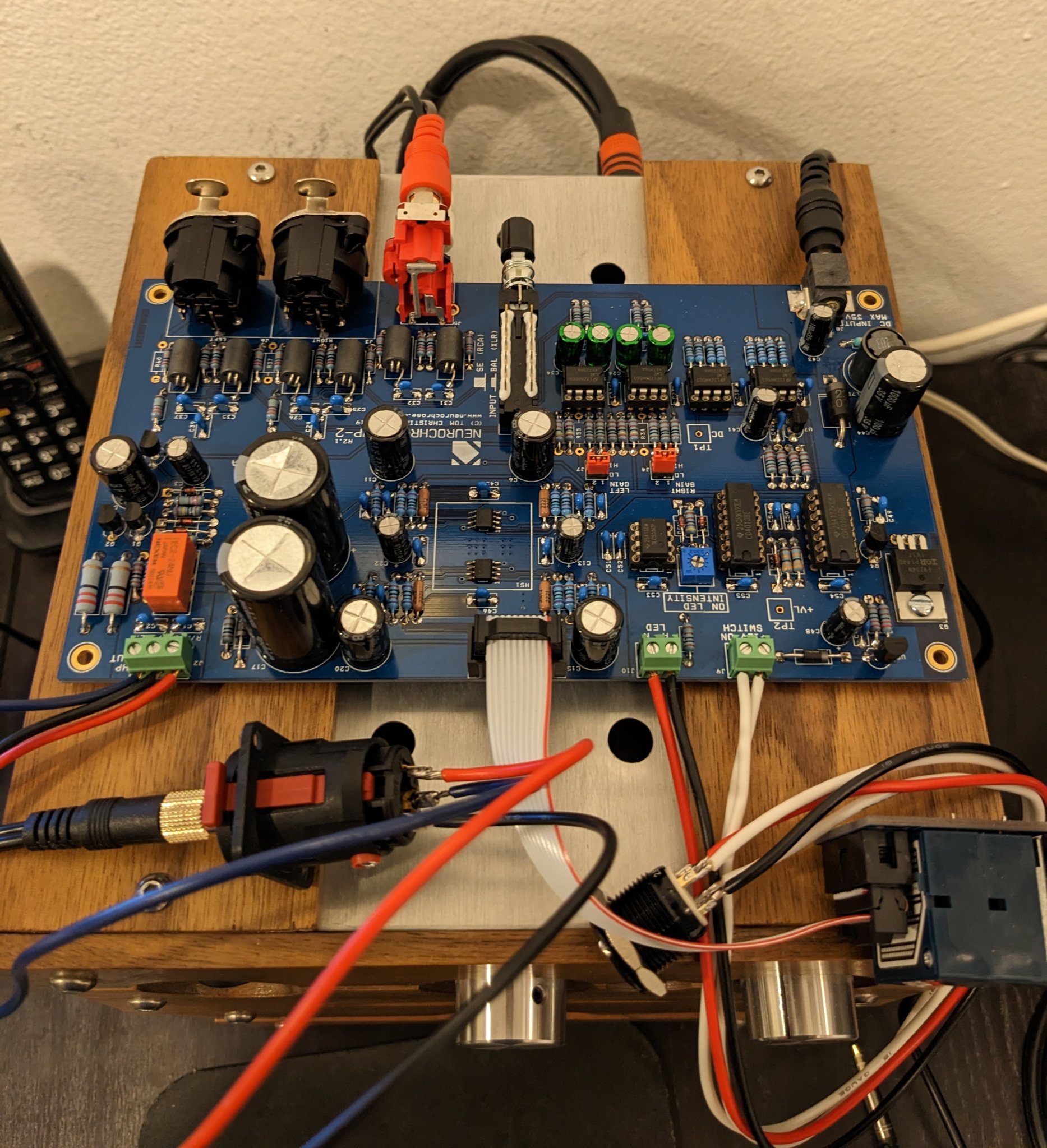

All built according to the BOM including the Alps RK27. I'll give it another once over and double check everything. Thanks for the support.

After setting my HP-2 aside for the last year the gift of a Schiit Modius E this holiday with balanced outputs led me to see if I could figure out the issues I was having again. I decided to purchase the case Tom offers to give it a proper home to rule out any problems not having it housed could cause. Of course that is when I discovered that the caps I substituted since the specked ones were out of stock at the time are too tall to fit under the cover. So a couple standoffs under the top plate are now installed. After hooking everything up I still had this odd buzz through the headphones when the power switch was off. When I turned the amp on the buzz would disappear after the startup delay. I double checked everything but no change. I remembered that Tom had mentioned when trying to help me before that the issues I was having trying to use the HP-2 as a preamp could be power supply related. I was using the suggested 28v Meanwell unit so thought it unlikely but was at a loss so dug around my collection of old power supplies and found a 19v laptop unit and plugged it in. No buzz, looks like I got a bad power supply from Meanwell. So I ordered a new 28v Meanwell supply and the shorter caps from Mouser to hopefully get everything sorted.
Question, what is the impact of running the amp using a 19v supply instead of the 28v supply it is setup for?
The overall setup is a pi 4 NAS and streamer running MoOde, Schiit Modius E, the HP-2, and HD650 headphones. It now sounding very good.
I found a couple 24v power supplies to try, both Meanwell. A GST120A24-P1M and a GST18A24-P1J. The GST120A24-P1M does not cause the buzz with the power switch off, the GST18A24-P1J does cause the buzz. So the 28v GST25A28-P1J and 24v GST18A24-P1J both buzz. Makes me less confident that the replacement GST24A28-P1J I ordered will not buzz as well but we will see when it shows up. Maybe Meanwell had some manufacturing issues a few years ago when I ordered these or could there be some other issue?

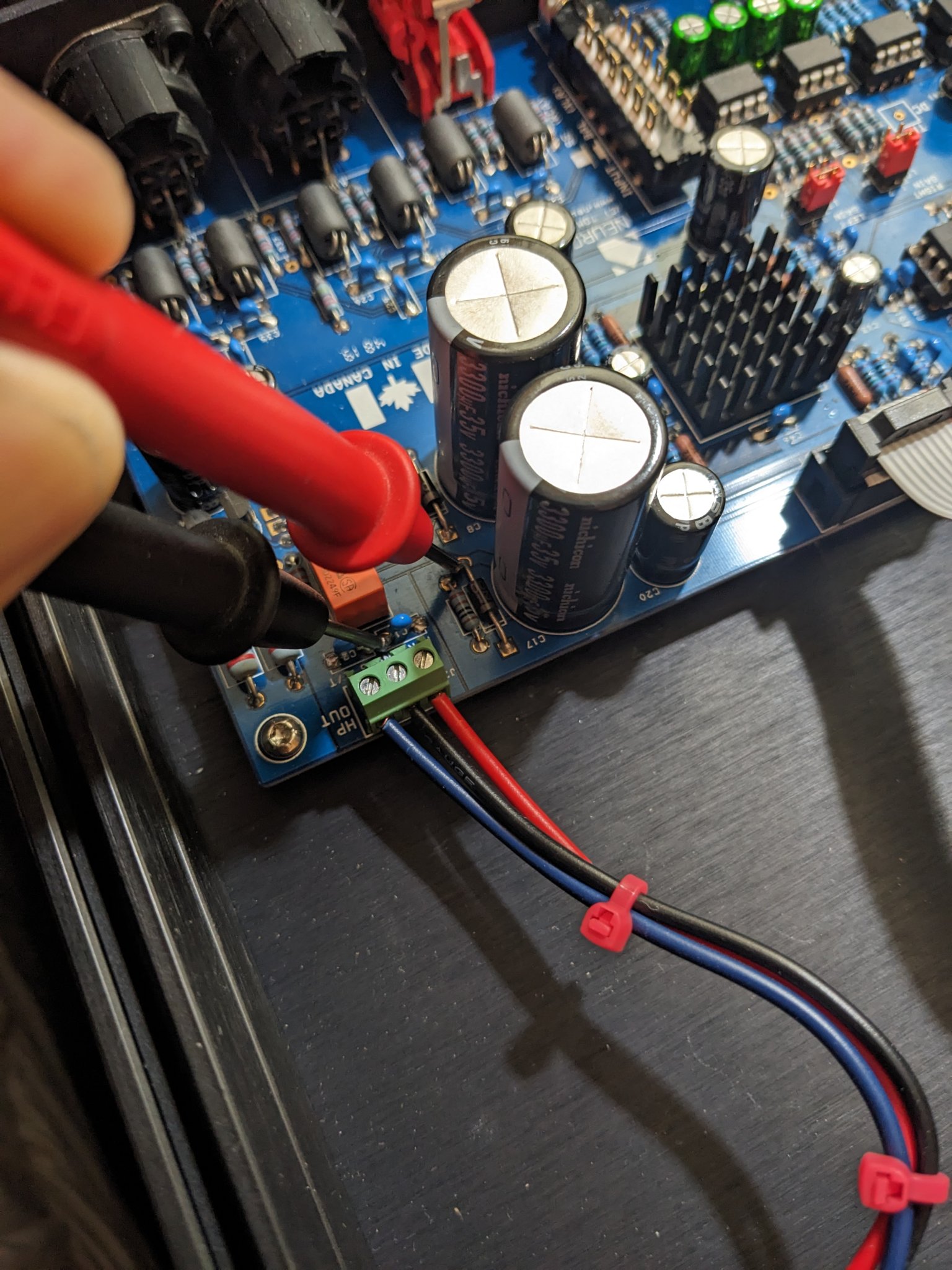

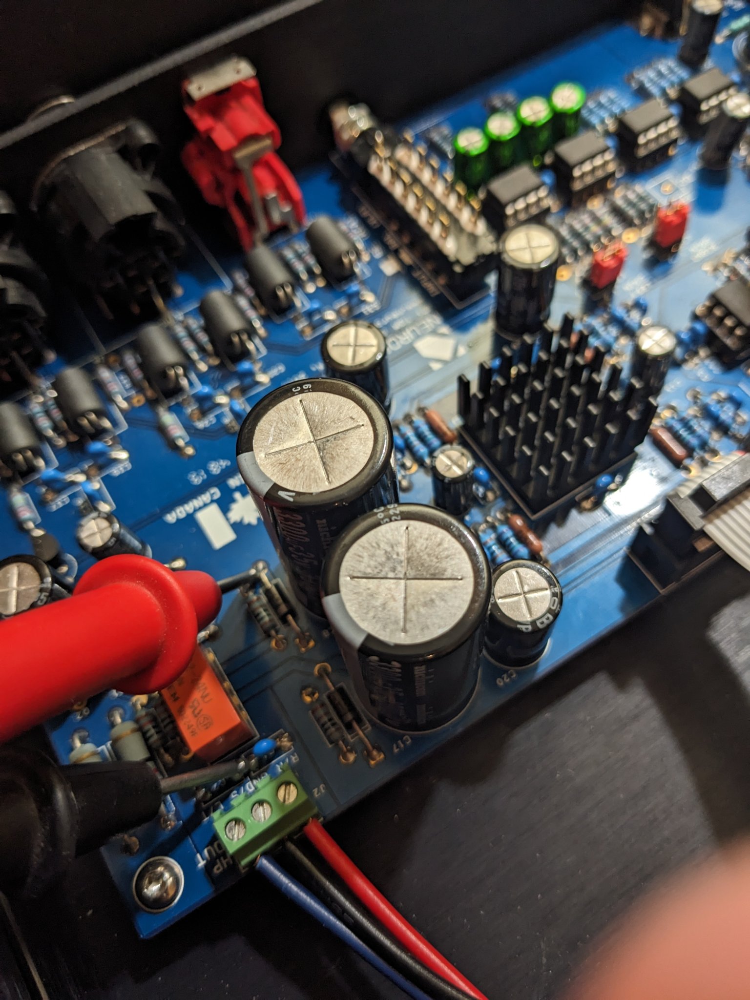

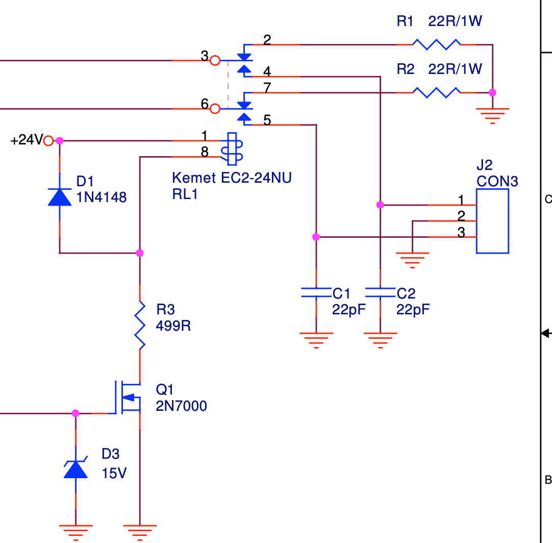

That's really odd as the headphones are disconnected by a relay when the power is off. J2 connects to the headphones. So I guess it would be prudent to measure the voltage across D1 when the power is off and when it's on. The voltage there should be 0 V when the power is off and close to 24 V when it's on and the start-up delay has passed.
Tom
That's not measured across D1, though. Across means you hook one probe to one end of D1 and the other to the other end of D1. Personally I would put the plus probe on the cathode of D1 (which is also +24 V) and the minus on the anode of D1, but it really doesn't matter in this case as I'm only interested in the magnitude of the voltage.
Your measurement does answer one thing, though: The relay does not have power when the amp is turned off. That's as designed.

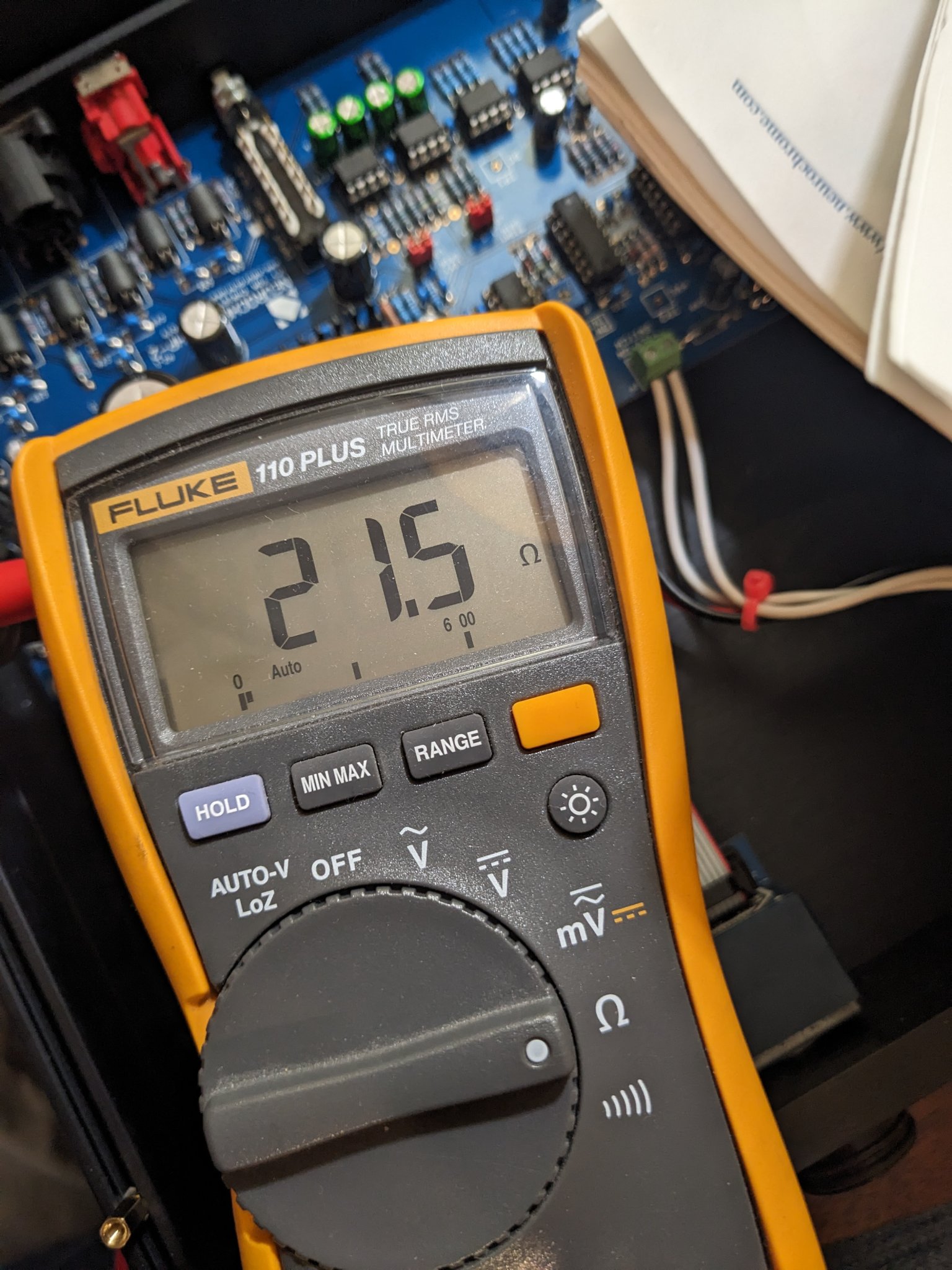

So now, I would measure the resistance from pin 3 to pin 4 of the relay with the power off. Do the same for the resistance from pin 5 to pin 6. Do this with the headphones disconnected.
The output side of the relay are easy to find as they're also available on C1, C2. The input side of the relay goes to the anode of D4 (connects to relay pin 3). Similarly the anode of D5 connects to relay pin 6.
Those resistance measurements should show near infinite resistance with the amp turned off and near zero resistance once the start-up delay has expired and the relay has engaged.
Tom

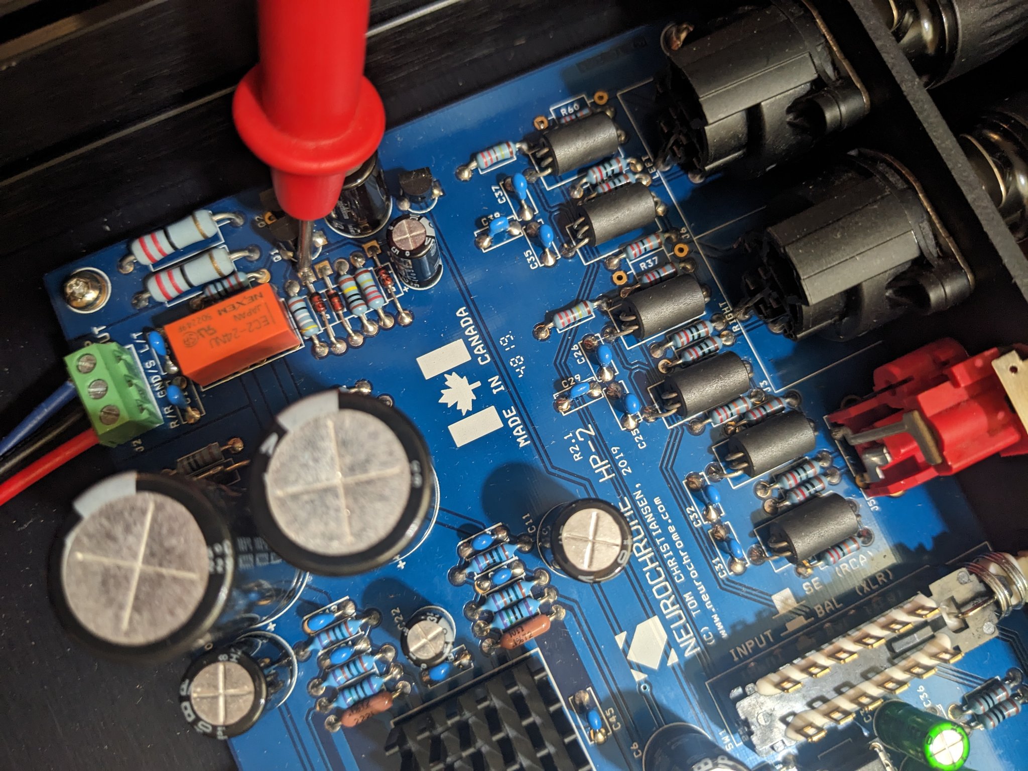

Are you sure you're measuring on the side of C1, C2 that connect to the relay. I don't have the layout in front of me and won't be able to until about a week from now.
Come to think of it, instead of measuring on C1, C2, you can also measure from D4, D5 anode to pins 1, 3 on the output connector. Pin 1 on the connector is marked with a rectangular pad. Also see Appendix A-2 in the design doc.
Tom
Nope not sure at all. Please excuse me but obviously I am not the most savvy when it comes to electronics but I think I got it now. Measuring from pin 1 and pin 3 on the output to the anode side of D4 and D5 it works as intended. Amp off infinite resistance, amp on near zero.

That means the headphones are disconnected from the circuit when the power is off. That's exactly as designed. What you're dealing with is probably some sort of capacitive coupling from the power supply to the headphones. I'm guessing the buzz you hear is very faint.
You could try to connect a 2N7000 as follows: Gate and source connect to Q5 gate and source. Then take the drain through a resistor to the internal 24 V rail. You can pick that up on the cathode of D2. The resistor should be a few hundred ohm, maybe 1 kΩ. The value is not critical.
