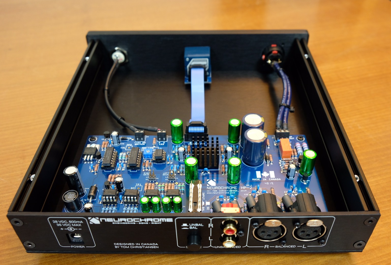

Here my HP-2 finally completed and playing. Very please with the sound, even if it is still at the prototype stage, awaiting a chassis. It is cut from the same cloth as its bigger brother the HP-1. Very revealing and detailled sound, pitch black background, plenty of gain. I did a detailled study of its circuitry, and I can tell you it is not your run-of-the-mill op-amp design. It uses very clever circuits to get the most of each parts. An no, there is no ceramic X7R caps in the signal path anywhere 😉

Here my HP-2 finally completed and playing....
Nice work !

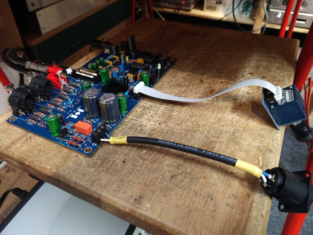

Any particular reason why you used that cable for the output?
The R/L signal are in a twisted pair... it's probably inaudible/meaningless but could that introduce cross-talk?
I assume a shield is not really necessary as there PSU is outside the chassis
Hi Tom
From the photos it looks as if the shell/s of the RCA inputs are connected to the chassis; the shell directly and via the retaining screw. Is that correct? (I think the documentation says that).
Also re the RCA input module; would you help secure it by gluing the plastic locating feet to the pcb (as well as using the locating screw)?
cheers
tim

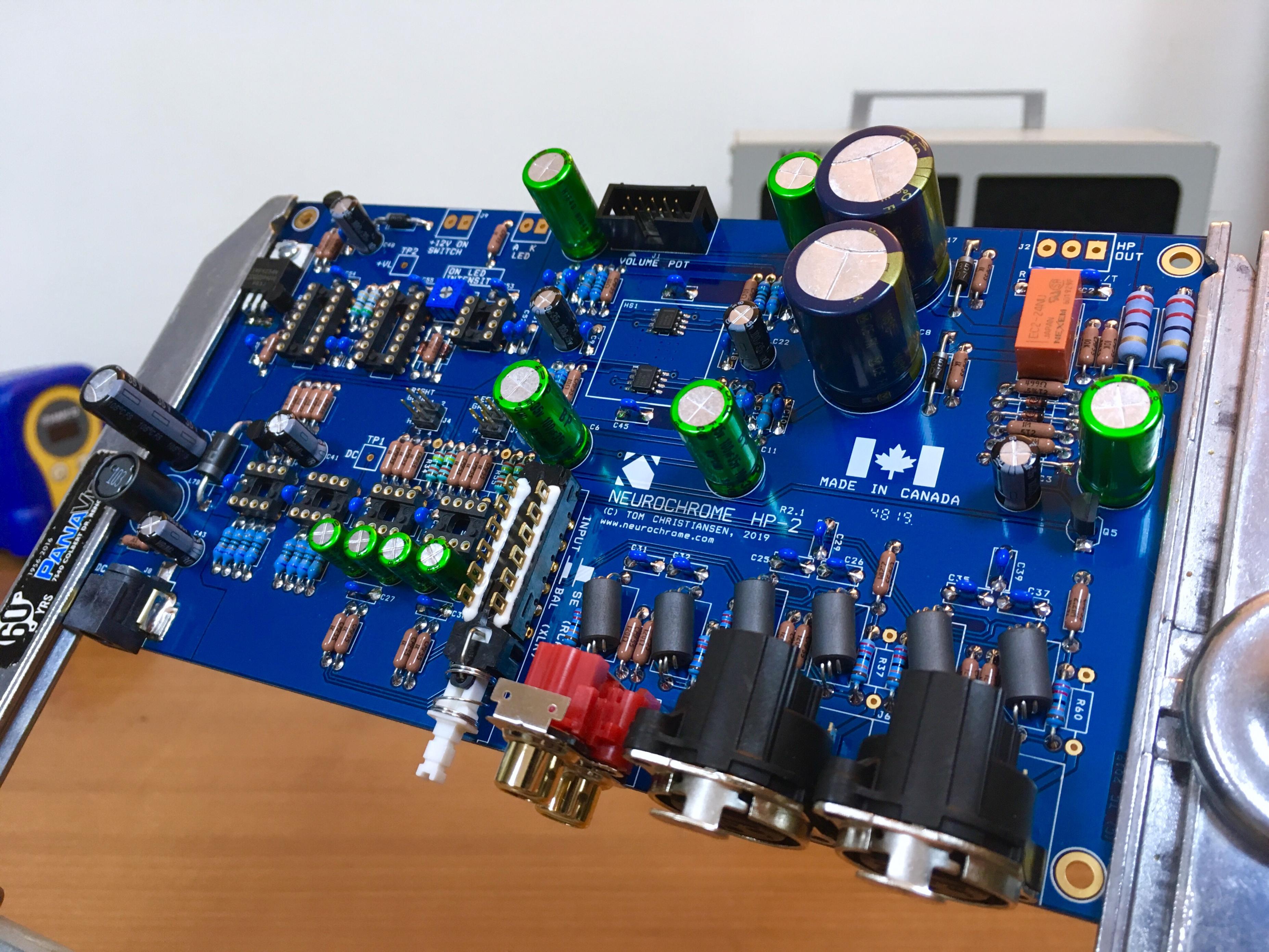

Yep. The RCA shell is connected to the chassis. The differential input senses the voltage difference between the RCA shell and the RCA centre pin.
Not really. The two plastic feet are really just to hold the RCA connector in place as it goes through wave soldering. The mounting screw and PCB mounts will ensure that the RCA connector doesn't move during operation, so the solder joints get to live.
Now, I'm assuming you don't have a wave soldering machine in your garage. If you do, you definitely get some serious DIY electronics points! 🙂
When you solder the RCA connector, just make sure it stays perpendicular to the PCB and is pushed all the way down to the PCB surface. I usually solder one of the pins, then check to see that the connector is aligned correctly, then solder the remaining pins. Just a precaution. The two locating pegs/feet usually do a fine job of getting the connector in the right spot.

May I also ask what size holes are used in your chassis for the RCA connectors?
best
tim
I followed the dimensions in the data sheet for the connector. The larger holes are 11 mm in diameter if I recall correctly.

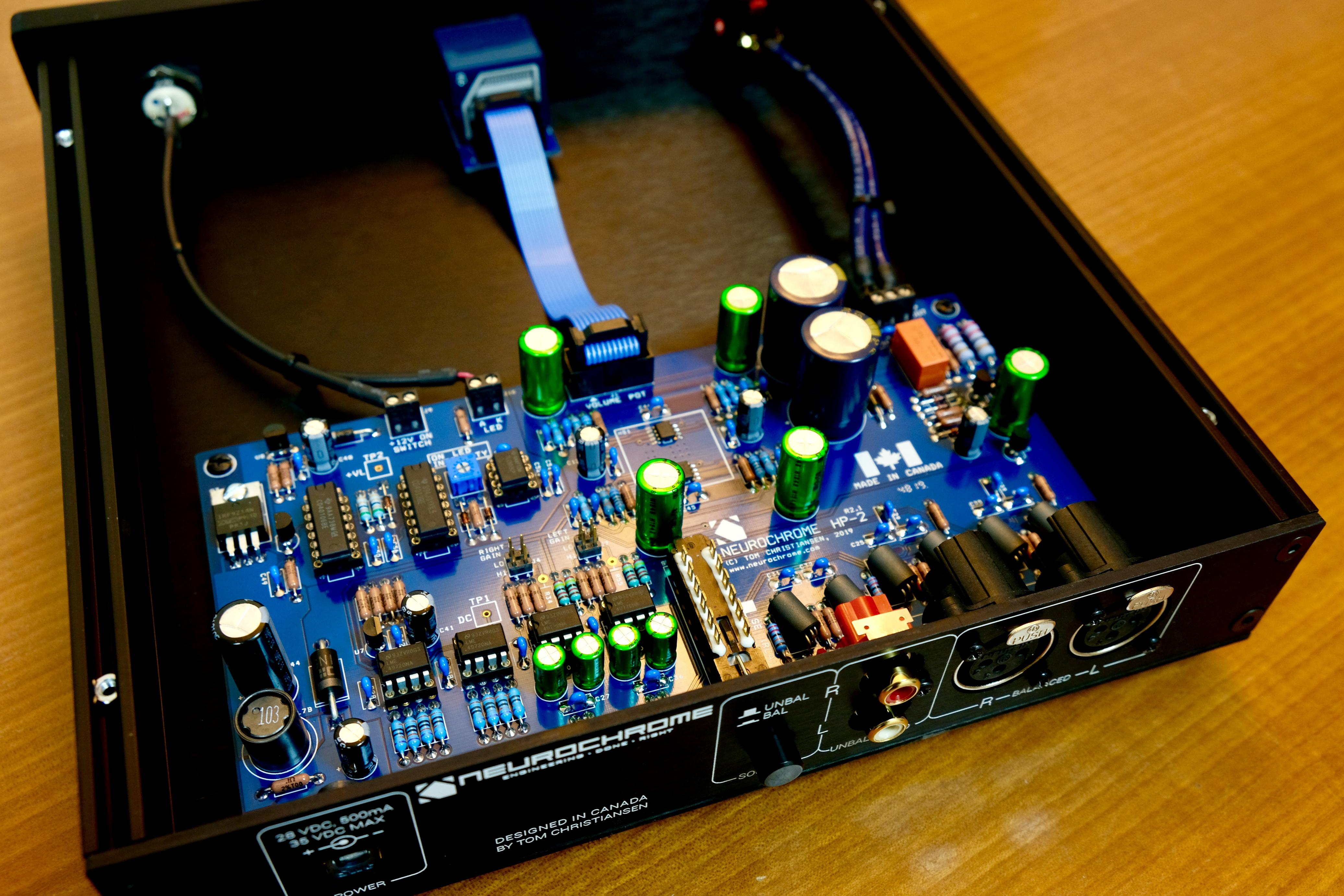

Hello everyone, I completed my HP-2 earlier this month.
The completion of this project is great.
And the appearance looks more beautiful than expected.
Although there are many components inside the machine, the layout is very friendly.
Therefore, the actual soldering time is not long.
Skip the preparation time and make it in one day.
The guidebook is also very careful and detailed, even Muggles like me can do it freely.
Tom also prepared mouser's project shopping cart.
No need to grab it by yourself, just checkout directly.
However, the TE manufacturer's resistor specified by Tom can easily remove the color code when cleaning the flux.
If you mind it, you can pay attention to it during production.

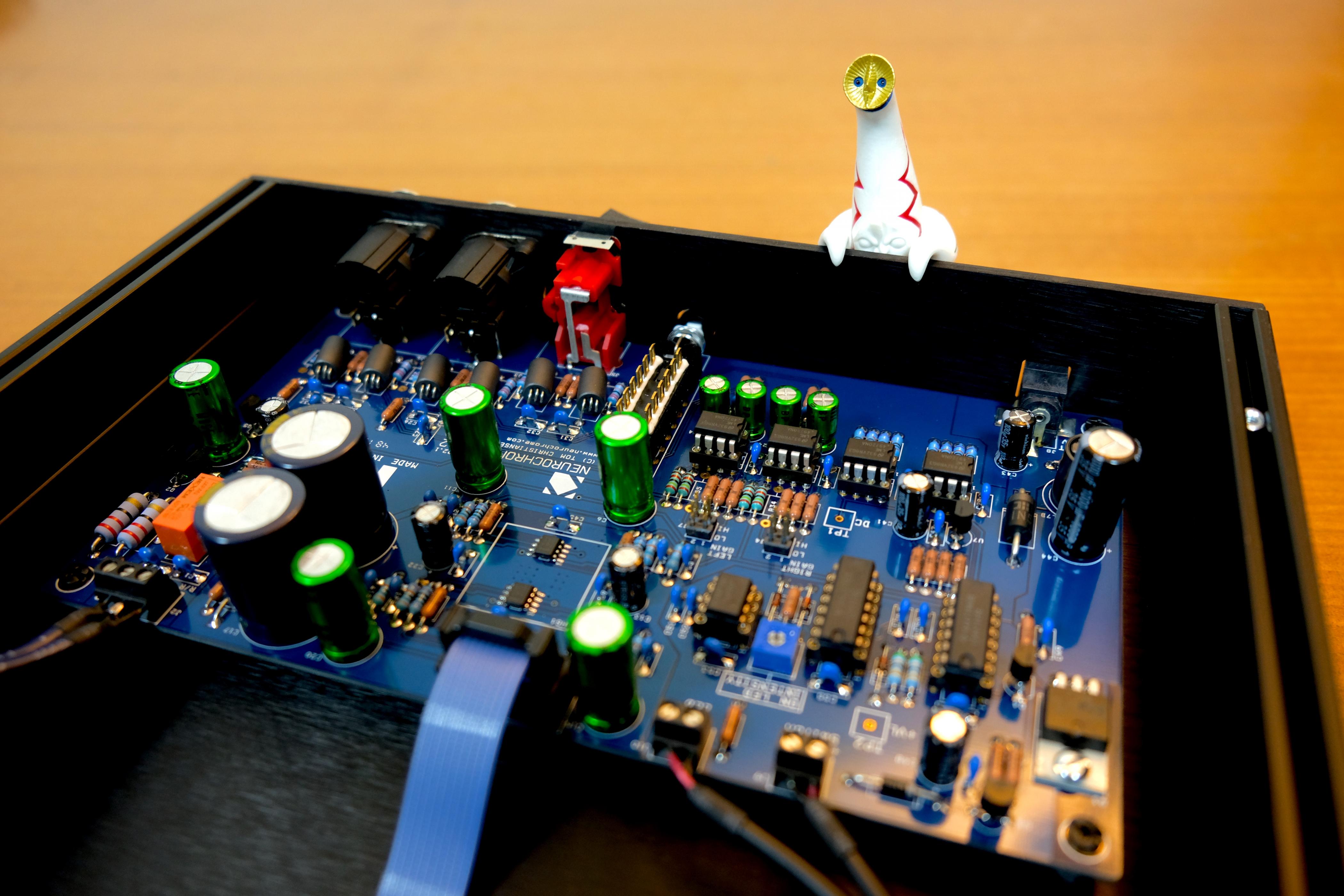

Thanks a lot.🙂That's a very clean build.
I agree. The chassis makes clean builds very easy to obtain.

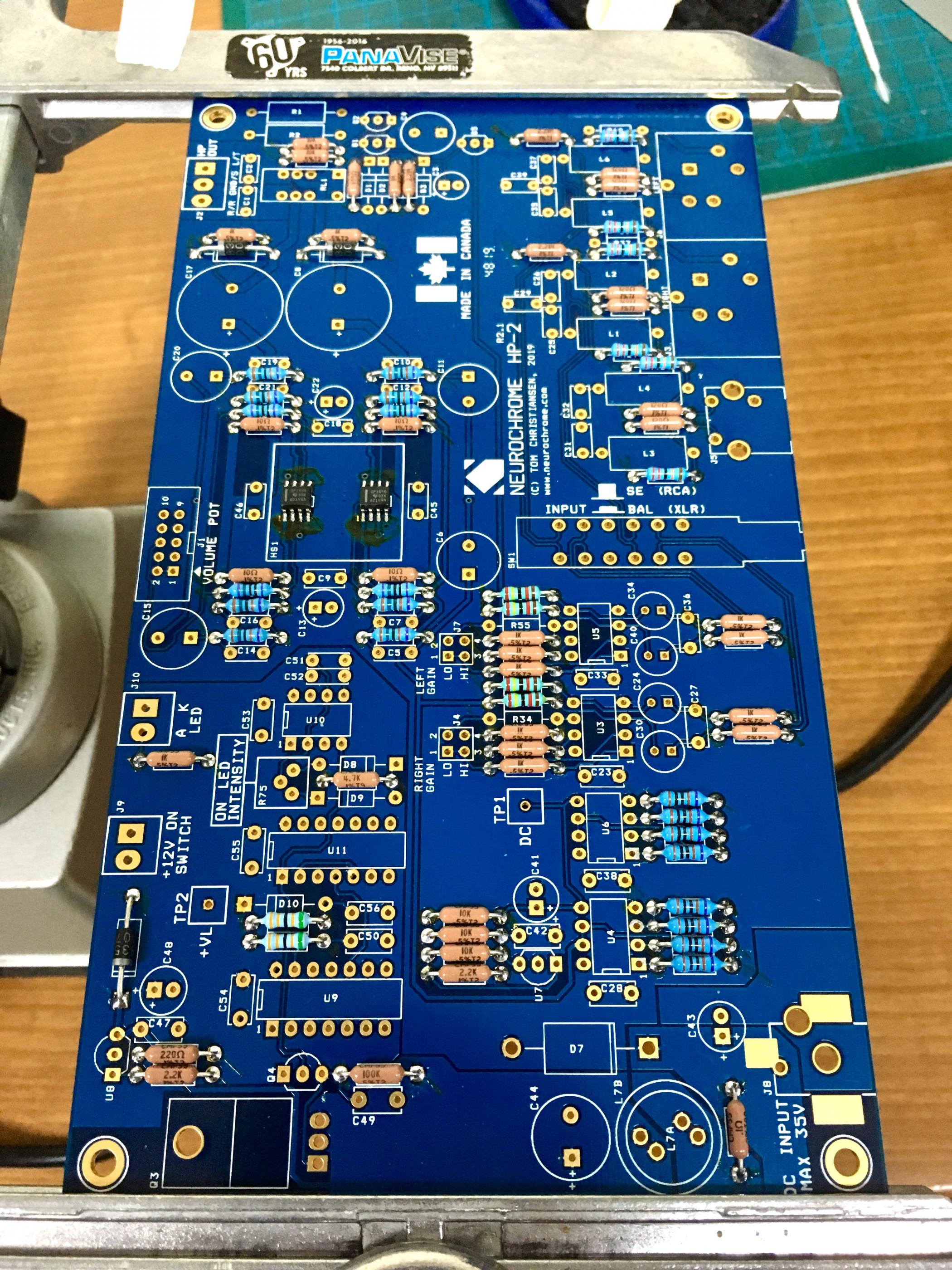

Interesting. Which flux cleaner do you use?
For RMA flux, I use a cleaner by MG Chemicals. I've never had issues with it removing the resistor markings.
I got tired of the fumes and hassle and switched to water-soluble flux about six months ago. Hot water and a gentle scrub with a toothbrush and dish soap removes the water soluble flux easily.
