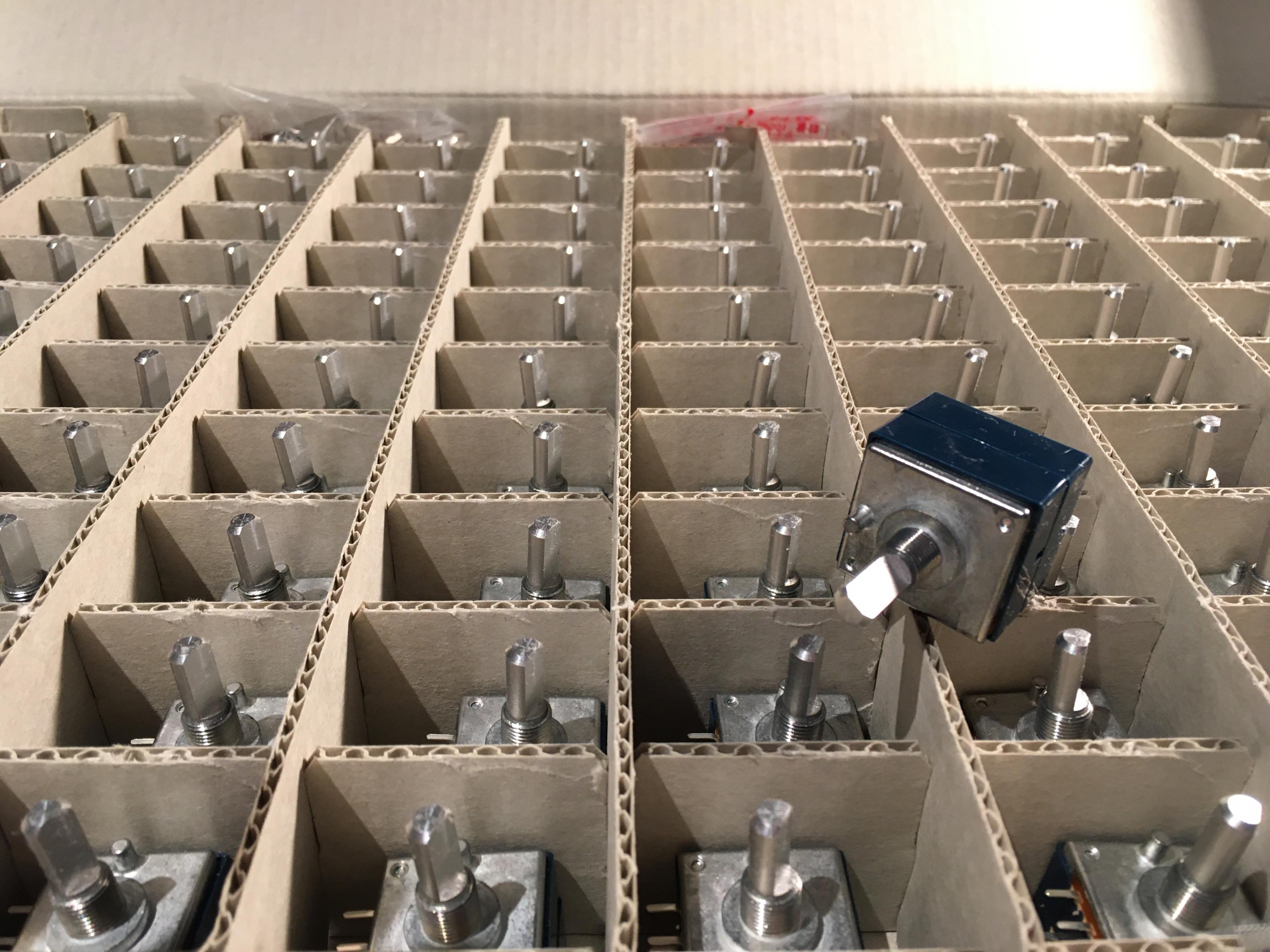

ALPS RK271-series volume pot (10 kΩ, audio taper; Mouser P/N: 688-RK27112AS-103)
I ordered the Alps pot from RS Components to Hamilton Canada.
The pot plus delivery came to $30.37 USD
The duty came to $20.06 CAD
Mouser wouldn't have the pot in stock till April. I ordered from RS Components so I could get the 20mm version. I'm pleased I don't have to take a hack saw to the pot but I didn't expect the duty.
Either way I'd though I'd give the head's up to any Canadian builders thinking of ordering that part...

I ordered 50 of those from RS recently. Paid CAD $11 to DHL for the customs processing and $48.39 CAD in GST (5% as I'm in Alberta). Seems pretty reasonable on a $1k+ order...
You can double-check the paperwork from DHL, but it's probably the processing fee that bit you.
One way to avoid the processing fee is to use FedEx and set up an account with them. You can have the customs fees charged to your account and the shipping fees to the vendor's account (they likely get a much better deal than you do). That eliminates the $10 brokerage fee that FedEx charges. FedEx does tend to be more expensive than DHL, though.
Alps must be really backed up in their production. I ordered 500 custom RK271 pots (through a distributor) in September and have yet to receive any word on when they'll ship. They quoted 2-3 months lead time at the time.

Yea, you're right Tom...it was the processing fee.
tax - 1.98
duty - 0.0
processing fee - 12.43
transaction fee - 5.65

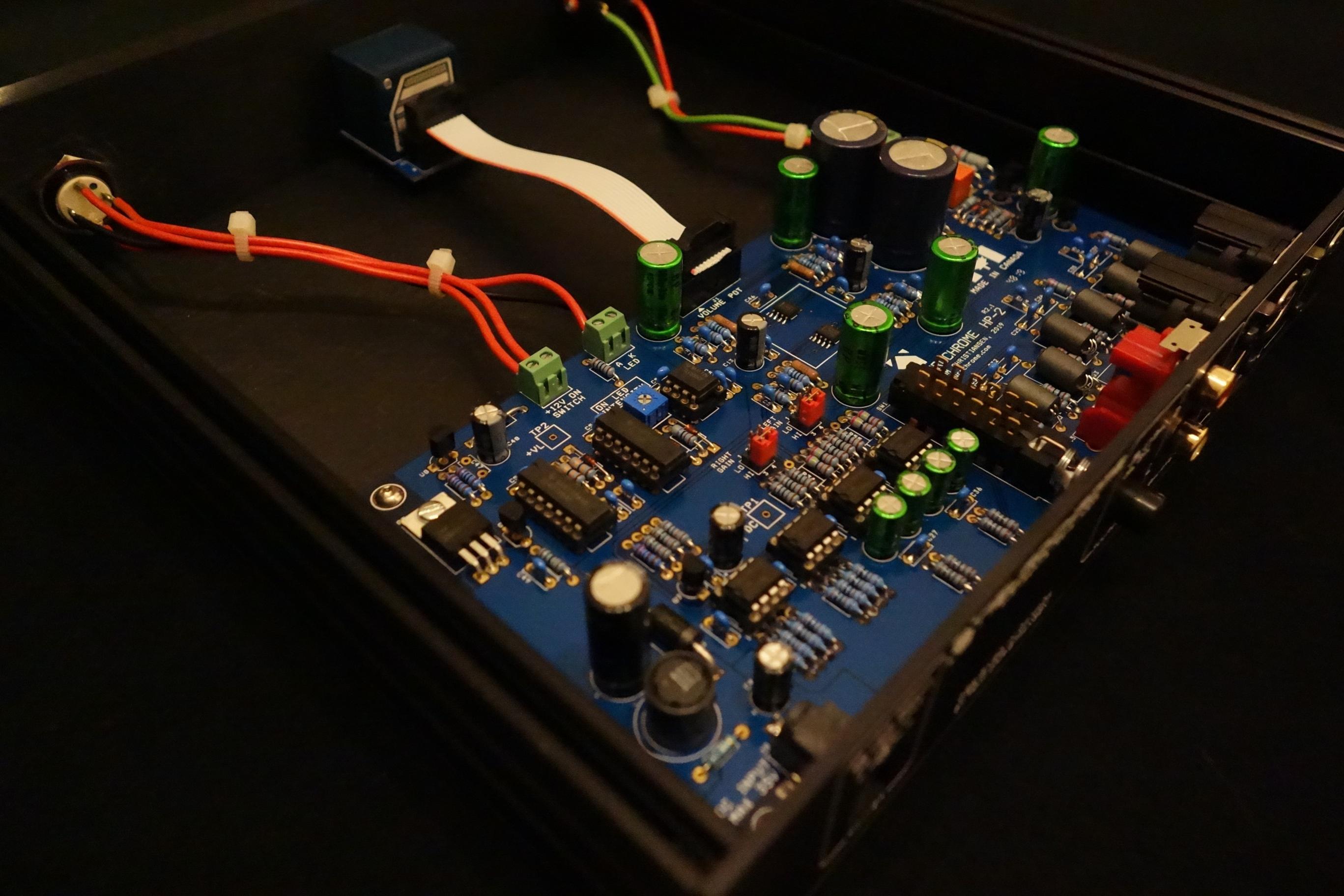

Looks like a clean and neat build, nice 🙂
How did the ribbon cable go for you? I crushed mine and had order another one!
I did it in small clamp (vise), as in:
Clamping Sockets on Ribbon Cable (with Pictures) - Instructables
I described my method in the HP-2 design doc. Basically:
A small vise, such as the one linked to above, works well too. I used to have one of those, but it wasn't the greatest quality, so I tossed it when I moved across the Atlantic.
It takes a little practice to make the cable, but it shouldn't be too bad - even for a first-timer. You can gently pry the connector apart (lift the ears, then pry) and often reuse them if you mess up. The BOM includes enough ribbon cable for two tries.

- Feed the ribbon cable through the IDC connector.
- Make sure the cable is aligned properly within the little 'forks' that form the connection with the wire and that Pin 1 of the connector aligns with Wire 1 of the cable.
- Press down on the top piece of the connector with the bottom of the connector resting against a hard surface (top of lab bench). I press with the heel of my hand with some hard object in between to ensure constant force across the connector.
- Ensure the top piece is pressed fully down. You should get an audible 'click' from the "ears" of the top piece as they lock in place.
- Fold the cable over and attach the strain relief.
- Repeat for the opposite end of the cable. Make sure the connectors are aligned properly with the cable.

Below is a summary of my first few months with the Neurochrome HP-2.
It’s no secret that I am a fan of Tom’s methodology and his products. This will not be a review per se, but an explanation of how the HP-2 found its way into my daily-driver position for desktop headphone listening and why I now consider it a “reference” headphone amp.
Background
I got the amp from Tom at the Burning Amp Festival in November. I had asked Tom about buying a set of boards for the HP-1. He had discontinued the HP-1 boards, but he offered to sell me his prototype HP-2, so I gladly agreed. My unit was built by Tom with carefully selected parts, but no “boutique” parts. The total budget to build a comparable unit is less than $500 USD using the same excellent case and well-chosen parts. You can also build it for much less. This is a DIY project, so everyone’s mileage and budget will vary.
I’m a bit of a subjectivist. That’s not because I don’t trust measurements, but because I have very little idea how to interpret much of the data. I know certain measurements and specs tie to whether an amplifier is well-designed, but I have no clue what makes things sound good (to me).
My primary use for the HP-2 is as a desktop amp for use while I work. So my main comparisons were with other desktop amps; namely the Lyr 3, a Crack with Speedball, the WHAMMY, and the ACP+. Tubes, opamps and other accessories were not “rolled” and were not a factor. I compared the amps as I would use them normally.
I used the amp almost daily. I did some casual A/Bs with a reasonable number of amps and DAC/Amp combos. I generally listen to gear over an extended period of time vs. back and forth A/Bs.
I used Sennheiser HD 800S, Sennheiser HD820, Meze Classic, Oriolus IEMs, and Beyerdynamic Xelento for comparisons. I use the Sennheisers at my desk most often. So, naturally, they got the most use, but I also wanted to see how it would perform with lower impedance headphones and IEMs.
The vast majority of listening was done with a MacBook Pro feeding a variety of DACs, but primarily I used a Topping DX7s over USB connected to the balanced inputs of the HP-2 with standard XLRs. No fancy cables. I use Audirvana or Roon to access my personal storage and Qobuz. I use Audirvana because I like using Can Opener and Sonarworks occasionally.
When listening to the various amps and comparing them, occasionally I’d listen for a song or two and sometimes for a half song or less trying to compare known passages. I would level match by ear to the best of my ability when comparing amps for shorter sessions. However, most of the time I’d hook up an amp and listen for ½ a day or more and up to a week in a few cases. Except when consciously A/Bing I used the amps as I normally would without writing down any notes or really thinking much about them. I listen to a broad range of music at what would probably be considered soft levels, but I like to listen at higher volumes on occasion. I pay attention to all aspects of the music, but I place a lot of weight on vocals.
