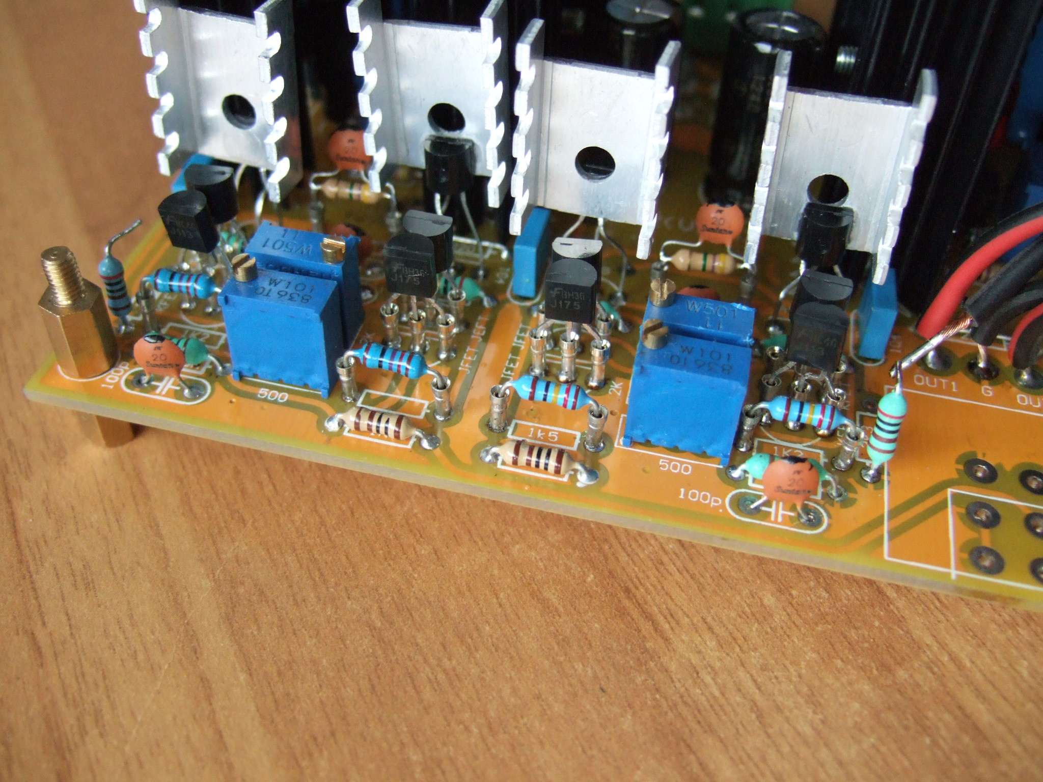

Hi guys,
First I would like to say that this is my favorite forum, which I've read and learned a lot. The reason I have not written and shared many thoughts because my English is not good and my writing is bad too. Even at this moment I use google translate. Anyway ...
I can not stay silent because I am very excited. After reading about JC2 I decided to buy a kit from ebay mainly because of the ability to use the PCB. The kit comes with good quality parts with 2sk246/2sy103 jfet BL grade from about 10mA Idss.
After reading the advice that Mr. Curl gave us, I decided to stick as close as possible to the original scheme. As far as allowing me the parts that I have in stock.
I listened music mainly with two combinations. The first one was
2sk246/2sy103 at 6mA, 2N4401/03 at 37mA, 240 Ohm load resistantse, 113 Ohm at Potentiometer between Jfets, R33 - 2K, R34+VR5=4.53K and without C18 feedback cap.
The second one was
j113/j175 at 13mA, 2n4401/03 at 37mA, 124 Ohm load resistance, 62 Ohm at Potentiometer between Jfets, R33- 2K, R34+VR5=21k and with C18 feedback cap installed (in my case 2.2uF, I have not 2.0uF on hand).
Now the sound ...
With the first combination the sound was amazing with almost everything I love. I say almost everything because I noticed a few minor weaknesses. The first of which was in the low frequencies. After a heavy drum or bass guitar there are pulsation with extra low frequencies that can not be played from my speakers but the pulsation of the whole picture was there for less than a second. Another thing I noticed was the voice and the piano. The voice is very little back and the piano was a little dull.
The sound with the second combination is much easier to explain. It is like the first combination but without weakness. Stunning sound, very musical. The voice is right in the room. The piano is as it should be. That's why I'm so excited and decided to share it with you.
Best regards

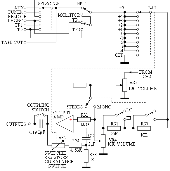

I´m somewhat confused by your part numbers, which schematic are you actually referring to ? 2.2uF (or 2uF) feedback cap ? You mean the DC blocking output cap ?

Ivo, your test is interesting. The difference between to two is that the 2sk246/j103 combination has too low of working current and too low Gm, to give adequate low Z drive to the second stage. The open loop gains 'might' be similar, but the distortion generation by the second stage will be different between the two gain modules.
Georg, I am not mean DC blocking cap at output C19. I mean the feedback cap C18 refering schematic below. My ampifier already have DC blocking cap at input so I generaly not use the output capacitor at preamp.
