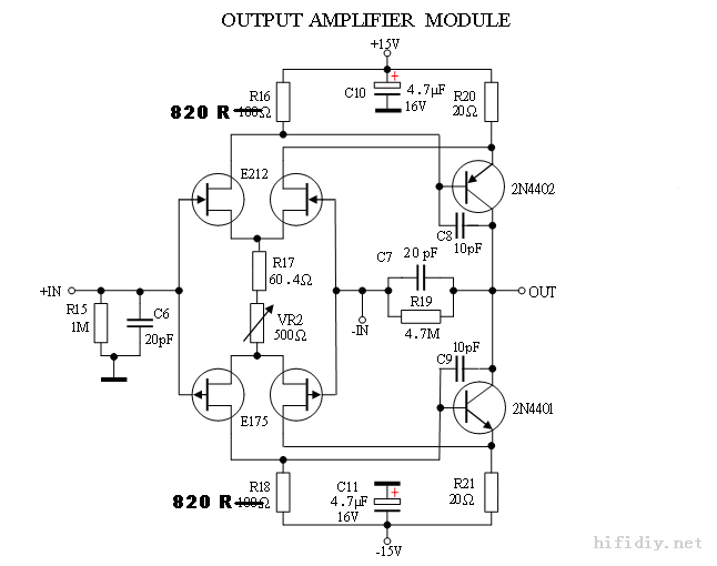

Well, as John already pointed out in this thread, todays E212/E175 are not the same chips they used to be in the seventies.
I would rather build the line stage with matched Toshiba FETs as outlined in #188.

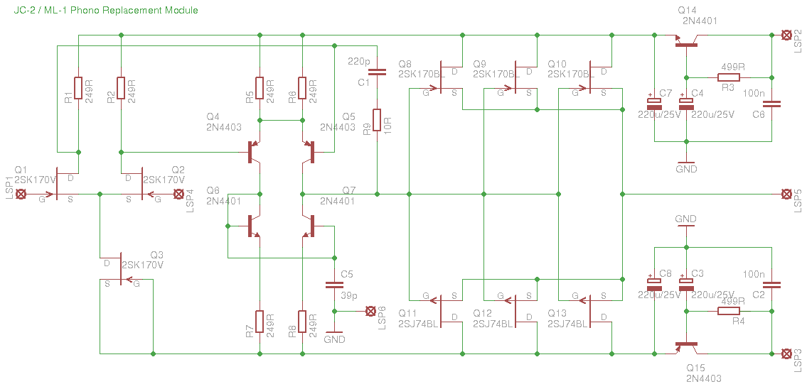

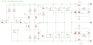

Eventually I finished the line modules. Many thanks to Erno Borbely who was very helpful
and sent me matched quads of 2SJ74V and 2SK170Vs. He also has the other parts in stock
and much more. Very recommended.
Attached is the final schematic I used. I´ve built a version with Fairchild
2SA1381 / 2SC3503 for test purposes too, seems to work equally well.
For Toshiba JFET, is it OK to use matched SK/SJ BL grade at 7-8mA here ?
If I want to use 4402/4401 do I need to change resistor value ?
thanks
