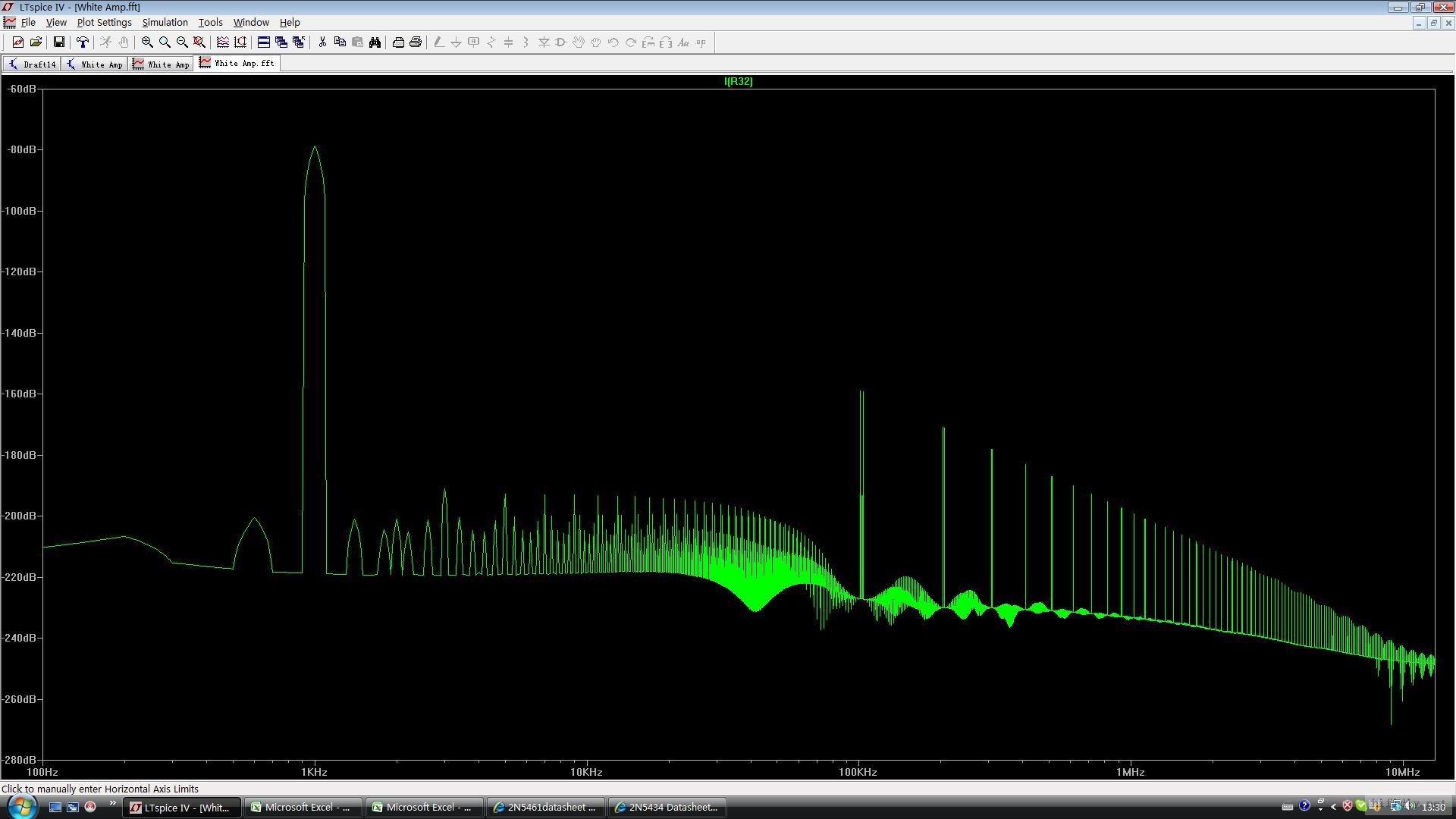

When a PreAmp circuit was simulated I found 1.5Khz appeared in FFT figure ,iuput were 1KHz.
That would be IM distortion frequency ?
But FFT should be just harmonics ,it isn't right?
It's puzzles me.
white PreAmp.jpg (172.37 KB)
下载次数:6
2010-6-19 13:33
It should be understood that the JC-2 design is a PROVEN design topology that has been made in various versions for over 36 years. Slight deviations such as input fet types, output transistors or load resistors changes the distortion slightly, but not significantly. It is better just to build with the essential concepts intact. These are: Comp fet input, low value of load resistor, and fairly high current in the output transistors, 10ma min, 40-60 ma optimum. This will get you there.
That's true,
to build with the essential concepts intact is important.
thank you .

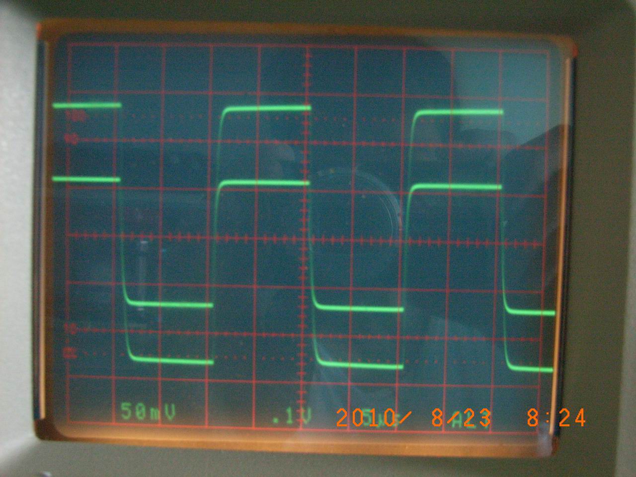

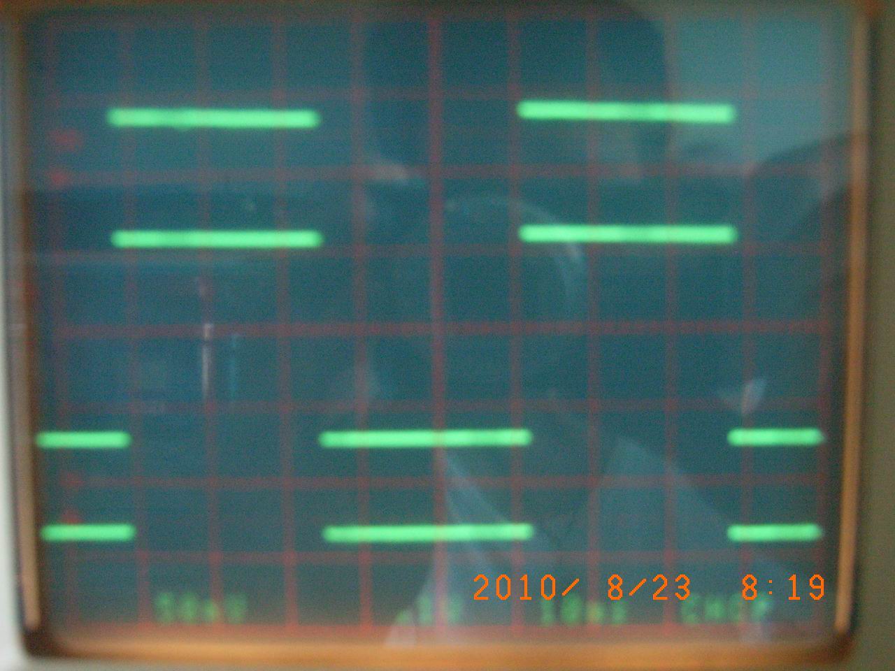

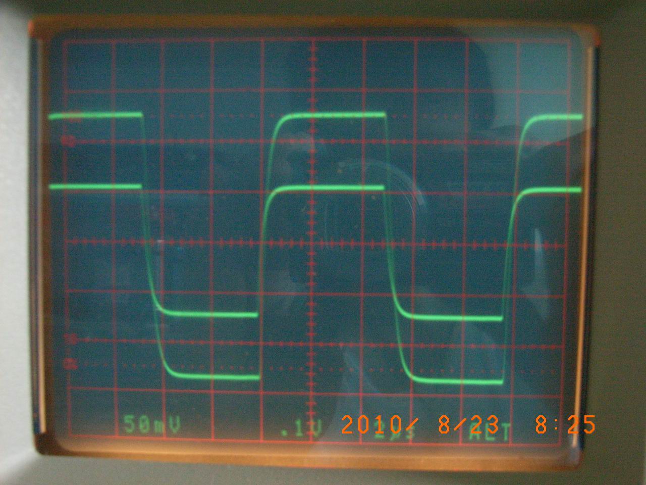

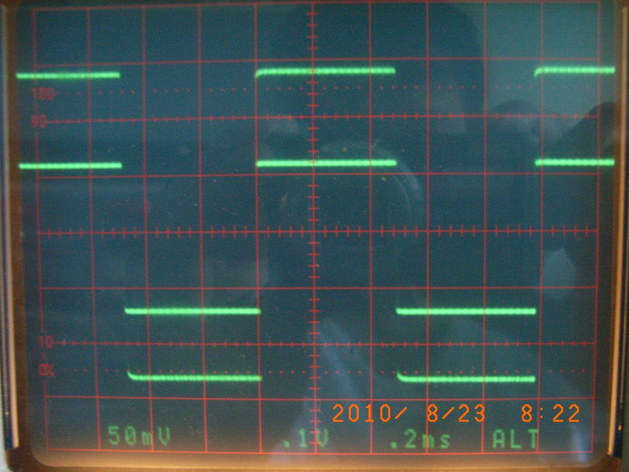

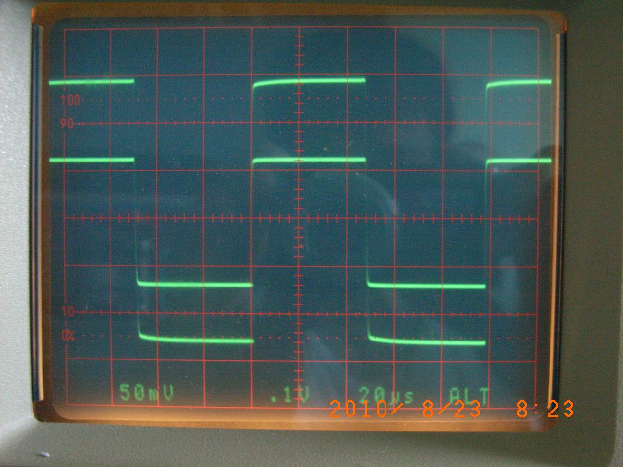

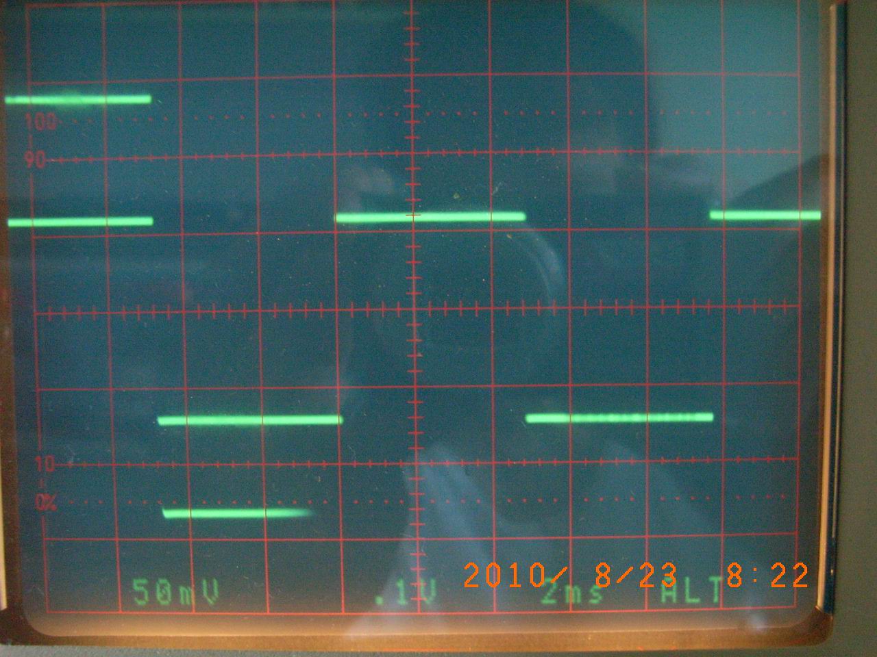

Measured some square wave forms in the following order for a new developing pre-amp base on JC-2 topology. Comments are welcome.
20Hz
100Hz
1KHz
10KHz
50KHz
100KHz

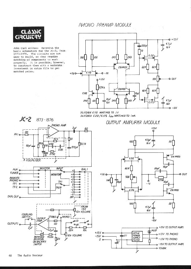

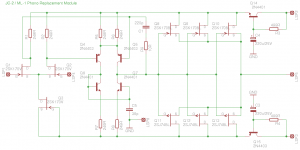

Anyone knows where we can get schematic of JC2?
marklev.com site is no more
and when I search with google there is not one jc2 schematic in the whole world
anyone have the original schema and can post it here as attachment?
we need it desperately!
/thanks

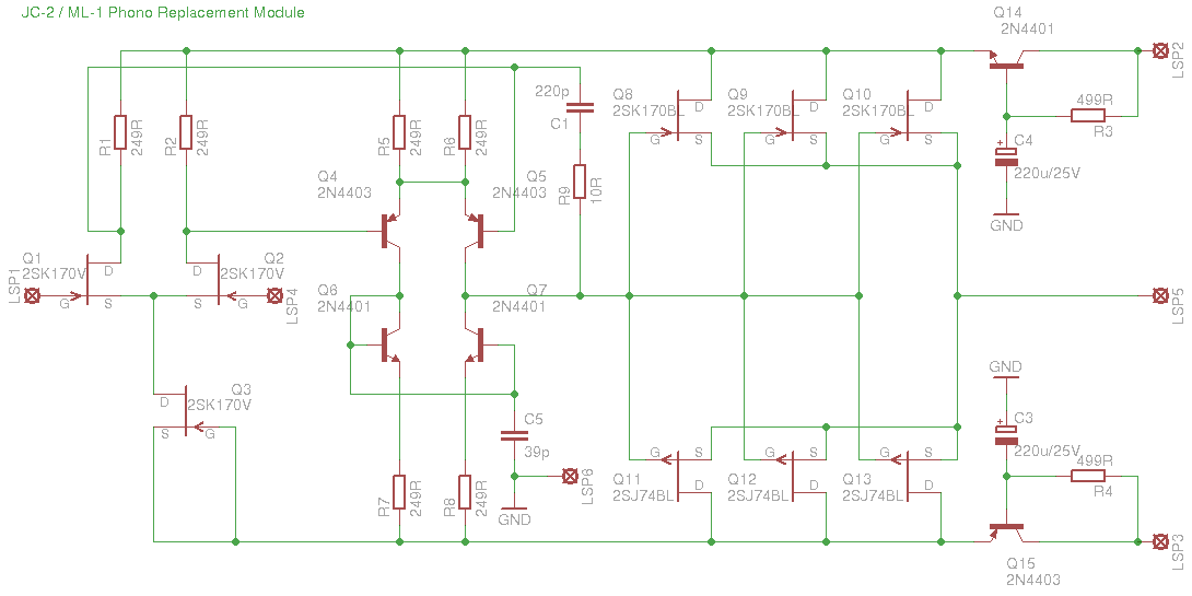

OK, real problem. You must make 4 pairs of complementary capacitor multipliers for improved JC-2. This improves imaging and listening response. Each multiplier is composed of 1ea 0.5A transistor, 1ea 499 ohm resistor, and 1ea 220uf aluminum electrolytic cap 25V. Complementary transistor used on (-) supply. I recommend 2N4401-3 as good transistors for this purpose. Sorry, I cannot draw circuit on this website.
