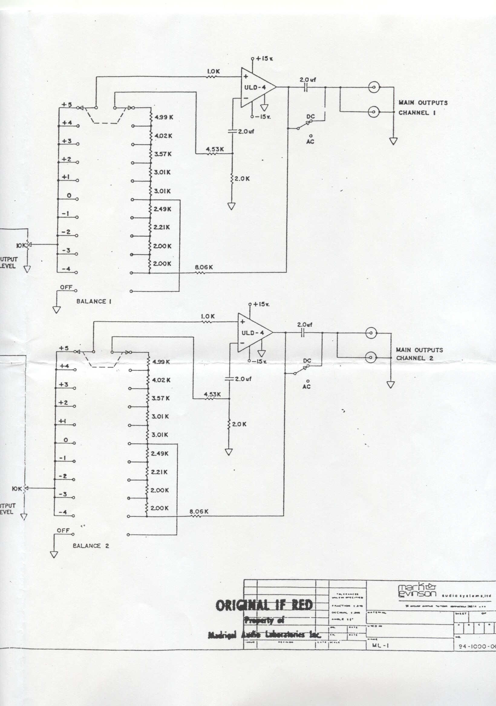

But on post #358 of this thread there's the complete circuit of the preamp, involving several external parts. What I wonder is whether they should be included or not on this project.
For instance, there's the Output Amp, which I guess is the JC-2 Line Amp, but there is an external NFB (C18/2uF; R33/2K; R34/4K53; Balance Switch) which I think is very important. There's also a Volume Pot (VR4/10K) and a switchable output coupling capacitor (2uF).

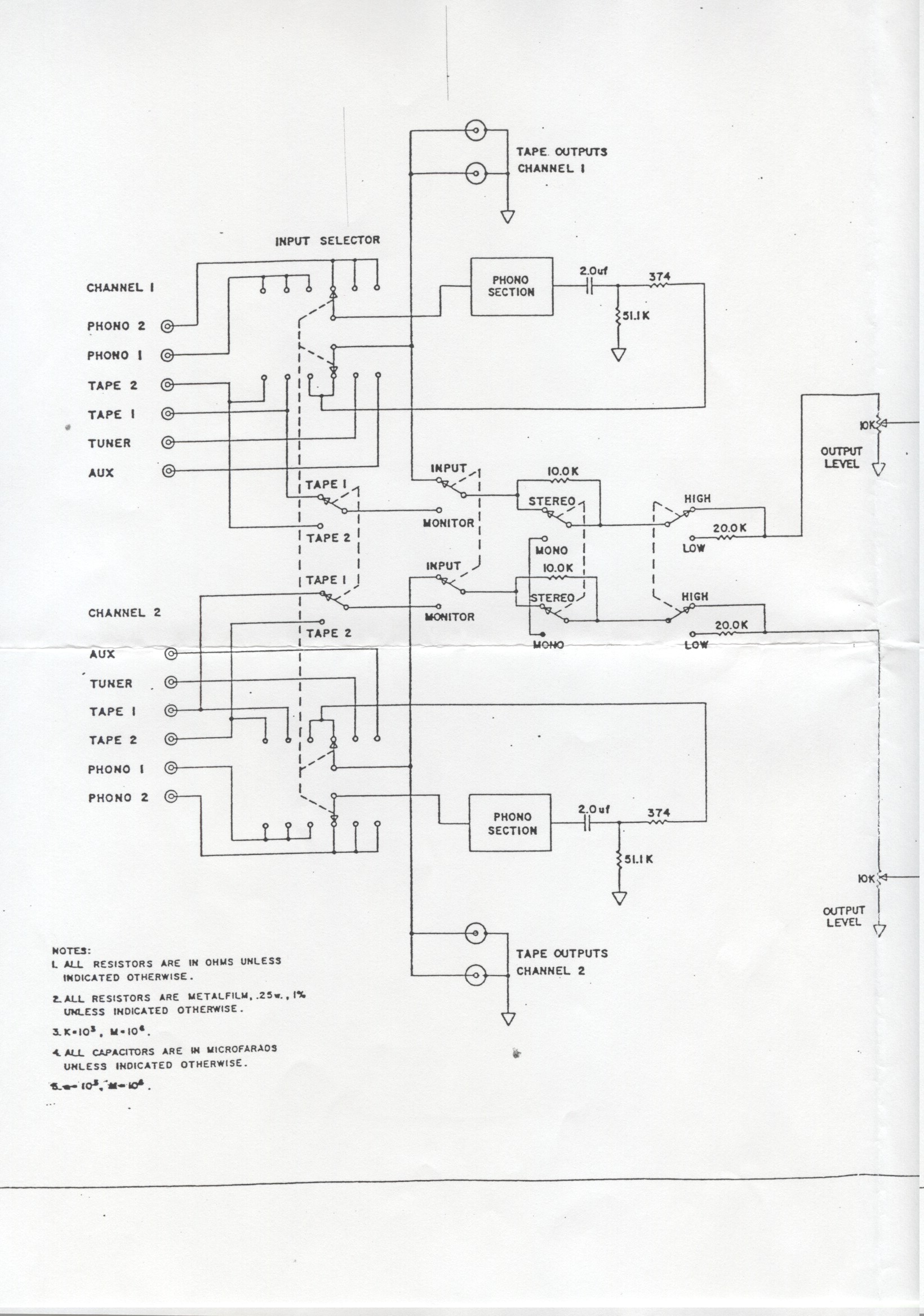

neither.
The 2SK246/2SJ103 combination should present also a lower input capacitance allowing then to use a higher value for the input potentiometer, right?
I would not go above 50k with the potentiometer anyway. Attached is the
block diagram of the JC-2 / ML-1, 10k potentiometer with 20k before it (in the
"low" gain position). You could use a potentiometer in the 20k - 30k range (without the the high / low switch).

...... Attached is the block diagram of the JC-2 / ML-1
thank you Georg!!! I was missing this schematic!
...and then another question arise: if I don't use the balance switch, should I use the resistor combination of the "zero" position?
If you combine all resistors in the feedback loop (at the "zero" position) you
get 21.3 kOhms. With the 2kOhms to ground this is 21 dB gain.
If this suits your needs depends on the voltage gain of your power amplifier.
Personally I have never needed to use the "high" position on my ML-1 ("low"
attenuates by approx. -10dB this results in a total gain of 11dB).
I don't need a lot of gain, I think that 10dB is plenty.
I am wondering now if it is better to use the "low" gain setting (attenuating the input) and a "zero position setting" (or "higher feedback setting") of the feedback or a zero attenuation and a "higher feedback setting"......
Am I worring too much? 😀

I can confirm that the "-4dB" setting (this is 17dB gain from the line stage) is
stable; how much feedback you can apply to lower the gain without stability problems
I don´t know. (I would estimate that the gain has to be > 3 at least).
