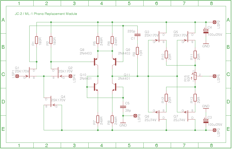

Ok John,
but after some simulations, I realized that keeping the connection of the emitters of the PNPs only, ( removed of the NPNs ), that change beyond increase Open Loop Bandwidth, the noise level remains the same as the original.
I know that is just a simulation but up to now it don´t " lied " to me, in this case.
eD
Missing connection
I don´t think so !
There is no biasing for the NPN transistors as shown on the post #212 ( and #213 ). Wrong connection!
Schematic looks generally OK.
I don´t think so !
I think the connection between R8 and R9 should be removed (John said so, although he said it would work either way.) I suppose you used Toshiba FETs instead of the Fairchild in the schematics. What is the current through the input FETs (voltage across R1 or R2) ? I think the current source would need some adjustment. Did you try to lower the values for R11 to R14 ? I would lower R11 to R14 to 20R each and VR1 to 50R as a start. But I did not try that yet - just an idea.

Hi HCK,
you said you used the original values so R1 = R2 = 100 Ohms. 8.6V through them would be 86mA which is way too much. Are you sure or is this a typo ?
My datasheets for the 2N5459 & 2N5462 say they are Idss 4-16mA, BTW.
8.6V sounds about ten times to high to me.

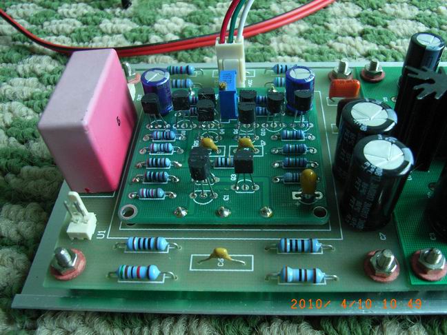

I measured the voltage across each resistor again @ +/- 13v rail:
R1 = 8.1v
R2 = 8.1v
R3 = 3.98v
R4 = 4.69v
R5 = 0v
R6 = 7.39v
R7 = 7.37v
R8 = 7.33v
R9 = 7.34v
R10 = 0v
R11 = 0.2v
R12 = 0.2v
R13 = 0.2v
R14 = 0.2v
Schematic is here:
Please comment, thanks

16mA passing R3.
This should result in 818mV (~8mA) across the drain resistors.
Vr4 + Vr5 =26V. You measure 0V+4.69V
Some thing is seriously wrong with your measurements or your circuit.

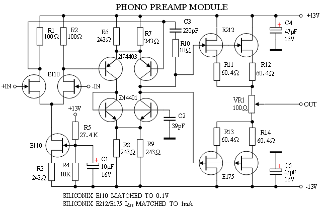

HKC, 8V across a 100 ohm resistor implies 80 ma from the E110, yet I designed the circuit to be about 15 ma from each E110. Sometimes computer simulations make crazy results. I found out about this in 1966, and almost got fired for it.
Hi John
Thank you for the information, I know 80ma is definately too much for the input stage.
I would be pleased to know if the schematic I posted has any drawing error. I believe with a correct schematic the problem can be fixed.
You must use 100 ohm or less for the input load resistors. The circuit will not work properly with more.
Hi John
What is the bias current for 2nd & output stage on the original design? I measured voltage across resistors R6/R7/R8/R9 7.4v/243 Ohm = 30.45ma and resistors R11/R12/R13/R14 0.2v/60.4 Ohm = 3.3ma.
HKC, I think you are outside your scope of competence with this circuit. Please do NOT modify it. The problem is that you changed the 100 ohm resistors to 1K without understanding what you did. Now, please return them to 100 ohms, and all will be well.
Hi John
Thank you for your quick response.
I am not intended to modify the circuit. Actually I prefer to clone it original. I will change the drain resistors back to 100 Ohm and parrelle the JFets to get enough idss which you said is 15ma.
Just change the output resistors to 20 ohms or so. You have too much resistance for the Gm of the output devices that you are using. Please understand, the E110 is a big fet, AND it is NOT made today. The E212 and the E175 are not made in the same package AND the better part, instead of the E212 is the J113 with 20 or more ma, Idss. You are using parts that do not resemble the original parts. SOME changes should be made, but NOT the change that you made. Please remember, this design is 37 years old.
