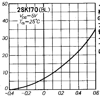

You can slightly over-bias the Toshiba j-fets, because they have such high Gm. They can put out significantly more current than Idss, ON TRANSIENTS. IF you want, you can lower the Idss on the input stage slightly, in order to be comfortable, if one is concerned. Paralleling input devices will work, but little better than a single pair, in this example, and is not mandatory.

Ah sorry, I confused that with the 2SK389. The 2SK369 is a higher Idss part too - the V grade is 14-30 mA and they are 400mW (and they are single TO-92). So the 15mA through them as well as 190mW should not be a problem, I think you won´t need quads in this case.
Where would you buy them (preferably matched) ? Looks like an interesting part.
Do you refer this ?
