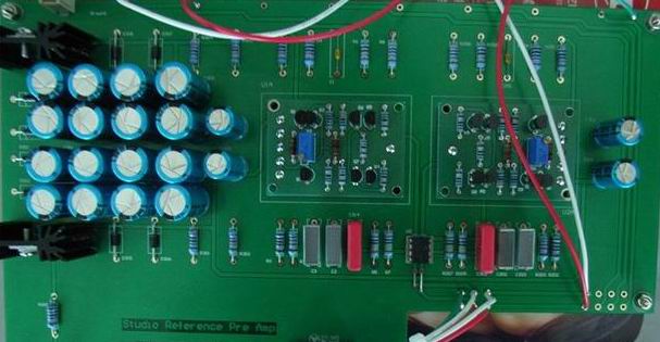

Need to build JC 2 preamp
Just change the output resistors to 20 ohms or so. You have too much resistance for the Gm of the output devices that you are using. Please understand, the E110 is a big fet, AND it is NOT made today. The E212 and the E175 are not made in the same package AND the better part, instead of the E212 is the J113 with 20 or more ma, Idss. You are using parts that do not resemble the original parts. SOME changes should be made, but NOT the change that you made. Please remember, this design is 37 years old.

I changed R1 & R2 back to 100 Ohm
I also changed R11/R12/R13/R14 to 20 Ohm
Now the voltage of each resistors are as follows:

Vr4 + Vr5 = 26.03V. Bingo!
Vr1 + Vr2 = 1.63V. Bingo! Ir1 + Ir2 ~=16mA.
Never change a circuit value unless you can predict what the effect will be. Then, if the real and the prediction don't match up, you know that something is wrong.
If you cannot identify what is wrong because you can't make that prediction, you should not make that modification. Trial and error is not a way to design. But, it is a way to test an hypothesis and turn that into a theory.
After changed the resistors the bias current of the 2nd and output stages also changed. The current seems very low.
For the second stage this was to be expected. The output stage: Did you lower the source resistors (R11-14) already (I would try 10-20 Ohms) ?

For the offset: I have a photo (I think you posted it if I´m not mistaken) which shows an offset of 62mV for an original module, so 80mV probably is not so bad. What value do you use for VR1 ?
The current of the output stages is too low anyway, higher Idss parts (and lower or no source resistors) will give more voltage drop across VR1 and thus more room for offset adjustment.

Yes I sent you the photo which I got from a web page of a Japanese ML user. The value of VR1 is 100 Ohm as specified on the circuit.
I will try to use higher idss parts which John said better be higher than 20ma or lower the source resistors to get more current for the output stage. I will advice.
The voltage I have from the gates of the source followers to ground is 0.55v. Please comment.
Good HKC, now you have a WORKING design. I regret being so (me) in my correction to you, but I had to get your strict attention. AndrewT just gave some wise advice. Now, try 10 ohms for the output resistors, that should be best, IN THIS ONE CASE.

I changed the output resistors to 10 Ohm and here below are the voltage measurements:

The 2nd stage and the output current seems still a bit too low. Please comment.
