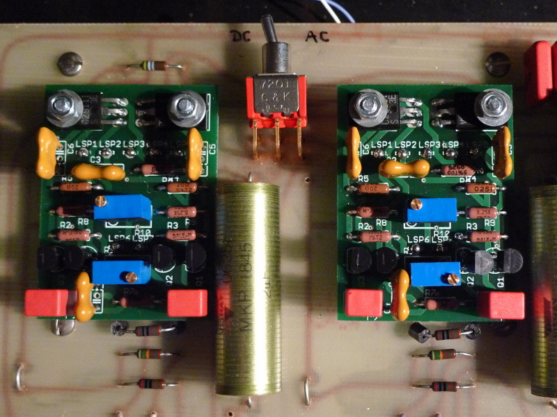

Line modules finished
Eventually I finished the line modules. Many thanks to Erno Borbely who was very helpful
and sent me matched quads of 2SJ74V and 2SK170Vs. He also has the other parts in stock
and much more. Very recommended.
Attached is the final schematic I used. I´ve built a version with Fairchild
2SA1381 / 2SC3503 for test purposes too, seems to work equally well.

Very nice modules, GK7

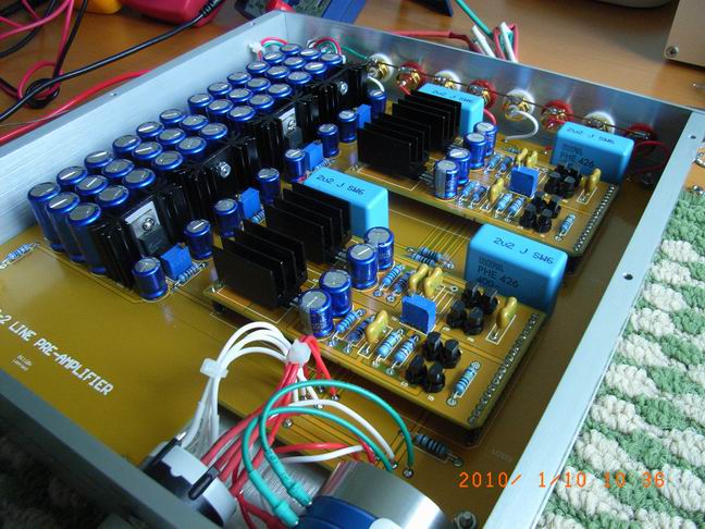

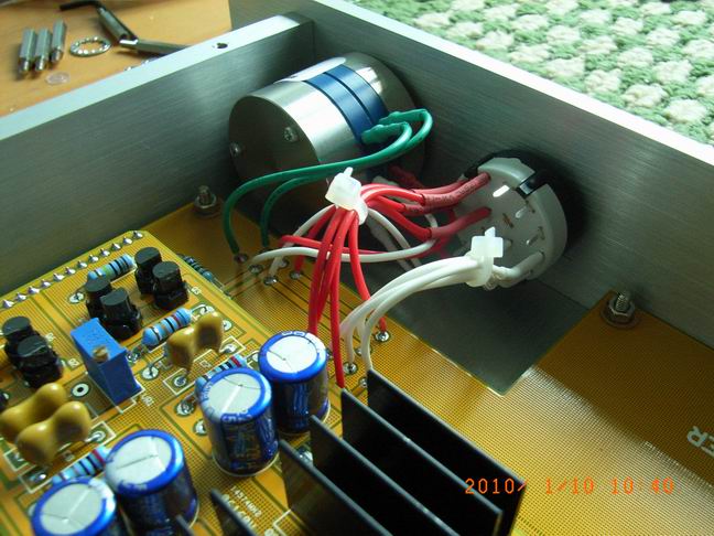

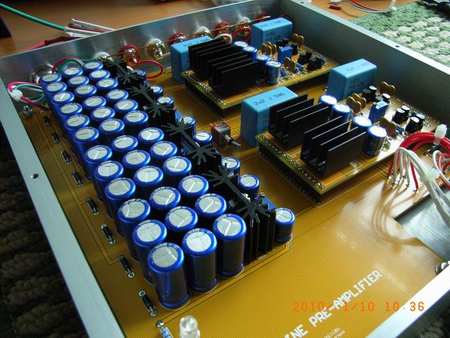

Recently, I also built a new JC-2 line stage with the following modifications:
- new power supply based on JC's published on the Positive Feedback magazine in 1998
- parallel total 4 pairs JFets per each channel
- increased the power rails from +/- 15v to +/- 24v
Nice work! I'd like to see the measurements.

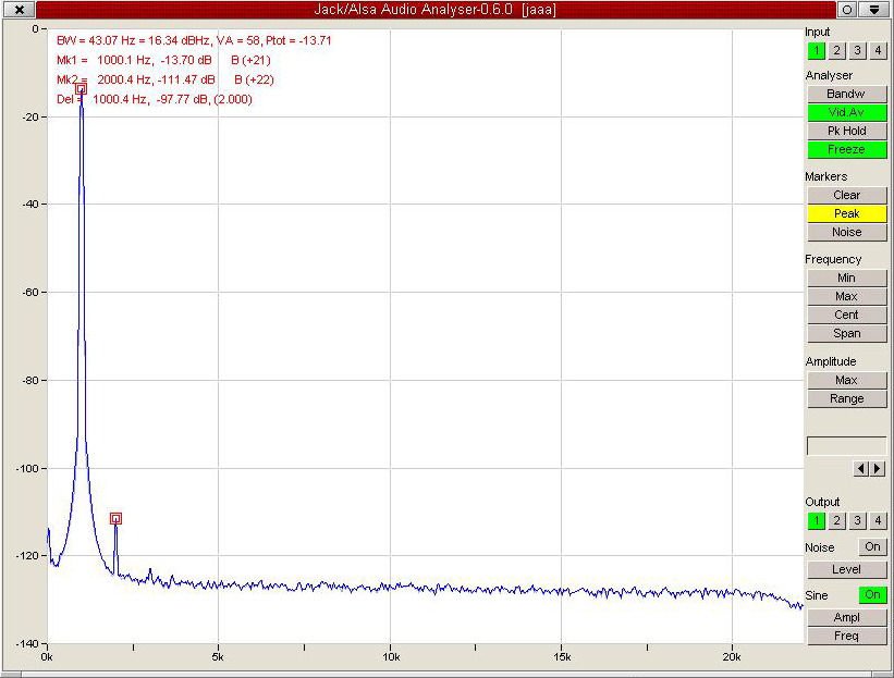

Did some quick measurements recently but as mentioned in post #192
the picture on the (software) analyzer is essentially the same as
that of the D/A -> A/D loop alone. I probably would need a notch filter
to null out the fundamental or if this is not sufficent a lower distortion
source too. Therefore I only post one picture as an example.
But the good news certainly is the line modules do not add extra distortion
to the lowest distortion source I have in my system while adding gain - who
could ask for more.
The 2nd is at -97.77dB (0.0013%) and the 3rd at -109.12dB (0.0003%)
(mesured approximately the same values for the RME ADI-2 D/A A/D converter alone)
The was connected to a RME Digi96 digital i/o card on a linux system.
The ADI-2 inputs and outputs where set to +4dBu.
The software used is jaaa ( Kokkini Zita - Linux Audio interesting
website BTW if you use Linux) which contains a sine generator and a FFT analyzer.
If someone knows a good schematic for a notch filter (yes I know there can
tons of them be found on the net - but it should have sufficient low distortion)
please advise. An AP unfortunatly is not supported by my wallet...

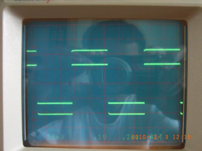

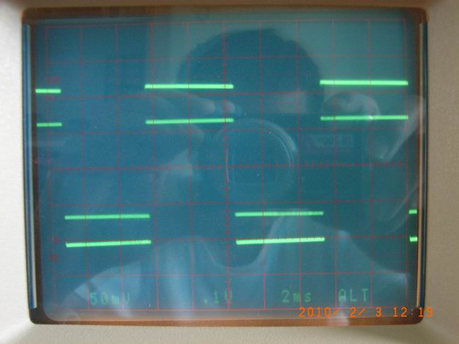

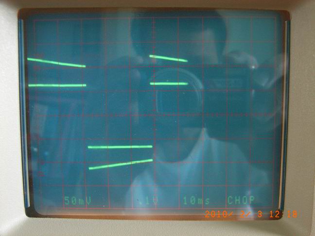

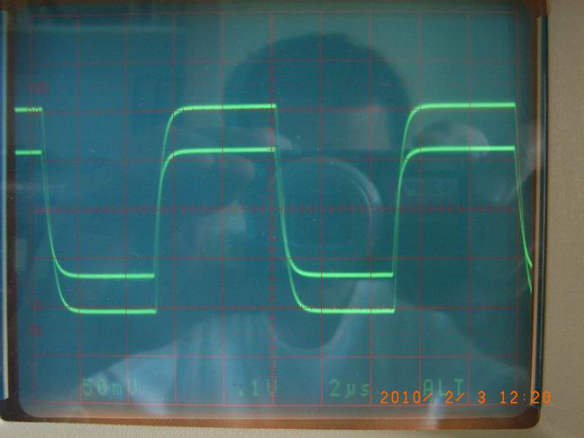

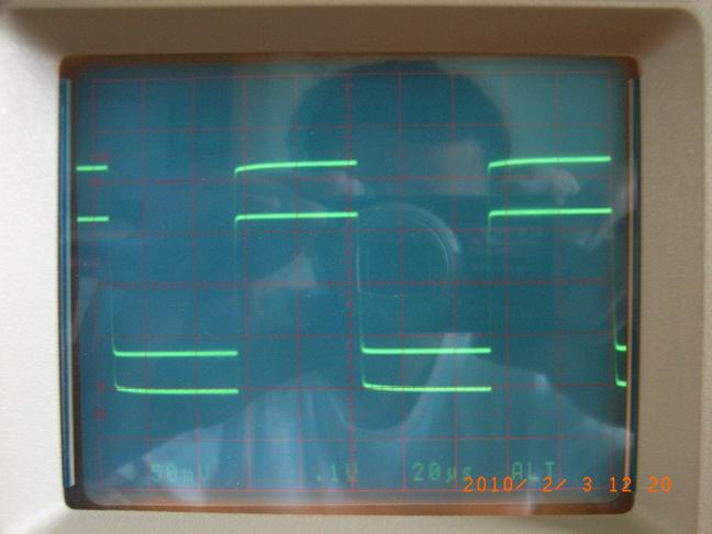

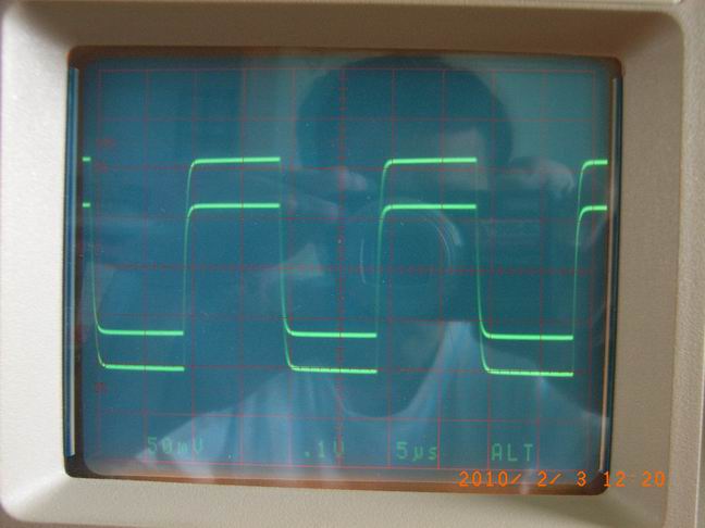

I also measured the sq wave form of my JC-2 in the following order:
20Hz
100Hz
1KHz
10KHz
50KHz
100KHz
It was my first time using a oscilloscope. Please comment.
