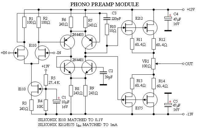

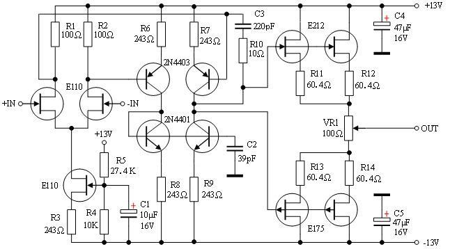

Got the following information about the phono stage from Rolv-Karsten Ronningstad at marklev.com:
I am pretty sure that the connection between the emitters of the 2N4401 and the 2N4403 transistors in the second stage of the "phono" module should be removed.
Would anyone give comment for this?
john curl said:You are correct.

Really for the 2N4401 _and_ the 2N4403s ?
For the two 2N4401 which form a current mirror this is clear, the connection between their emitters is wrong and must be removed.
But the two 2N4403 form a differential amplifier, which they would not be anymore if you disconnect their emitters.
I´m pretty sure that only the connection between the emittors of the 2N4401s (current mirror) should be removed, other than that the schematic is correct.
john curl said:Either way, or both would still work.
Which variant was choosen in the original circuit, this one:

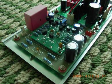

Hi guys happy Easter
I finished soldering the phono stage this morning. I got the following measurements across resistors. I changed value of R1 & R2 from 100 Ohm to 620 Ohm due to JFets idss. Other resistors values remain unchanged.
idss currents of the JFets are as follow:
Q1/Q2: 5ma
Q3: 9.5ma
Q8/Q9: 5.5ma
Q10/Q11: 5.5ma
R1: 620 Ohm = 3.5v
R2: 620 Ohm = 3.5v
R3: 243 Ohm = 2.8v
R4: 10K = 3.3v
R5: 27.4K = 0.01v
R6: 243 Ohm = 3.2v
R7: 243 Ohm = 3.1v
R8: 243 Ohm = 3.1v
R9: 243 Ohm = 3.1v
R10: 10 Ohm = 0v
R11: 60.4 Ohm = 0.2v
R12: 60.4 Ohm = 0.2v
R13: 60.4 Ohm = 0.2v
R14: 60.4 Ohm = 0.2v
Output offset = 0.022v
Comments are welcome.

Some voltages across resistors have been changed after 30 minutes run in:
R1 = 4.8v
R2 = 4.8v
R3 = 3.8v
R4 = 4.6v
R5 = 0.015v
R6 = 4.15v
R7 = 4.15v
R8 = 4.1v
R9 = 4.1v
R10 = 0v
R11 = 0.2v
R12 = 0.2v
R13 = 0.2v
R14 = 0.2v
Output = 0.9v I can not go lower by adjust the 100 Ohm VR
Please comment

Phono Module Offset
On my two Phono Modules (ML-1) I have measured this offset voltages:
about 10s after turn on: 87 mV and -24 mV
about 10 min. after turn on: 84 mV and -23 mV
In short: not much drift over time but substantially lower than the values you have. How close have you matched the input FETs ?
BTW, offset voltages for the line modules are 2.6 mV and 8 mV (after 10 sec.) and 2.3 mV and 3.7 mV (after 10 min.). (They have a DC gain of 1 due to C18 and an offset adjustment pot).
