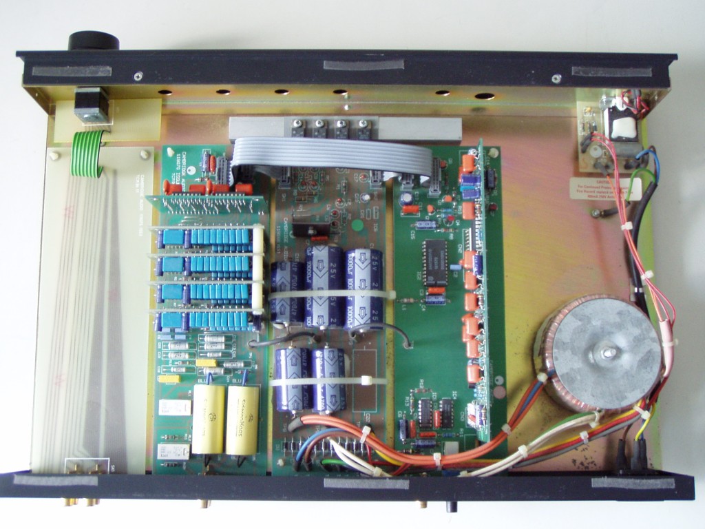

Dac 3
Top view of DAC 3 in attachment
Does not seem very different to CD3

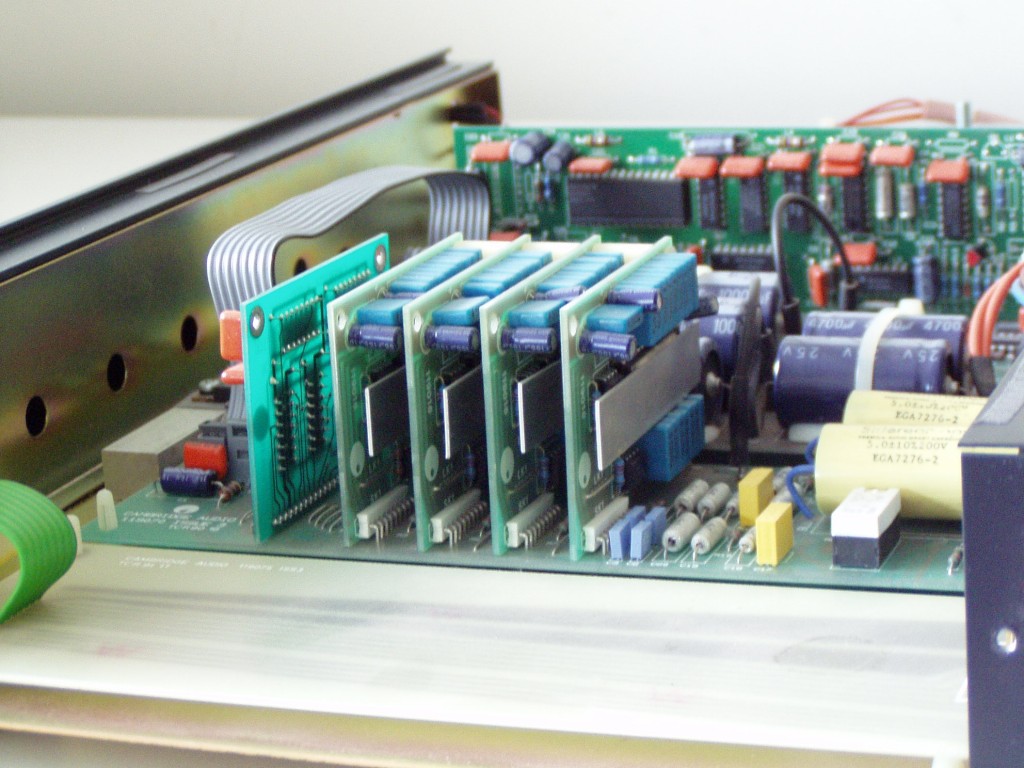

Bringing this back to life, as I recently bought a faulty CD3.
The schematics are now available at HiFiEngine.
Mine has a faulty shift register chip - just one, but I will replace all 6. I'll take photos of the bare PCB when I strip the old ones out if there's interest?
Mine has the same 6 chips fitted; SN74LS166N
Richard
For posterity - here's the shift register board of the CD3 without the chips so anyone who needs to can follow the traces;
Mines now working, and has had a full recap. Just tracing down a new display unit - it flickers mostly.
