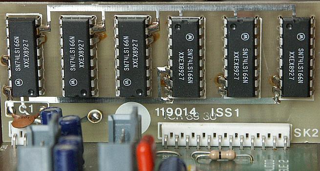

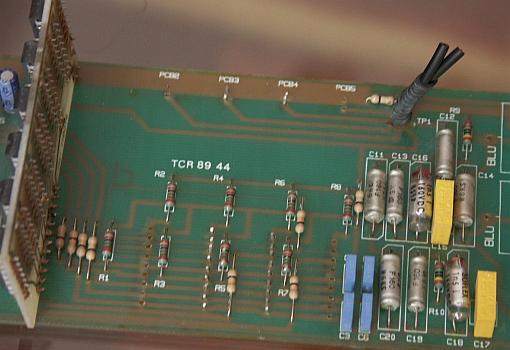

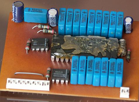

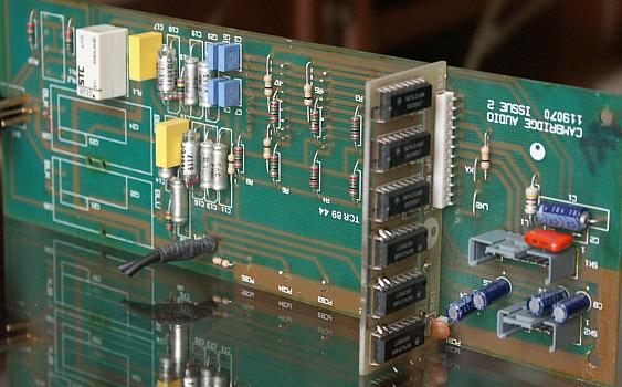

Now, what I have is actually not a "CD3" but a "DAC3". I always thought that the interiors were the same, but evidently they are not.
(This DAC3 is actually a strange bird, because Cambridge also made a DAC3 with a very similar box, but not quite the same, that had a double TDA1305 converter...)
Here's the picture of the card that I copied:

Thanks for the clean schematic!
One connection was missing in my posts 23, 24: pin1 of IC6 to the lonesome inverter, pin13 of IC1F.
Also check the other additions from post 25.

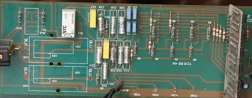

Now, I need a high resolution top and bottom image of the TTL and DAC boards as well as dimension of boards to produce exact copy (how inventing of me😀).
I can definitely do better pictures than the ones I posted.
But not the back of the cards, which is not accessible unless they are desoldered, which I'm not going to do :whazzat:
I can clean up the sketches I made by hand, which will give an idea of the physical routing. It's just gonna be slow, because I was currently busy on things quite away from digital (a tube amplifier for my Stax headphones :yummy: )
Will you give us the .sch files?
OK, I've updated sch to recent correction.
pilli said:
I'll have a look at the real thing :snail: , but wouldn't it be logic to think that the input to the inverter is BCK (buffered and redistributed); the input to the "A" flip-flop is Word-Select (straight out to DAC-I, shifted/inverted to the other DACs); and the input to the "B" flip-flop is Data (straight out to DAC1 and shifted more and more to the other DACs)?
Output from SAA7220 is wired now as per yours sugestion. Please, just check with DVM real thing to be sure.

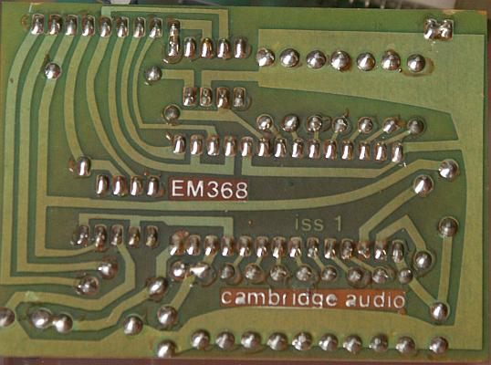

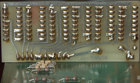

If you put some light (a lamp) from the back of the TTL board, trases will be more visible from front of it, so you can take a picture and/or take a sketch by hand.

CD-3
I put here some pictures from the CD-3 DAC PCB.
I've checked the connections from the receiver/oversampling card of the DAC3, and hey! that was correct, I'm very proud 🙂
So:
Pin 1 of the 7404 has BCK
Pin 2 of 7474 has WS
Pin 12 of 7474 has Data
