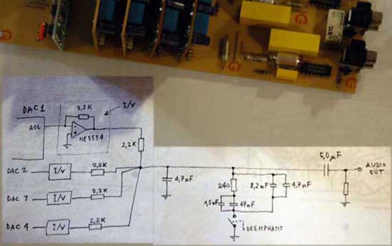

Cambridge CD2/CD3 output stage
...OK, I found it in a drawer.
Sorry for the "low-fi scan" (a picture actually), I don't have time to draw it better right now. And I do not guarantee that the diagram is 100% accurate...
(Above the diagram is a piece of the DAC card of a Cambridge CD2, same structure as the CD3, just implemented much worse...)
Gaetan, in you previous post you say "...only use 4x TDA1541A chips, so I would find easyer to use a simplified version like the CD3 digital section and the shift registers part, but not the 4x oversampling".
I'm not sure I understand you completely, but I think that the very simple output filter of the CD3 (is that a first order?) only works with 16x oversampling. If you have "less" oversampling, you may have to start the lowpass much lower, so a steeper filter.
If it doesn't come earlier from someone else, I may find the time to trace the shift-registers part for you. Can't promise, though...

gaetan8888 said:Hello Pilli
Ps; I presume that your drawing are the section after the shift registers part of the CD3 ?
Yes, long after.
This is the output stage, when the signal is analog.
The whole chain is
CDM --> SAA7210 --> SAA7220 --> Shift-regs --> DACS --> I/V --> Out filter
The diagram is from DAC onwards, and it is just one channel.
Notice that "Shift-regs" splits into four parallel streams (per channel), so there are four DACs and I/Vs (per channel, the TDA1541 is stereo). The four streams join again after I/V, and the out filter is just one.
...er, this is for an integrated player.
A DAC would have an SPDIF receiver or something, feeding I2S to the SAA7220.
Bye.

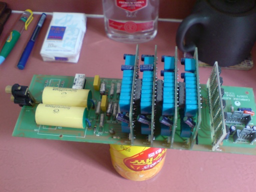

gaetan8888, stoolpigeon:
I have a DAC board but the TDA chips and the output caps removed. I also have a complete functional PSU board. If you are interested, I can sell them for a nominal price, but consider that postage would be from Hungary.

Hello oshifis
I'm interest in your CD3 Dac board, is it include the shift registers part ?
For the PSU, maby stoolpigeon will take it.
I've try to send you an email at the address from your web page, I will try again. If you don't have my email send me one by the email button on my post.
