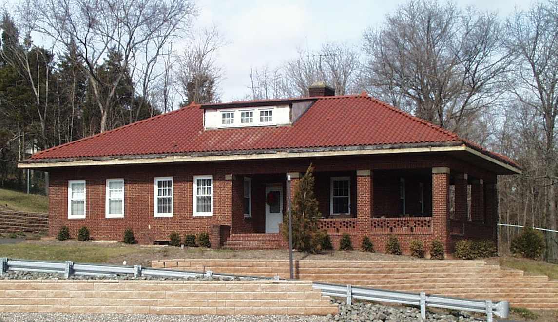

This is the "New Brunswick" building, actually just over the border into what used to be called Easton, now Somerset/Franklin. Distinctive style. This was the office. The transmitter buildings were torn down in 1950s and 2002. The guard rail and block walls are new, added when a self-storage facility was built behind this building.

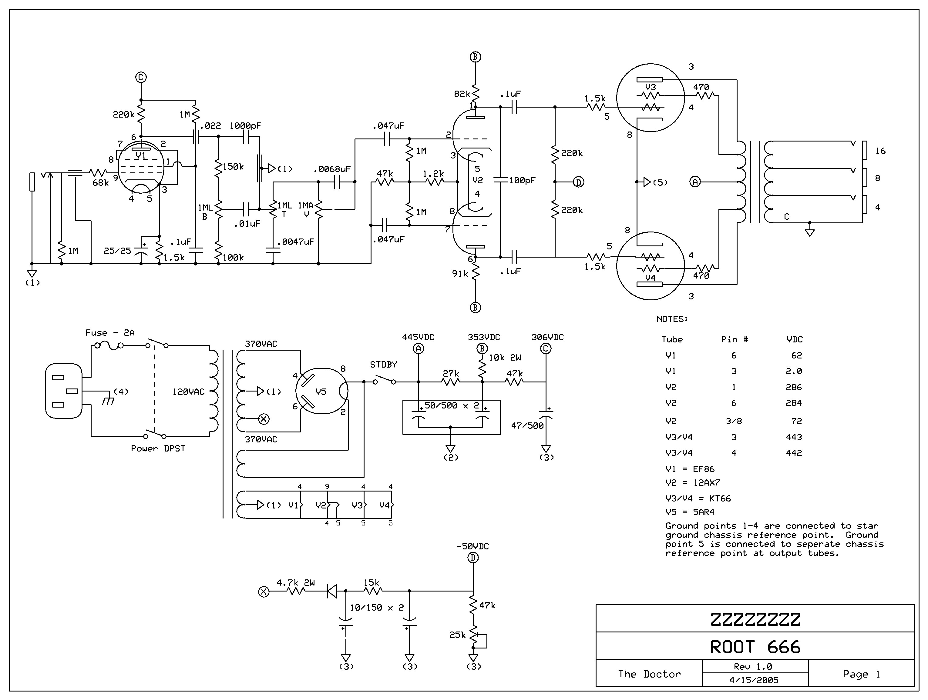

While we're on the subject, here's a schematic of another amp with an EF86 pentode in the preamp. I'd looked into this one thoroughly whilst researching for what changes I could make to the tone-stack on my amp. Lots of Youtube videos on this one out there since it was a mass produced amp for several years before being discontinued. There are some similarities in concepts and ideas here to what was already happening in my amp. If the Fender TS mod doesn't work out on my amp, something like this may be the fallback I go to. But I'm hoping the Fender TS works well haha! If I can finish those changes this weekend we'll find out soon enough
