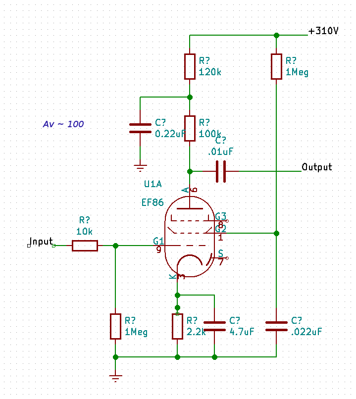

I found a clean schematic of the VOX AC15 EF86 input stage at SluckeyAmps.com, with DC voltages on it. That let me work out the operating point, and some other details (in the attached image.)
The stage has a measured voltage gain of 220, and uses a 220k anode load, that tells us the transconductance is 1 mA/V at this operating point. This in turn tells us the effective "internal cathode resistor" is 500 ohms; and that tells us that the external cathode bypass cap should be about 4 uF for full guitar bandwidth. (The original value of 25 uF was obviously intended for Hi-Fi, not guitar, so bandwidth goes down below 20 Hz.)
The original 220k anode load drops most of the available DC voltage across itself; about 205 volts across the resistor, only 95 volts across the pentode! This is more clear evidence that the circuit was never designed for guitar - it's going to clip extremely assymmetrically, with negative swings at the anode clipping long before positive swings. The designer was obviously going for maximum possible voltage gain, and expected input signals would be very small (much smaller than modern guitar pickups can put out.)
Working backwards: the anode is at 95V, and might be able to drop as low as, say, 35V. That's a 60V swing, so maximum unclipped output signal is in the ballpark of 120 volts p-p. Divide by the voltage gain of 220, and that means the maximum input signal (before the output clips) would be less than 500 mV pp. Guitars with humbucker pickups can put out two to four times that much voltage.
It seems the high voltage gain is also part of the reason for the microphony problems. High gain means high input sensitivity, so the electrodes don't have to vibrate much to generate a signal comparable in size to the input signal, and get the amp howling.
So if we can lower the voltage gain, we might win some ground on two fronts: there should be less unwanted clipping of the input stage, and less microphony.
Thanks to the lop-sided bias point, this looks very easy to do with minimal changes. Simply splitting the 220k anode load into two (120k + 100k) and bypassing the junction to ground with a capacitor should drop the voltage gain to around 100x, instead of 220x. It will also reduce the extent of the assymetric clipping, though I can't tell how much without building and testing it.
The second attached image shows the rather slight changes that I think might make a flubby, woofy, howl-prone, EF86 input stage a bit better behaved.

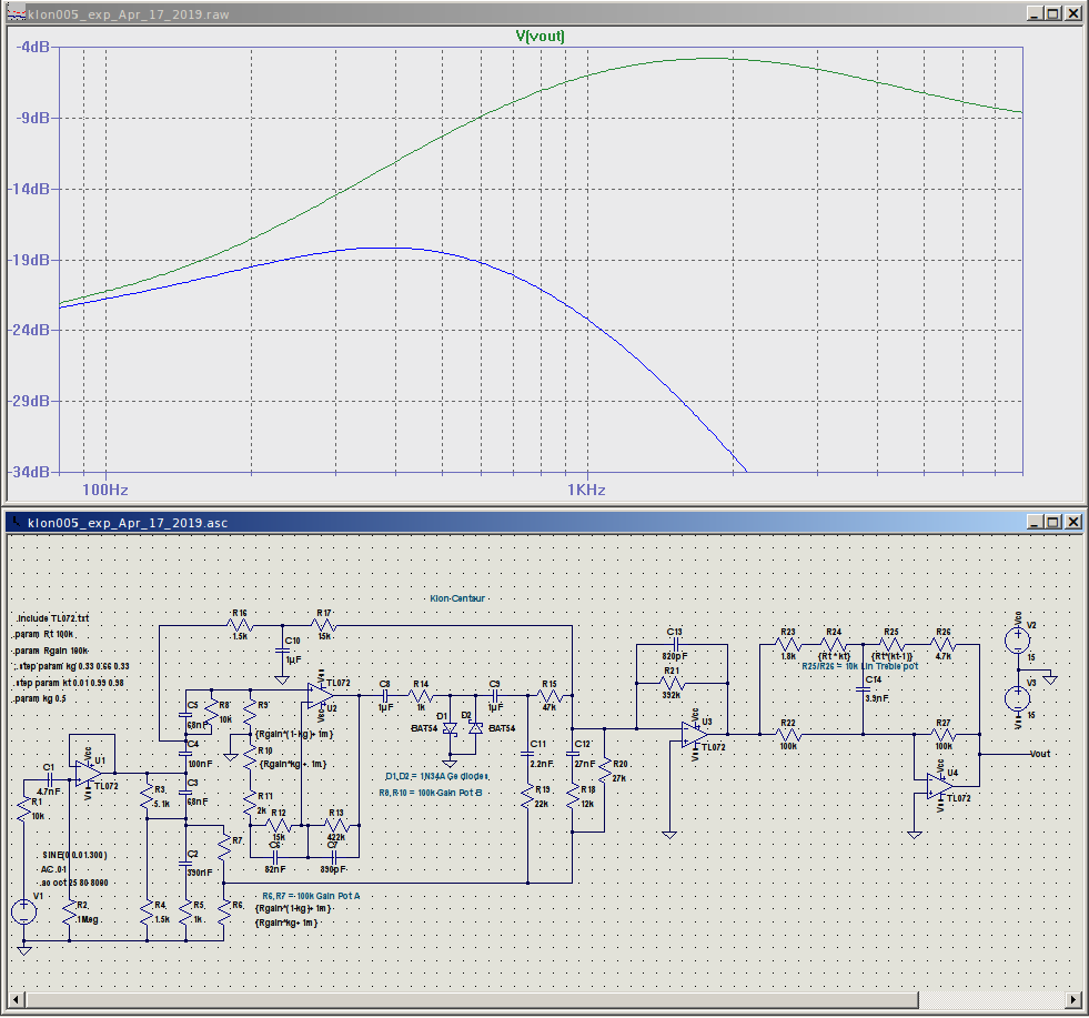

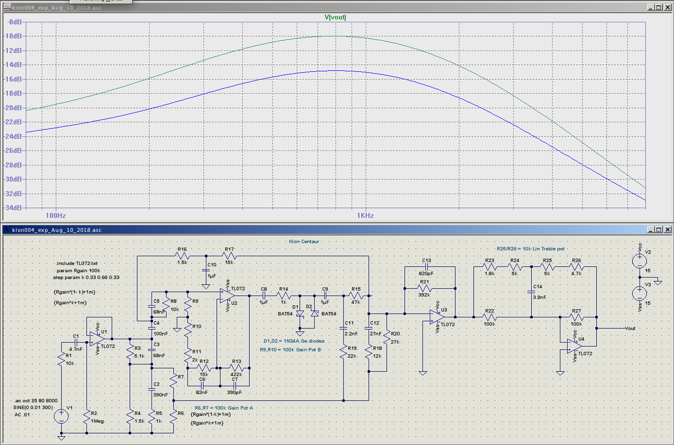

By the way, sometime in 2018 I simulated the entire working circuitry of a Klon in LTSpice. As the attached image shows, the Klon "mid hump" is centred at 800 Hz...that might prove useful in tweaking your tone stack, perhaps.
If you post the schematic of your tone stack, I can run that through LTSpice too, so we can see where the notch is, and maybe what component values to tweak to move it to 800 Hz.

I went back and tweaked my model so this time LTSpice twiddles the virtual "Tone" pot rather than the "Gain" pot. The result is attached. As you said, the hump goes as low as 400 Hz, and as high as 2 kHz!...I think I remember reading that the Klon treble knob began its sweep around 400hz or so as well so the mid hump can increase as treble is boosted or decreased a bit if treble is cut?

That is interesting, quite a bigger sweep than I thought even!the hump goes as low as 400 Hz, and as high as 2 kHz!
