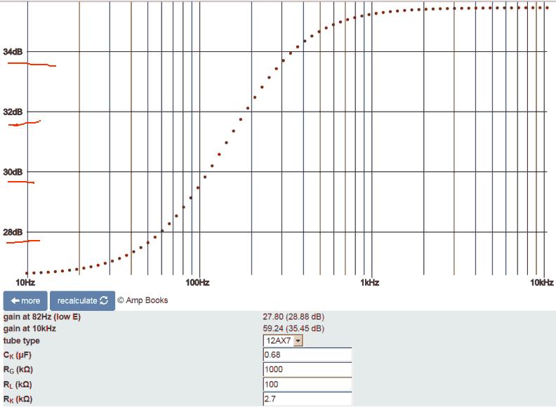

...The omission of any y-axis scale in the online calculator seems inexplicable, though.
It is. I may drop Richard a note.
It seems that if the deviation is "significant", you get scale. However the values we are trying here give only 23.33-23.90 dB spread, less than a dB. The scale seems to be 2dB increments. 0.54dB blows-up so big that the +/-2dB marks are off-graph. Once you realize this unexpected action, you know that "no marks" means "no effect" within the accuracy of guitar amp work which is full of 6dB and 10dB bumps.
If frozen at 2 dB, that is a bad idea. It should re-scale the vertical axis based on maximum and minimum values of the plot.The scale seems to be 2dB increments.
Because of the shape of the shelving-filter response, this is child's play in this case, because all you have to do is find the voltage gain at the lowest frequency (10 Hz), which is automatically the lowest point on the plot, and the gain at the highest frequency (10 kHz), which is automatically the highest point on the plot. No need to hunt through every data point looking for maxima and minima, as you'd normally have to do.
If the intention is to alert the user that there isn't enough gain change to matter, that should be a separate message, preferably overlaid on the graph.
If you do contact Mr. Kuehnel , perhaps you could pass on those suggestions?
About thirty years ago, I got bored one summer, and spent a couple of weeks writing my own graph-plotting program using my housemate's 386 PC and either Quick C or Turbo C, I forget which. Figuring out how to auto-scale the y-axis, and only generate sane (human-friendly) values for the y-axis "ticks" was a challenge, but I cracked it.
As an aside, LTSpice is ridiculously awful at this. It auto-scales, but comes up with things like 0.783 dB per tick on the vertical axis. Utterly ridiculous, and IMO the single worst feature of the software.
-Gnobuddy

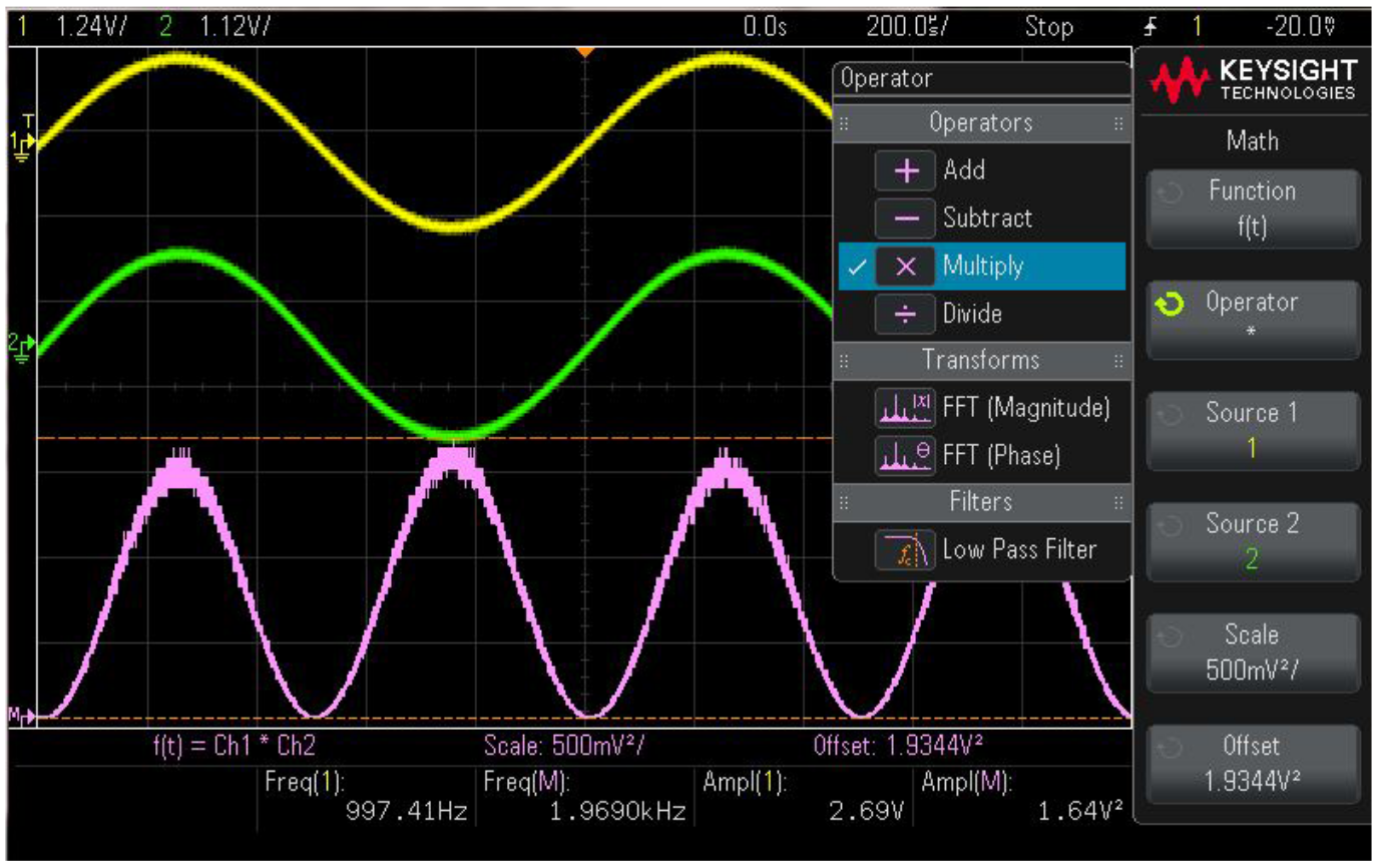

I've been pretty darn impressed with the Keysight (nee Aglient nee HP) 1000 X-series CROs, which start from about US$500 and are built on custom ASICs. The 1000 series are WVGA (even the up to $20K 4000 series are too - but they've some graphics smarts to help too )I
I ended up with a brand new 4-channel Rigol for around $450 USD. It can do many useful digital tricks, but the crappy 7-bit vertical resolution of all the affordable digital scopes is frustratingly bad. Every trace is jaggy, literally even worse than the stair-step graphic edges we put up with in the 1980s with our shiny new 320x240 computer monitors.

Thanks for the link!...Keysight (nee Aglient nee HP) 1000 X-series CRO
These 'scopes seem very fast and have been taught to do some clever tricks. Eight bits (vertical) is better than seven, but as the attached image shows (taken from page 6 of the above link), the nasty jaggies are still very much in evidence, most particularly in the pink (summed) trace.
Personally I'd rather have 10 bit vertical resolution (1024 steps) and only 100 kHz bandwidth, but the entire industry focus is in the opposite direction: more bandwidth, more speed, and who the heck needs better vertical resolution in a world where most circuitry is digital?
-Gnobuddy
I was vague earlier, but there really are some useful digital tricks. One of them is measuring and displaying peak-to-peak voltage at the push of a button (you don't have to count graticule divisions, multiply by volts/div, carry the 2, forget the 5, and wonder how you came up with 39 million volts. )I don't think I'll need something capable of "digital tricks" for my new hobby just yet, but on that note...
Another great trick is that my Rigol has four channels, and each of the four traces on screen has a different colour, so you can instantly tell what's what. Imagine simultaneously monitoring power supply voltage, screen grid voltage, input audio on the control grid, and output signal on the anode. You can really see "sag", output clipping, what the screen grid resistor is doing, etc.
There are other good tricks too, some which I haven't used yet. Like a one-button FFT (Fast Fourier Transform), which shows you harmonics in the signal as you overdrive a valve. And since it's digital, it's also a storage oscilloscope - you can hit the amp with a single guitar note, and capture and freeze the amps response at up to four different circuit nodes to study at your leisure.
