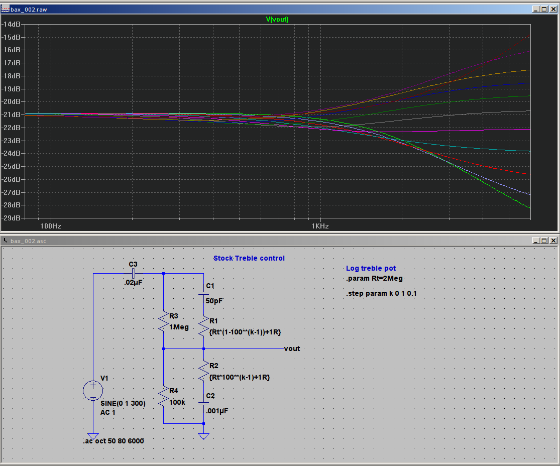

I put the essentials of your treble tone control circuit into LTSpice, and simulated the frequency responses that would result....the values of the capacitors around the tone pots are not ideal for guitar signal.
<snip>
The bass is overwhelming everything unless I cut it out almost entirely.
First, the stock circuit. As you said, treble adjustments start above 1 kHz, which is suitable for Hi-Fi, but not for guitar:
-Gnobuddy
I'll say up front that tweaking guitar tone controls is something I've personally found quite frustrating, and sometimes fruitless. So I'm not sure the changes I'm about to suggest will make you happy. But perhaps they'll at least suggest a starting point, so here goes!
Since you already have 2 Meg pots, and they are in working condition, I think you might as well keep them unless you find it impossible to get the results you want. New pots may produce new problems (changes in control feel, knobs not fitting, et cetera.)
So, what can we do with the stock 2 meg treble pot? Firstly, your treble Baxandall circuit will still work the same way if you increase or decrease both caps (50 pF and .001 uF) by the same ratio. In this case, we want bigger caps, so the tone control starts to work at frequencies lower than 1 kHz, where e-guitar still has enough output to be worth tweaking.

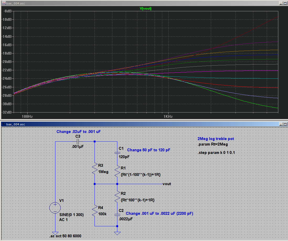

My suggestion is to increase the 50pF cap to 120 pF (i.e. multiply its value by 2.4 times). At the same time, increase the 0.001uF to 0.0022 uF (multiply it by 2.2, the nearest standard value).
By the way, 0.0022uF is the same as 2200pF, or 2.2nF. (For some inexplicable reason, we never use the SI "nano" prefix for caps in North America, so we use the clumsier and technically improper 0.0022uF or 2200pF terminology instead.)
This will move the effective range of the treble control down by a bit more than an octave, so it starts to have an effect above roughly 400 Hz, rather than only above 1 kHz.
You can of course try the same trick with other values, remembering to try and scale the original 50 pF and 1000 pF (0.001uF) caps by roughly the same factor each time. For example, you could try 180 pF and 3300 pF, or 220 pF and 4700pF, which will move the treble controls effective range even further down towards low frequencies.
Now let's consider the other problem - the overpowering bass. This is a common issue with guitar amps derived from Hi-Fi circuits. Leo Fender made the same mistakes with his 5E3 when he lifted Hi-Fi cap values from the back of the GE tube catalog, for instance.
Since you're working on the treble tone control circuit already, let's see if we can cut some bass there. The 0.02uF cap that couples the signal into the treble control pot (from the anode of the 6FQ7) is the obvious place to cut some bass. Based on your report of overpowering bass, I suggest replacing this with a 0.001uF (same as 1 nF, or 1000 pF). This drastic reduction (twenty times smaller!) will gradually roll off deep bass below 150 Hz or so.
As before, you can, of course, tinker with this to taste. You can reduce it even more if you still have too much bass, or increase it from 1000 pF if you now have too little bass.
The attached image shows what LTSpice predicts using the starting values I suggested in this post: 120 pF and 2200 pF on the tone control pot, and a 1000 pF coupling cap.

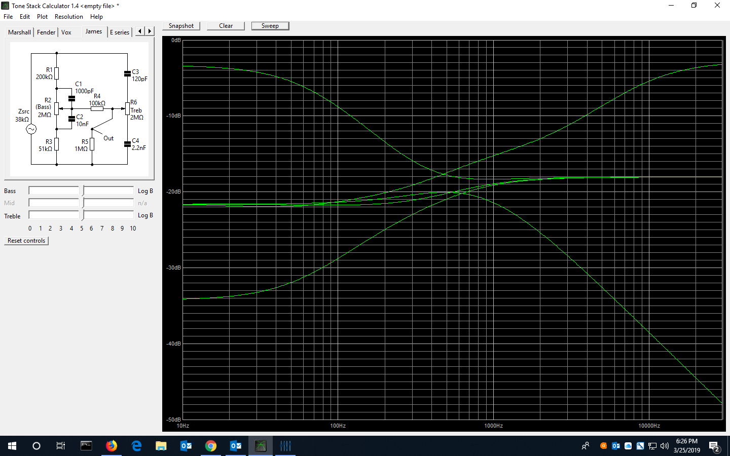

Put it this way, Tone Stack Calculator is a fantastic tool compared to what engineers had in the tube era. So much better than writing down equations and running numbers through a slide-rule!...LTSpice...Tone Stack Calculator...
That said, LTSpice is on another level altogether. It has a history going back to the early 1970s, when SPICE was created by genius researchers and grad students at Berkley University. LTSpice was the tool used in-house by Linear Technology engineers to design their integrated circuits. So it's incredibly flexible, incredibly powerful, and because it has such a long history of professional development and use, we can put a good degree of trust in most of what LTSpice predicts (though no simulation will get everything right.)
I started trying to teach myself to use LTSpice a few years ago, using tutorials I found on the 'Web. By the time I got as far as simulating guitar tone control circuits, I was starting to see discrepancies between what LTSpice was telling me, and what TSC was telling me. Sometimes TSC would produce lovely symmetrical tone control EQ curves, while LTSpice showed erratic curves that clumped together at one end of the pot's rotation.
At that point I stopped using TSC altogether, because I wasn't sure I could trust it. Also, LTSpice was capable of simulating experimental or unusual tone control circuits that didn't exist in TSC.
The tone control you're looking at is one such example. In your amp, the bass and treble controls are separated by an active gain stage. So they don't load each other in the way that the TSC simulation expects. This means the TSC simulation is definitely wrong - but I don't know exactly how wrong. Ten percent? Twenty? Fifty? I have no idea.
Interestingly, there are details in the LTSpice sim I just did that are missing from the TSC predictions you posted - for instance, LTSpice predicts some of the treble curves actually cross each other. TSC doesn't. Also look at the lowest treble curve in the two simulations: they don't match!

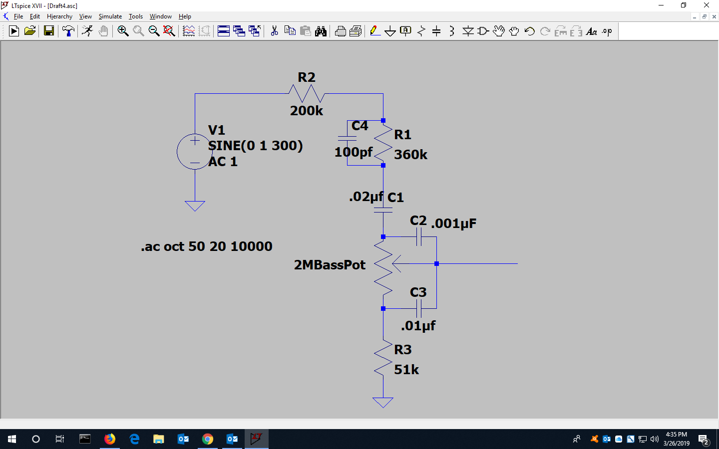

Upon further research yesterday and today I believe I agree LTSpice is the best way to go. I started down the youtube tutorial rabbit hole and was able to recreate the bass half of my tone stack (screen shot attached below). I should be able to recreate the treble half too in order to simulate the whole TS circuit, but now my current problem is how to simulate the triode that is boosting the signal between the two pots. Is there a good way of doing this in LTSpice that you are aware of?
I think the idea of replicating the Deluxe Reverb tone stack is growing on me the more I look into it. It's a decidedly mid scooped sound but a little less so than the other blackface amps of the era since the mids are fixed with a 6.7k resistor instead of an adjustable pot. I like how this keeps things from getting too hollow sounding but still allows a mid scoop that plays nice with all the overdrive pedals out there that offer mid humps when engaged. I understand the Fender TS loads down the signal a lot more than a James TS, but I think we have plenty of gain stages with which to recover signal before it is sent on to the output tubes. If I were to do this where would you suggest placing the tone stack? I'm thinking between the 2nd EF86 and the 1st 6CG7 triode might be best?

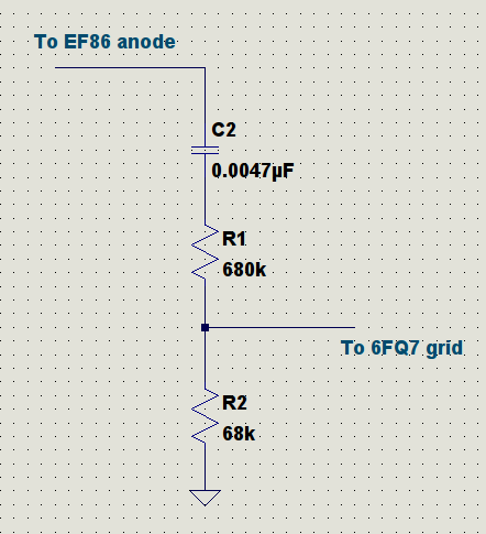

I would suggest inserting the entire tone stack where your treble control is now. The reason is that EF86s, being pentodes, have much higher output impedance than 6FQ7 triode gain stages....Fender TS loads down the signal...where would you suggest placing the tone stack? I'm thinking between the 2nd EF86 and the 1st 6CG7 triode might be best?
In your circuit, the EF86 driving the bass control has a 68k anode load resistor. Pentodes have an extremely high internal anode resistance ("plate resistance"), so we can expect output impedance of the entire pentode stage to be not much less than 68k.
For comparison, a typical half-12AX7 triode stage with a 100k anode load has an internal anode resistance of maybe 70k. The output resistance of the entire stage will be 70k in parallel with the 100k external anode resistance, or roughly 40k.
Meantime, a 6FQ7 has an internal anode resistance of around 7k - 8k according to the datasheet I just looked at. This varies with operating point, but still, we can expect your 6FQ7 with 100k external anode load to have an output impedance of less than its internal anode resistance - just a few kilo ohms. It was born to drive heavy loads like Fender tone-stacks!
When you remove your bass tone control circuitry from in between the EF86 and 6FQ7, you should probably insert a pair of fixed resistors there, to cut down the signal by about the same amount as the bass control used to. Cut it down to roughly one-tenth as a starting point. Without this, you'll probably have much too much preamp gain, and lots of buzzy overdrive from the 6FQ7.
