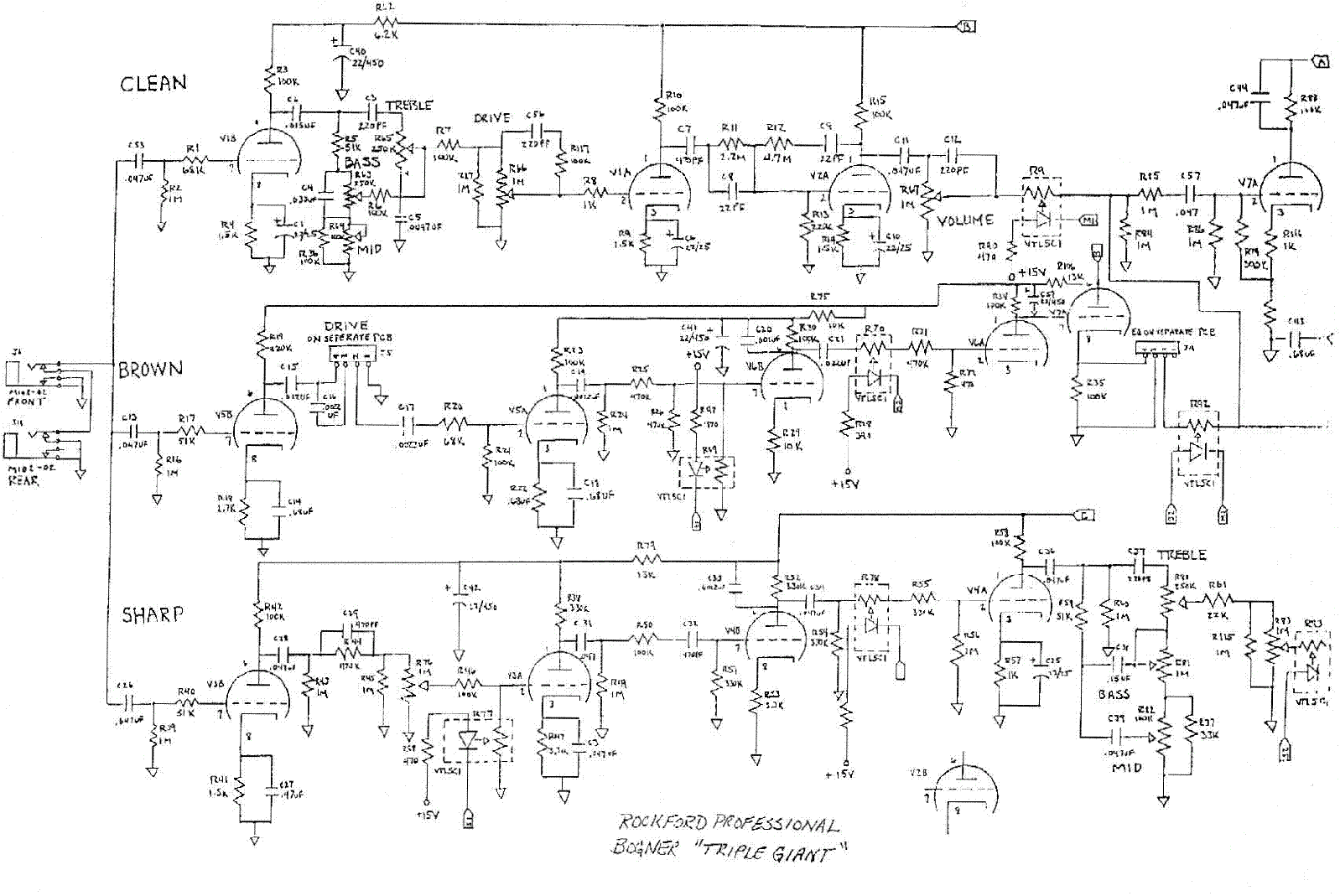

It seems to be true that guitarists like such a chain, with gains of about 6dB per stage, with some EQ variation between stages. This gives a "layered" distortion, similar to a voice's sotto - sing - scream, or the layers of over-blow in wind instruments. Because no normal tube gives gain of 6dB, and because we need grid-blocks to prevent blocking, and because 12AX7 grow on trees(?), we normally build a chain of stages with pretty hefty cuts between. One fearful amplifier had 7 or 9 such in a row.
...because 12AX7 grow on trees(?)...One fearful amplifier had 7 or 9 such in a row.
Perhaps the Bogner Fish, aka, the Bogner Triple Giant, possibly also aka the Hafler Triple Giant? It contains 12AX7s by the bushel. I counted 14 triodes in the attached schematic, or 7 12AX7s. Leonidas Fender must have rolled over in his grave.
-Gnobuddy

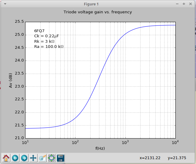

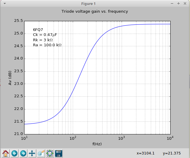

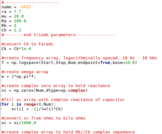

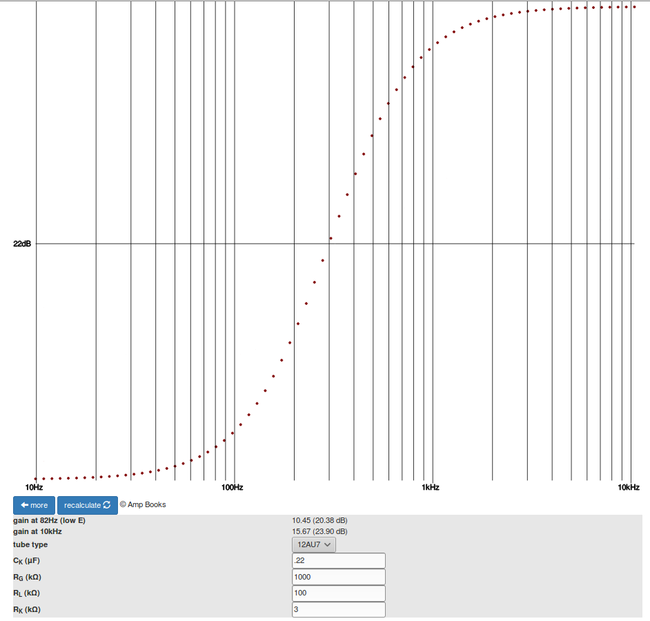

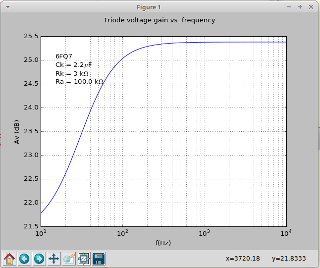

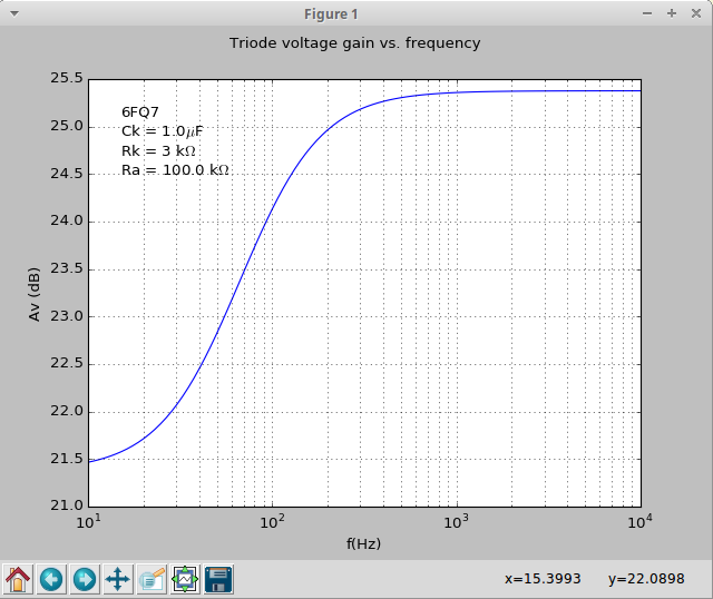

Is the offer for calculating this data when you have the time still on the table?
It is indeed. 🙂
See the attached images. The fifth one is a scrap of my Python code that generated the first four plots. The last image is a screen capture of the 'Web calc that PRR linked.
There's pretty good agreement between the results from my Python program, and the results from the online 'Web calculator. The omission of any y-axis scale in the online calculator seems inexplicable, though.
We can discuss what these graphs might mean in the next post.
-Gnobuddy

So what can we glean from those graphs?
The first thing to notice is that, with this particular valve, and these particular anode and cathode resistors, there isn't a huge increase in gain between the low-frequency plateau, and the high-frequency one. In fact, there is only a rise of about 4 decibels. That's enough to definitely be audible (with the right cap values), but not tremendously so.
The second thing to notice is that 2.2 uF is all it takes to give you *full* bypassing down to the guitar's lowest note. Bass response is down only about half a decibel at 80 Hz - which is completely inaudible. In fact, by the standard audio engineering definition (the frequency at which the response falls by 3 dB), the bass cutoff frequency is down at about 20 Hz!

Now look at the Ck=1uF curve. Bass response is only down about 1.5 dB at 80 Hz, and down 3 dB at around 40 Hz. Realistically, this is still fully bypassed for guitar, and is even adequate for four-string bass guitar.
The next smaller cap value (470nF, or 0.47uF) is interesting. It puts the sloping part of the frequency response mostly between 80 Hz and 400 Hz, in the meaty part of the guitar's frequency range. You should hear this as a reduction in that "overpowering bass" you described earlier.
Finally, the smallest cap I tried, 220nF or 0.22uF. This has a gently rising response from 100 Hz to 800 Hz or so, and should produce even more reduction in bass. Only your ears can tell you if this is too much reduction in bass, just right, or not enough.
Bottom line: you do not need a cap bigger than 2.2 uF under any circumstances. I think you're going to find the cap values that sound best (by reducing the excessive bass) will be somewhere between 1uF and 0.22 uF.
I would be tempted to get two each of 1uF, 0.47uF, 0.22uF, and 0.1uF, and then just try them one at a time to find what you like best. They don't need to be exotic or expensive - only a few volts will ever appear across these, and cheap 25-volt rated ceramic caps are perfect for the job.
