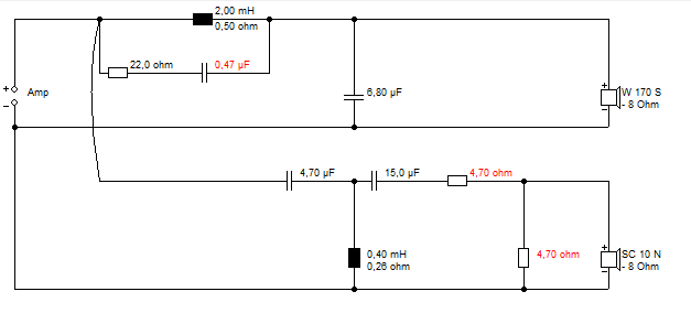

Need help with crossover for Phenomax midwoofer and 3/4" Revelator
Everything is wrong with these circuits. Sorry. Crossover far too low. Impedance is terrible. Capacitors way too big.
You need impedance correction on the midbass. A notch around 4.5 or 5 kHz. Higher crossover. No way the bass coil arrangement should exceed 2mH in total. Trust me.
Ok. But I'm still not understanding how applying a crossover designed for different drivers makes any sense. Plus no, I can't afford to get another tweeter right now. Besides, I don't want to use the CAT378. Why would I? I have a pair of Revelators right here.
You won't be using Mike's crossover. But you will be using his ideas for how to deal with a Scan 5" midbass with a horrible peak around 5kHz. A bit of help with the box too.
He employs essentially a single capacitor on the tweeter for shallow slopes. I can't give out his intellectual property. But your tweeter is less suitable for a shallow slope. Might be possible though.
One Scan 5" is much the same as another. I'm not going to model it, but you can. Changing to 8 ohms from 4 ohms is simple enough. Bigger coils and resistors, smaller capacitors. I have slight doubts if your tweeter level is right as well. I would expect more attenuation, and better applied for good impedance.

I think both these drivers are not the easiest to deal with; I mocked up a 4th order acoustic (3rd order electrical) @ 2.8khz based on the spec sheets; to keep some distance from the woofer breakup and move the tweeter closer to its distortion sweet spot (measurements on HFC here)

On a quick look, you'll probably need something like asymmetric LR4 (acoustical) in the 2.5KHz region. The tweeter really doesn't like going lower than that, & ideally would be better crossed higher, but you've the midbass breakup to deal with. 1st & 2nd order are realistically out; 3rd order Butterworth might work if you don't mind the lobing in the polars, but it puts more stress on the drivers at a given XO frequency as it crosses at -3dB rather than the -6dB of a Linkwitz or variation thereof. Quasi-LR3 (i.e. 3rd order acoustical crossing at -6dB) may work -the driver offsets on a flat baffle can help bring things into line, even though it may not look great assuming common acoustic centres. Chances are you'll need at least 3rd order electrical on the tweeter, plus level padding & a damping shunt resistor (an Fs LCR may be preferable). Midbass may be OK with 2nd order electrical & a tank notch on the primary. Possibly. Depends on how the phase lines up & what the distortion is like through its passband (i.e. how much is amplified by the ~4.5KHz stopband breakup).

Thanks Motokok, that's much appreciated. However I would like it if someone would actually look at my crossover and tell me what's wrong with it that I need to use someone else's. Maybe I should have made the title "rate my crossover".
OK, well from the original, my comments are that the crossover point is too low (tweeter 3rd order distortion is very high at this frequency as per the HFC measurements; it would prefer somewhere like 2.5-2.8khz; also moving further away from its resonant frequency is good practice).
On the woofer section, the notch does not squash that big peak at 4.4khz; it needs to be hammered away; hence I went for a steeper slope; try plugging my values in at least to have a look. The woofer impedance also drops to 2ohms or so at 5k cause the breakup remains.
On the tweeter section, again the notch does not seem to be doing anything useful, and the weird impedance curve of this tweeter is dropping very low with higher frequencies. A CR is a better way to flatten the rising response around 10k and above.
What I tried to do was use a higher crossover point, steeper slopes, bash the woofer breakup, address the rising response of the tweeter.
It should be absolutely fine at 2kHz.
The 8 V drive level results in an SPL of 102dB, which is bloody loud and the low sensitivity of the system, about 80-82dB, is going to really make this limited by the woofers capabilities.
Still 8V at 2kHz is 101dB. With a 4th order acoustic slope at 2k you're looking at 6dB of attenuation at 2kHz if it's designed correctly. This is equivalent to the 4V distortion curve, putting the 3rd order at -53dB, lower than it is at 4kHz.
In a low sensitivity system, with max SPL limitations, I'd happily cross this at 2khz, unless the speaker was going to be abused or also possibly driven by clipping amplifiers.
I was just doing something not a million miles away from motokok's ideas.
The standard tank notch proved useful on a 6" woofer around 5kHz. Usual 1:3 butterworth filter on the 8 ohm tweeter. This is not a design for you, just a demonstration of how the cheap and cheerful RC tank notch can cure breakup. But a proper LCR notch is better usually.

I tried both motokok and system7's circuits. Motokok's for some reason the tweeter level was way down. By the time I adjusted it there were frequency response aberrations in the crossover region I couldn't iron out. Same with system7's. Although yes the slopes were significantly steeper and the woofer bump at 4.5k was no longer visible. I'll see if i can start from scratch and design with a tank notch or higher order slopes.

The tweeter has a naturally sharper rolloff than a shallow slope; try 3rd order, try 4th order.
