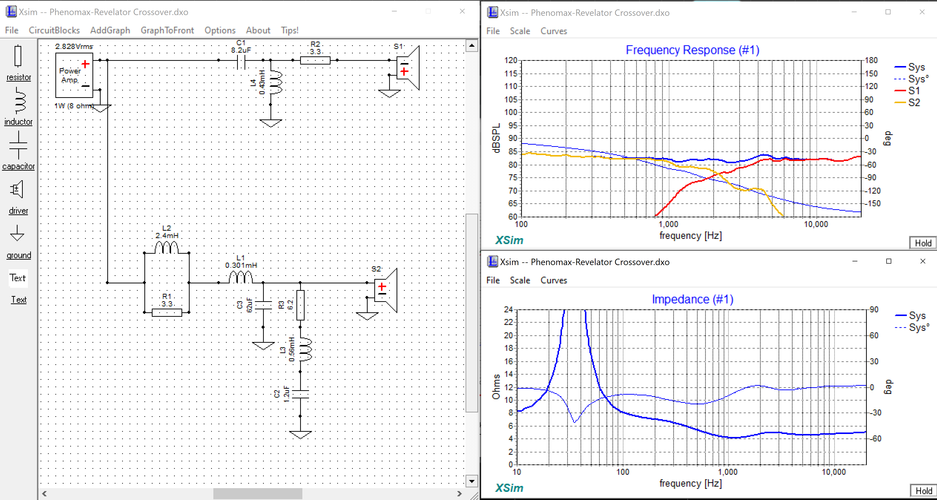

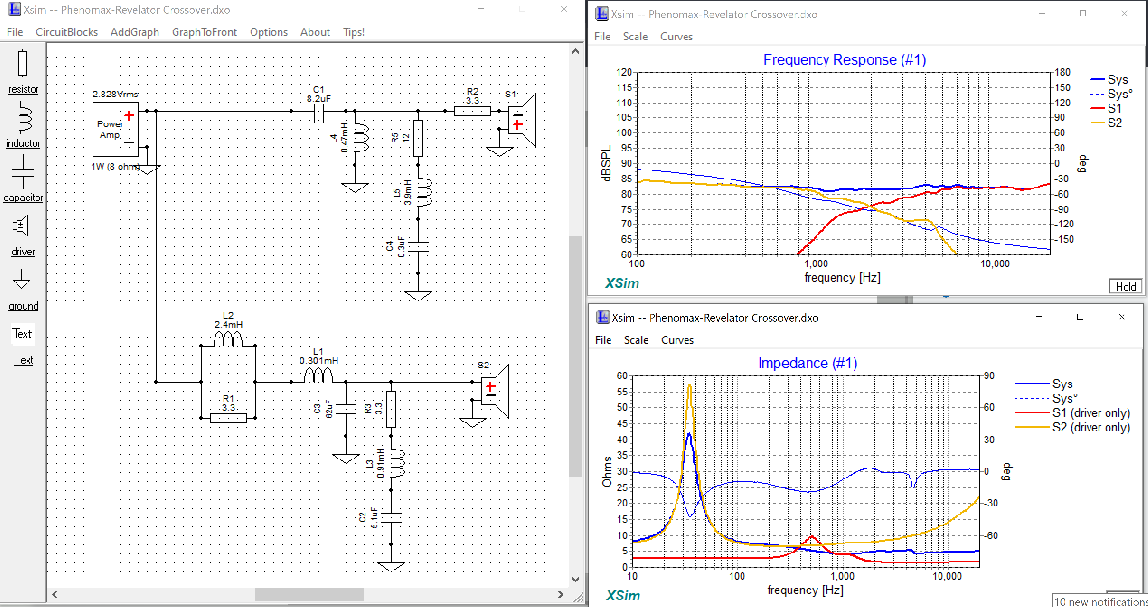

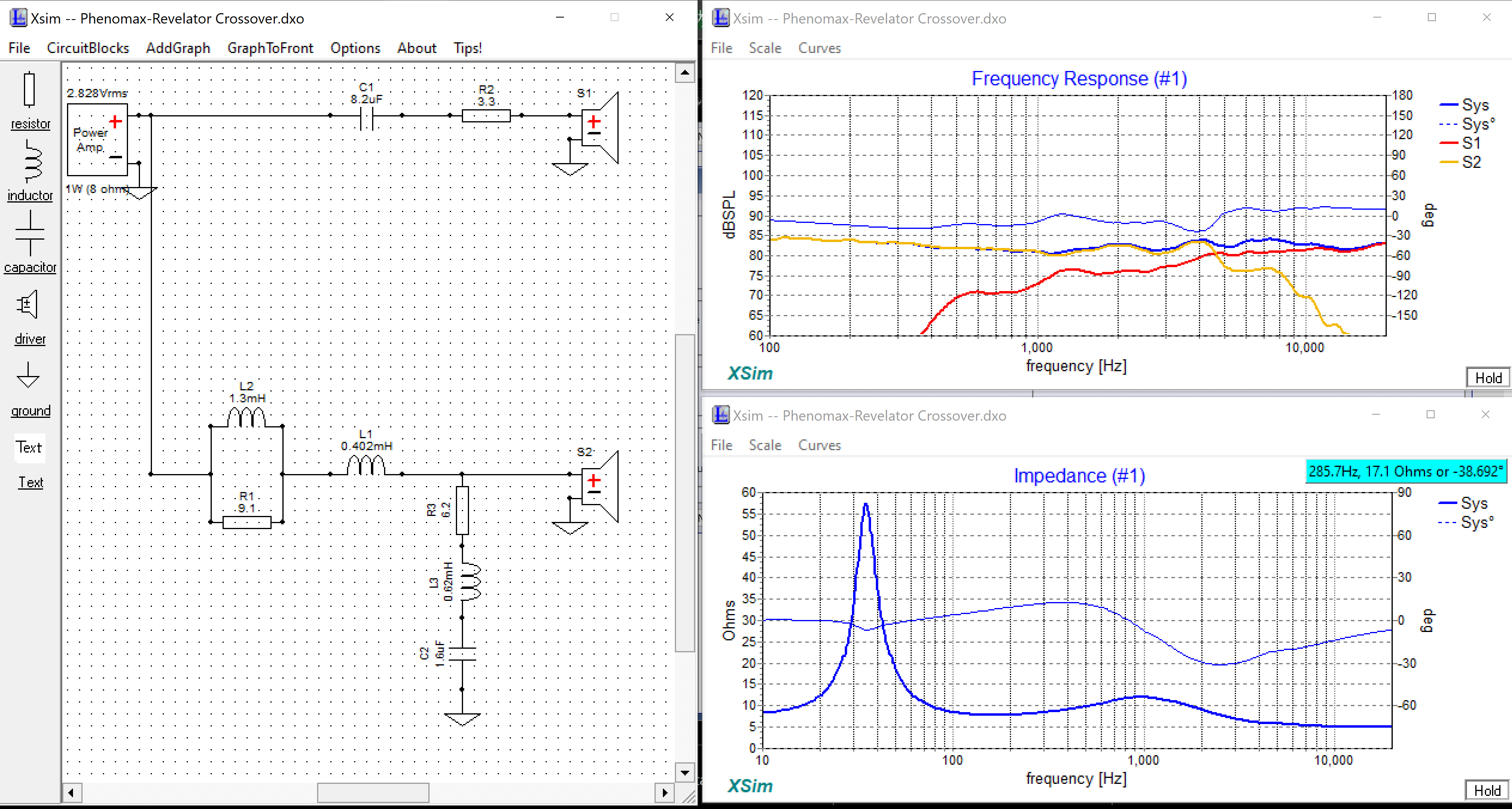

Great, re: the woofer peak, I tweaked the inductor and then the cap value to visibly affect the wonky frequency area, then set the resistor to squash it under the target curve.

OK, I see.
