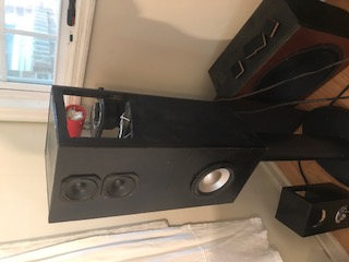

Ok. So I have committed to trying something here. I have built a cabinet along the lines of the Nola Micro Gold. It is 22" tall x 9.5" wide and 10" deep. I am using 2 of the Vifa 3.5" on the top and a SEAS Prestige L16RN-SL (H1480) 6" Aluminum Cone Woofer on the bottom.
I have a MiniDSP but it has broken so I am having to experiment with the crossover. I am running the Vifas full range on the top. I am running a 1st order crossover at 200Hz on the Seas. They sound VERY good. They image well and really disappear. I would love to experiment with the crossover. I am not sure which way to go though.

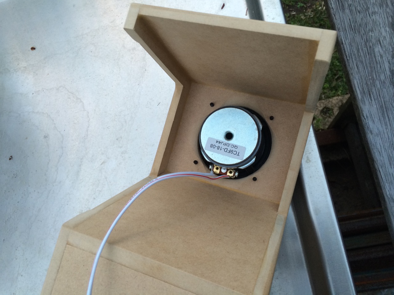

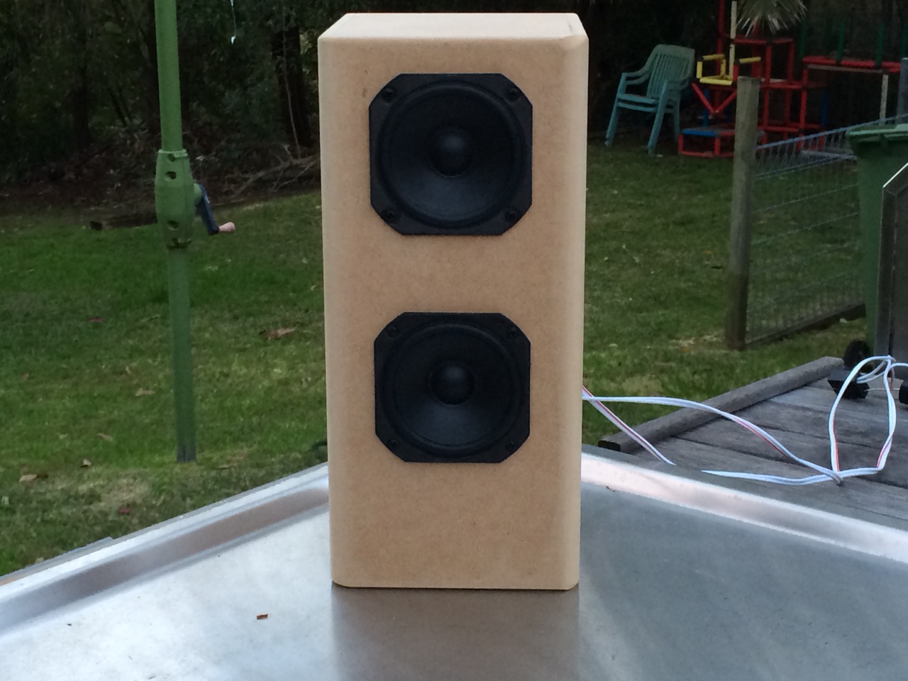

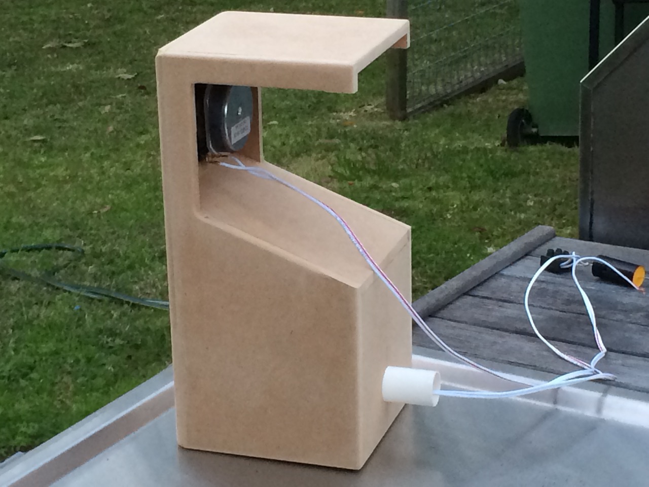

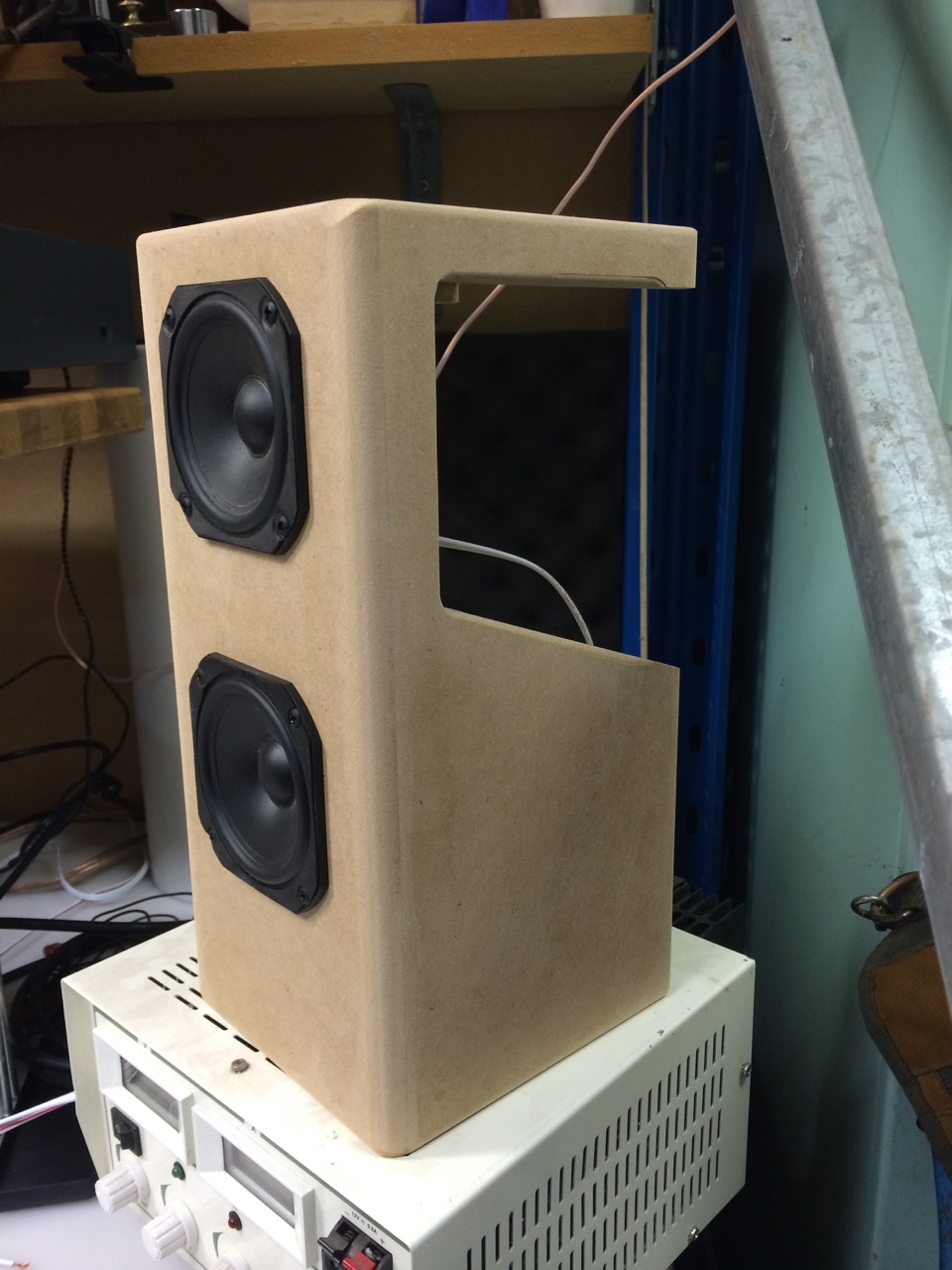

Hi Jake,
Here's what I just built, based on dimensions suggested in this thread. 2 x TC9FD-18-08, 9mm (3/8") MDF, the port is from 1" PVC pipe 2" long. I made them without the rear top panel supports so that I could make the cut-outs on the table and band saw, but I plan to add timber rails in later, I think these are needed to support the top panel adequately.
I built 2, and have listened to them for a few days now in all configurations of with/without sub, with/without crossover, with/without DSP EQ, on stands in my main listening area, and on my workbench.
In my opinion they are an intriguing design, and in some configurations have really jumped out as something special, although I've struggled to set them up when I'm happy with the whole package. So far I can get good imaging, or good flat response, or good integration with the sub, but not all at once. I have more to try, but at the moment I'm left feeling that this is not the best way to use 4 x TC9s and a subwoofer.
Dimensions:
Baffle is 5.5" x 12"
Lower enclosure is 4.75" wide, 5 1/8" deep, 5" high at the back, about 6 3/4" high at the front.
The top of the enclosure is at exactly 20 degrees.
Port is 1" ID x 2" long.
Lower driver is at 4 5/8" from the base of the baffle.
Upper driver is at 9 5/8" from the base of the baffle.
I feel that I need to stress that my comments above and measurements are of the geometry and material that I've used, and should not be extended to any other version.
I'll post measurements shortly.
Graham.

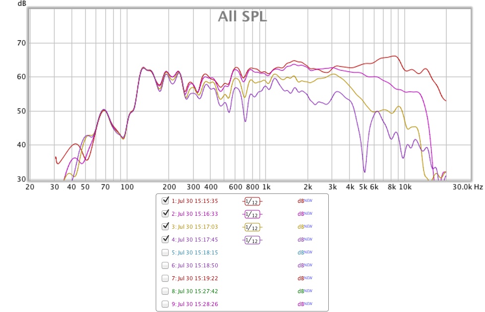

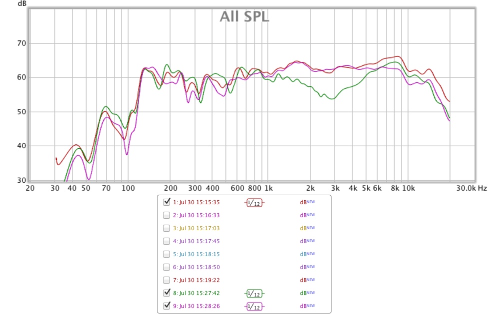

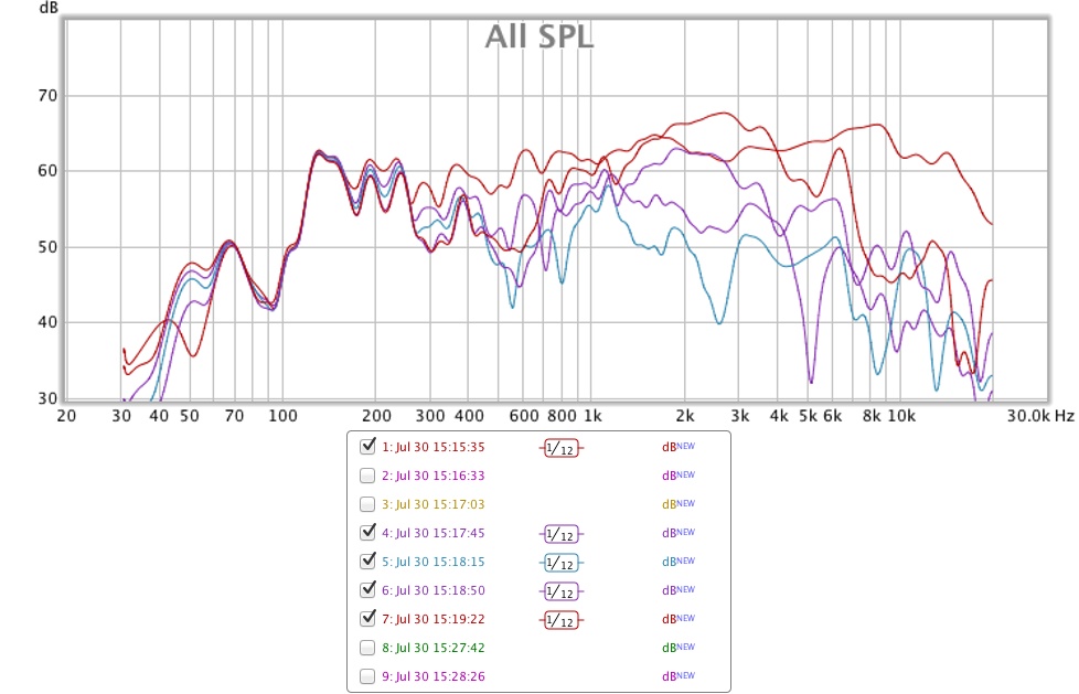

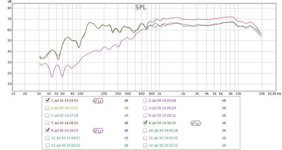

Here's some plots from measurements I've taken. The measurements were done with REW, at 1m distance, on the axis mid way between both drivers, 10ms left window, 100ms right window, 1/12 octave smoothing, and a frequency dependent window of 15 cycles (not sure if that overrides the gating I'd entered). For these baseline measurements I used a 25 uF capacitor in series with the top driver - this seems to be the consensus for the crossover. The subwoofer was not on for these measurements.
The first plot is for the drivers on their own (cap in series for the upper driver), then both together in parallel. Pretty much what you'd expect.
Thank you Sir. Great info. I appreciate you taking the time to post these measurements and explain your build. Was there a reason behind the selection of a 25 uf capacitor? I know 20 uf was selected by others here.
Jake
Jake,
I'm not sure why I wrote 25uF, it was indeed 20uF - I just checked the actual crossover components that I used.
Graham.
