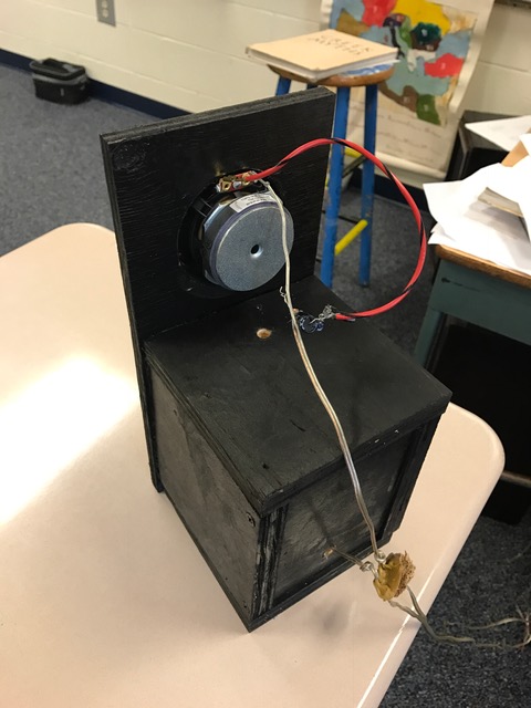

Well Guys here it is... The first prototype of the brio clone. Imaging is unreal, though I have never really had monitors/book shelve type speakers and I hear they tend to struggle less with good image. They come across as a bit bright and I wonder if it was my choice of cheap cap. Low end is almost non existent, though i didn't expect much. Good with jazz, vocals, acoustic but struggle with hard hitting low end and tend to distort a bit. I am making a second pair now out of MDF and will try a better cap to see if that solves the brightness and provide better tonal balance. Thanks again to one and all who gave advice and laughed at my pain!!!!!

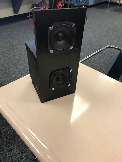

Here are my very rough prototypes. I have been running them for a couple of days. They sound great so far. I didn't have a 20uf capacitor so I put two together that add up to 18uf.
Also, the box isn't ported yet. I do have a couple of 1" ports that I removed from some old junk speakers I had sitting around. I am going to add those in this afternoon.
I also need to figure out some bass for them. I may try to use one of my 15" Eminence Alpha in an h-frame with them.
oh...one of the screws is painted black. It looks like I only have three in one of them.

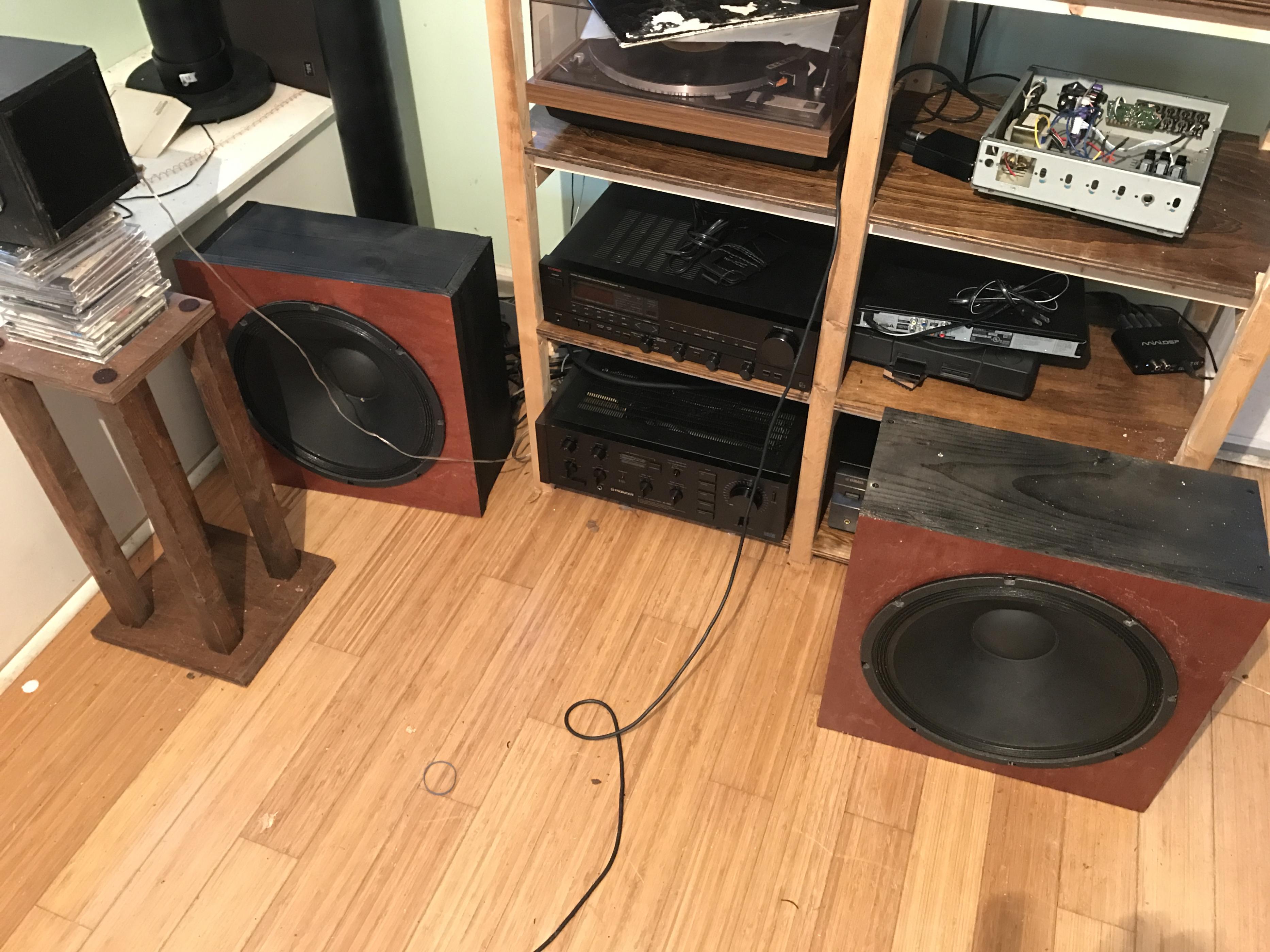

I spent a fair amount of time yesterday listening and these sound spectacular. I am using two Eminence Alpha A 15" drivers in u-frames for the bass. I am crossing over from those at 200hz. I will post pictures when possible.

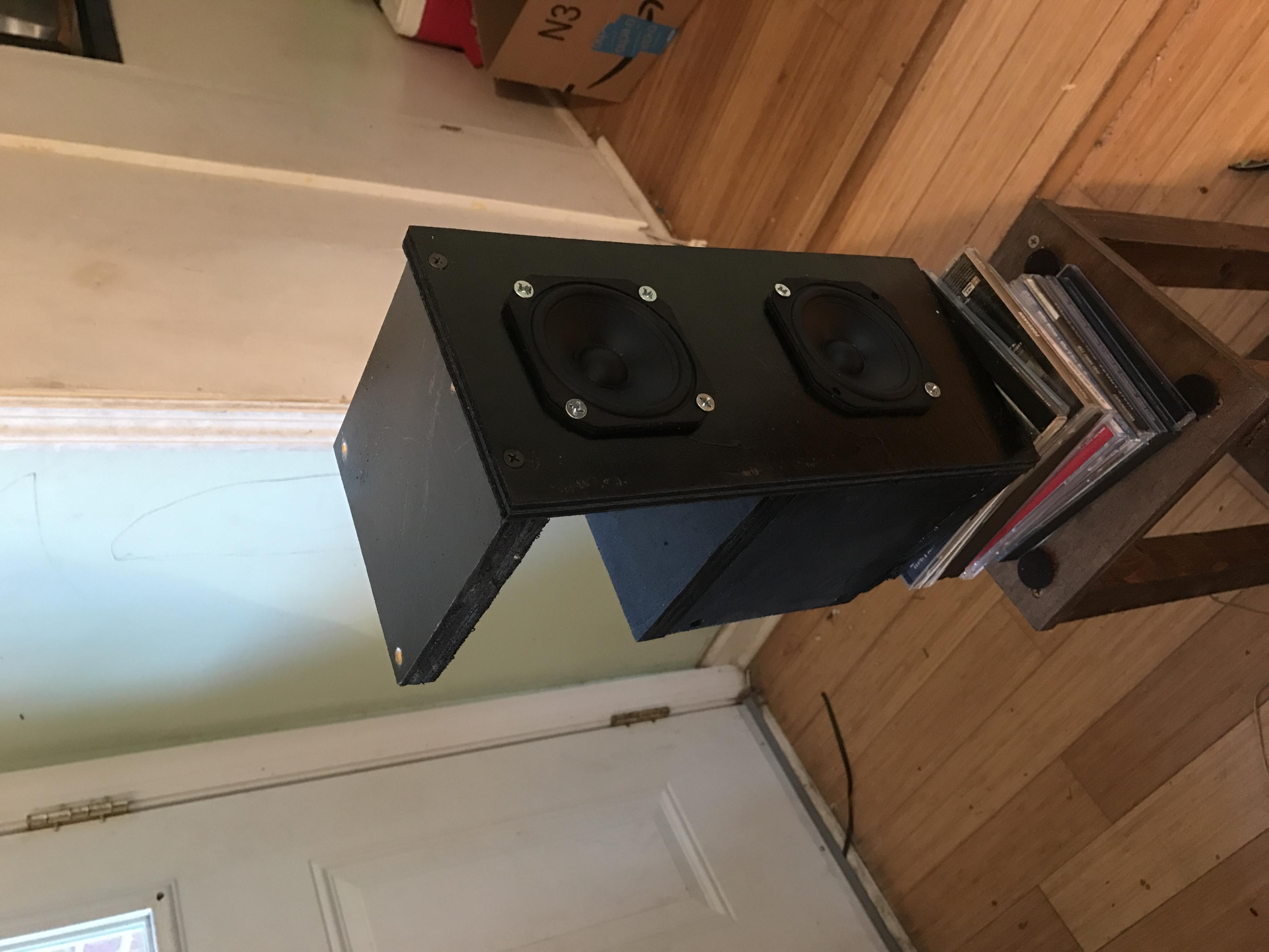

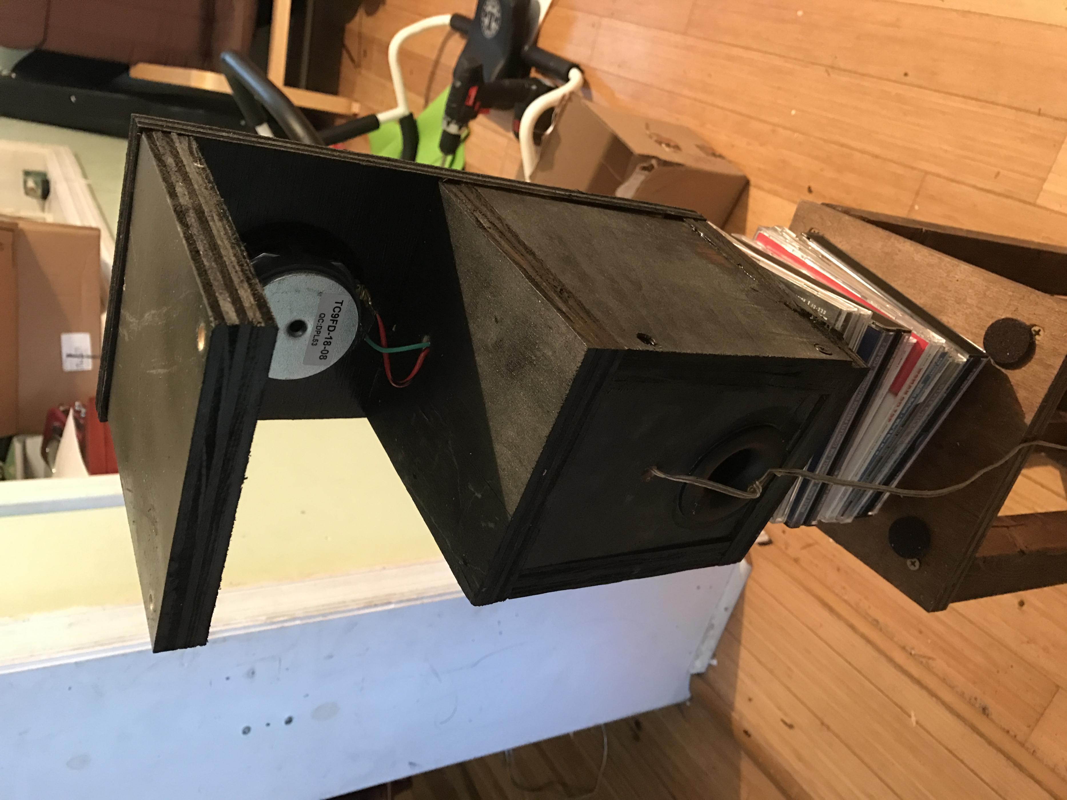

So...here is the state of my experiment. I have put the capacitor inside the cabinet to make it look more polished. I also added the top because the original has a top. I am sure that it extends the baffle as well.
The dual 15" that you see are open in the back. I have a few inductors that I am using to move the crossover from 150 to 200. I am going to listen to a frequency sweep today to see how they sound up and down the spectrum.
At the moment, they sound great! The soundstage is wide and has depth. You can pinpoint instruments and vocals as well. I am really digging them. I can't believe that there aren't more people working on these.
